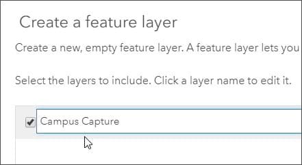

Create a feature layer
To capture the desired QuickCapture data, a feature layer is used. A feature layer can be created in many ways; one way is to use ArcGIS Pro, but for this simple example we can do everything using ArcGIS Online.
Feature layers can be created from a template, from an existing layer, from a URL pointing to an existing service, or from scratch. For this example, the feature layer will be created from scratch.
To create the feature layer, follow these steps.
Step 1: If you have not done so already, sign in to your ArcGIS Online organizational account. You must have sufficient privileges to create hosted feature layers.
Step 2: In the Content tab, click Create, then choose Feature Layer.
Step 3: In the From Template tab, choose Build a layer, then select Points.
Step 4: Click Create.
Step 5: Edit the name of the feature layer. Click Next when finished.

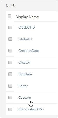

Step 4: Select the newly added field by clicking the field name.

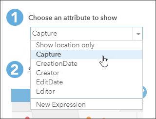

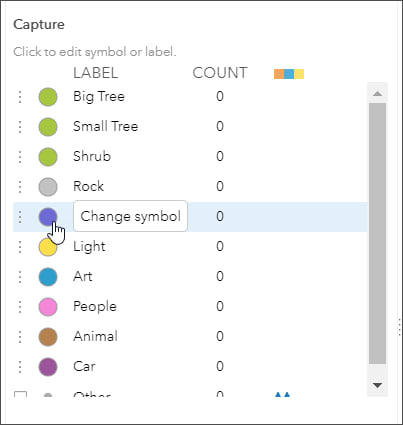

Step 7: Symbolize the values.
Rather than display all the values as one color, they can be displayed uniquely. Open the Visualization tab.

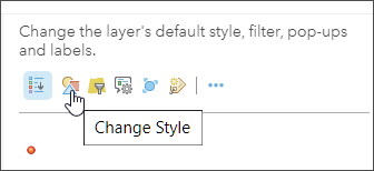

Step 8: Click the Change Style button to edit the layer style.

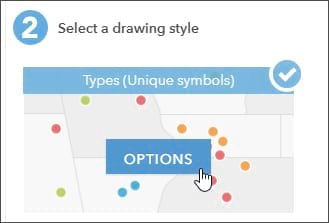

Step 9: From the dropdown, select the attribute you want to symbolize on, in this case Capture.
Step 10: Change the symbols by clicking Options.
Step 11: Edit the symbols as desired.
When finished, click OK, then click Done.

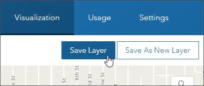

Step 12: Click Save Layer to save all of the changes you have made.

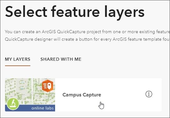

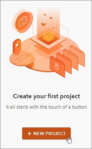

Step 2: Click New Project.
Step 3: Choose the feature layer created in the sections above. In this example, the layer is titled Campus Capture.
Then click Next.
Step 4: Confirm the project information, make any desired edits, then click Create.

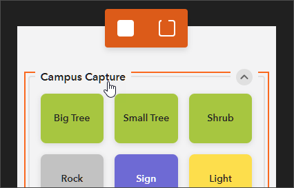

Step 1: Click the group label (Campus Capture) to apply changes to the entire button group. When selected, the group will be outlined in orange.
Step 2: In the group properties, set the number of columns to 2.

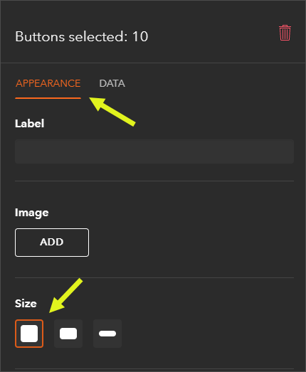

Step 3: Press the <shift> key and click to select all of the buttons. Selected buttons will be outlined in orange.
Step 4: With all buttons selected, open the Appearance tab and choose the large button size.

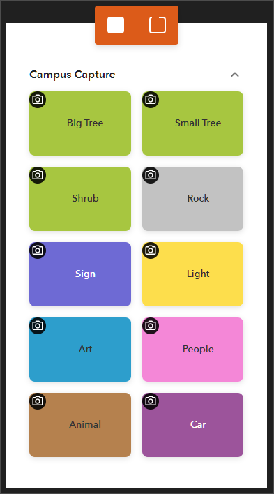

Step 5: With all buttons selected, open the Data tab and enable photos.
The project should look like this:

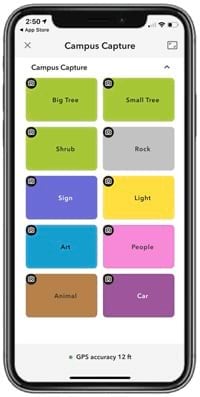

Next, the project you just designed will be opened and used on a mobile device. The device pictured below is an iPhone X.
Step 1: Install the QuickCapture mobile app from the Apple or Google Play app store onto your device.
Step 2: Open the QuickCapture mobile app and sign in. Alternatively, you can open the link or QR code (from Step 6 above) to present the sign in page immediately.
Step 3: If prompted, choose to allow QuickCapture to access your location. This enables your device’s location to be captured in the feature layer.
Step 4: Open the project.
Tap Get Projects to view available projects. The project created above will be displayed (along with any others that are available).
Step 5: Download the Campus Capture project.
Step 6: Open the project.
After you download the project, click the project icon to open it.
When collecting data, click the appropriate button to capture a feature. The camera will open, enabling you to capture a photo. When you finish, the location and photo will be stored in the feature layer, along with the date and account name of the QuickCapture user.

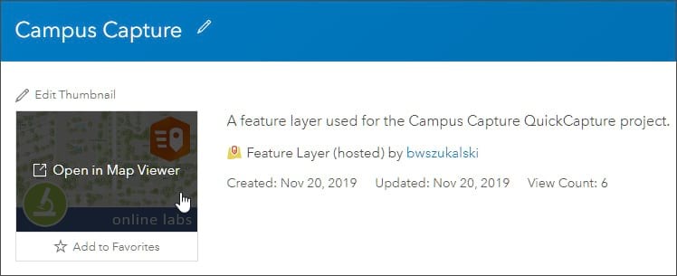

View the QuickCapture results

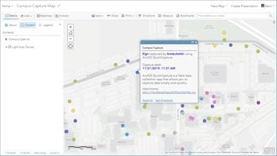

To view the QuickCapture data, find the feature layer item in your contents and click the thumbnail to Open in Map Viewer.
You can also open the QuickCapture designer, hover over the project, and click View Results.
Besides viewing your results in QuickCapture Designer, you can also open your feature layers in a web map.
For example, open the Campus Capture map made using the Campus Capture project detailed in this tip.

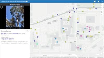

Click on a feature and note the attachments. You can use the Attachment Viewer configurable app template to view photos and videos stored as feature attachments, making the app well-suited for use with maps made using QuickCapture. See Browse attachments using Attachment Viewer for more information.
Open the Attachment Viewer configurable app template with the Campus Capture map.
