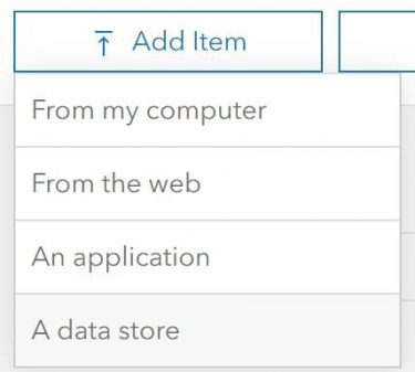

Start by adding a data store item to your portal, similar to how you could directly add a shapefile, CSV, or other item. Once you add the data store, and proceed through the wizard, you will have registered your data store with ArcGIS Server so that you can publish services that reference your original data in place.
User interface for uploading a data store item
Hold on…add a data store to my portal? That’s right. Publishing layers in bulk requires that you first register your database through your ArcGIS Enterprise portal. This is a new option, beginning at 10.7.1. Your data store item is treated like any portal item, with the ability to share and update it.

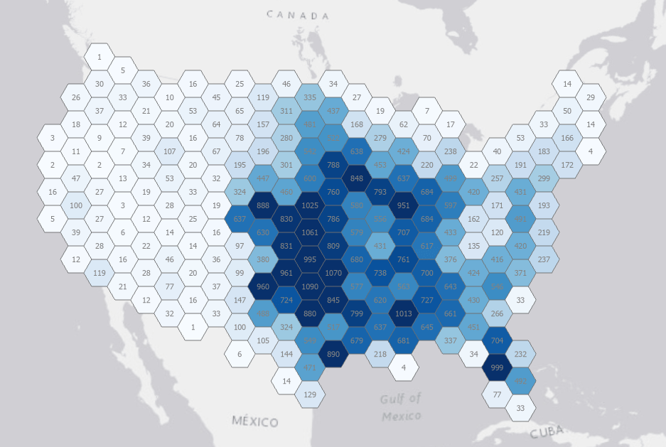

Do you have a large map service with tons of points, making it difficult to understand your data and discern patterns without analysis and querying? New at ArcGIS Pro 2.4 and ArcGIS Enterprise 10.7.1 is the ability to dynamically aggregate your data on the fly.
This functionally, also called feature binning, optimizes drawing performance and dynamically adjusts your aggregation as you pan and zoom. It’s an effective way to understand and interact with your large datasets!
Bins created from aggregation

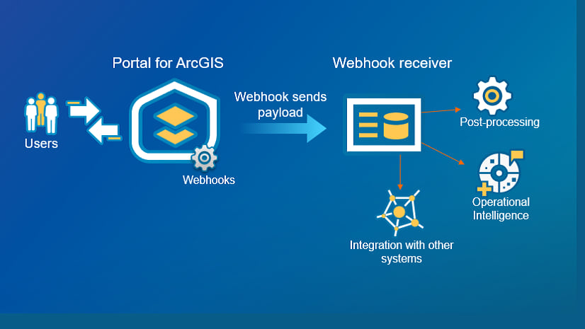

Webhooks were introduced at 10.7, and in this release we have added the ability to trigger a webhook whenever users log in and out of your ArcGIS Enterprise portal.
This is helpful automation for administrators who want to monitor traffic to their portal and understand adoption and usage patterns.

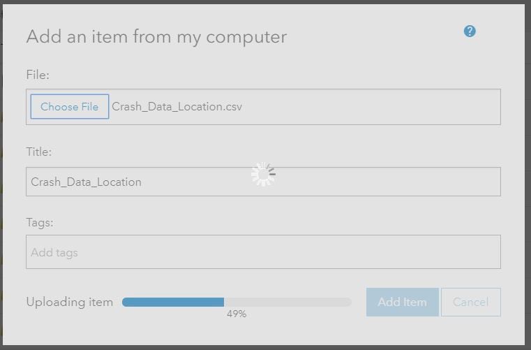

You can upload many different types of items directly to your ArcGIS Enterprise portal. At 10.7.1, we’ve increased the size limit of what you can upload to 200 GB (up from 1 GB).
When uploading items, you can also see the progress of your upload via a status bar. This is especially helpful when uploading those larger datasets.
User interface for adding an item and tracking upload progress

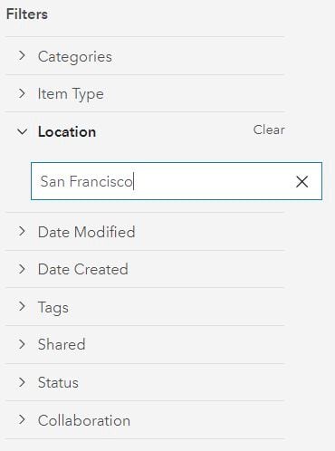

This enhancement follows a 10.7.1 trend of making your data and information easily searchable and discoverable. At this release, your users can now search items by an extent in your Enterprise portal. This requires that an extent is set on the item.
It makes for a nice search experience using our favorite thing – location! Here is an example of the filter pane, where I could search all items that cover San Francisco:
User interface to search by location
