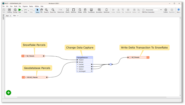

Some integration scenarios require an advanced extract, transform, and load (ETL) solution. Organizations may need to synchronize information between business systems, convert data between specialized formats, support bidirectional workflows, or implement sophisticated transformation logic. For these requirements, ArcGIS offers ArcGIS Data Interoperability.
Built on Safe Software’s FME technology, ArcGIS Data Interoperability extends ArcGIS Pro with hundreds of readers, writers, transformers, and integration tools. Using a visual authoring experience, users can create reusable ETL workflows that connect Snowflake with databases, cloud platforms, APIs, GIS systems, and enterprise applications. These workflows can extract, transform, validate, and load information while supporting complex business rules and data exchange requirements.
A common use case is maintaining synchronized information across systems. For example, an organization may maintain authoritative parcel information in an enterprise geodatabase in SQL Server while also using Snowflake for reporting, analytics, and enterprise data science initiatives. An ArcGIS Data Interoperability workflow can identify changes made to parcels and update only the modified records in Snowflake, reducing unnecessary processing while keeping systems aligned. This flexibility makes Data Interoperability a powerful option when integration requirements extend beyond the capabilities of standard data preparation workflows.
Spatial ETL tool created in ArcGIS Data Interoperability Workbench synchronizes parcel data between an enterprise geodatabase and Snowflake by identifying changes and updating only modified records.
To automate the execution of spatial ETL tools created using ArcGIS Data Interoperability, you can schedule the tool from ArcGIS Pro. Beginning with ArcGIS Enterprise 11.4, web tools can also be scheduled directly through ArcGIS Enterprise, allowing ETL processes to run automatically on the server. Alternatively, web tools can be shared to ArcGIS Enterprise 11.x or later and scheduled programmatically using the Enterprise Sharing API.
