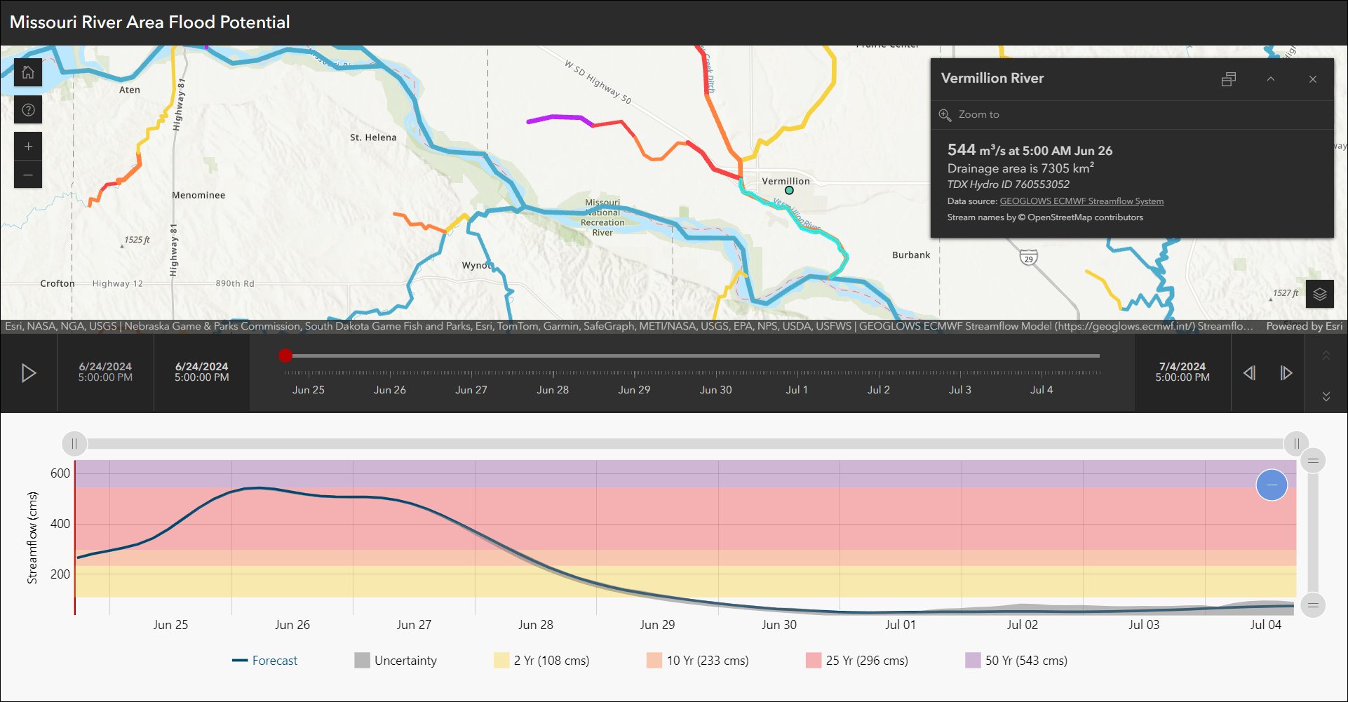

Introducing: Streamflow Viewer (Beta)
Interact with streamflow forecast data through a chart and time slider using the new Streamflow Viewer (Beta) template. This app includes a multi-day river forecast service from the European Centre for Medium-range Weather Forecasting (ECMWF) that displays data in 3-hour time intervals. App creators can generate apps that help alert users about potential flood risks with a chart to compare historical data to currently forecasted streamflow data. The Global Water Model service is updated once daily and is automatically added to your app when you choose a map or scene in the app configuration. The chart and time slider are both interactive and can be used to further explore the streamflow data in your area.
For all details with creating and configuring an app using Streamflow Viewer (Beta), check out our Introducing Streamflow Viewer (Beta) blog.

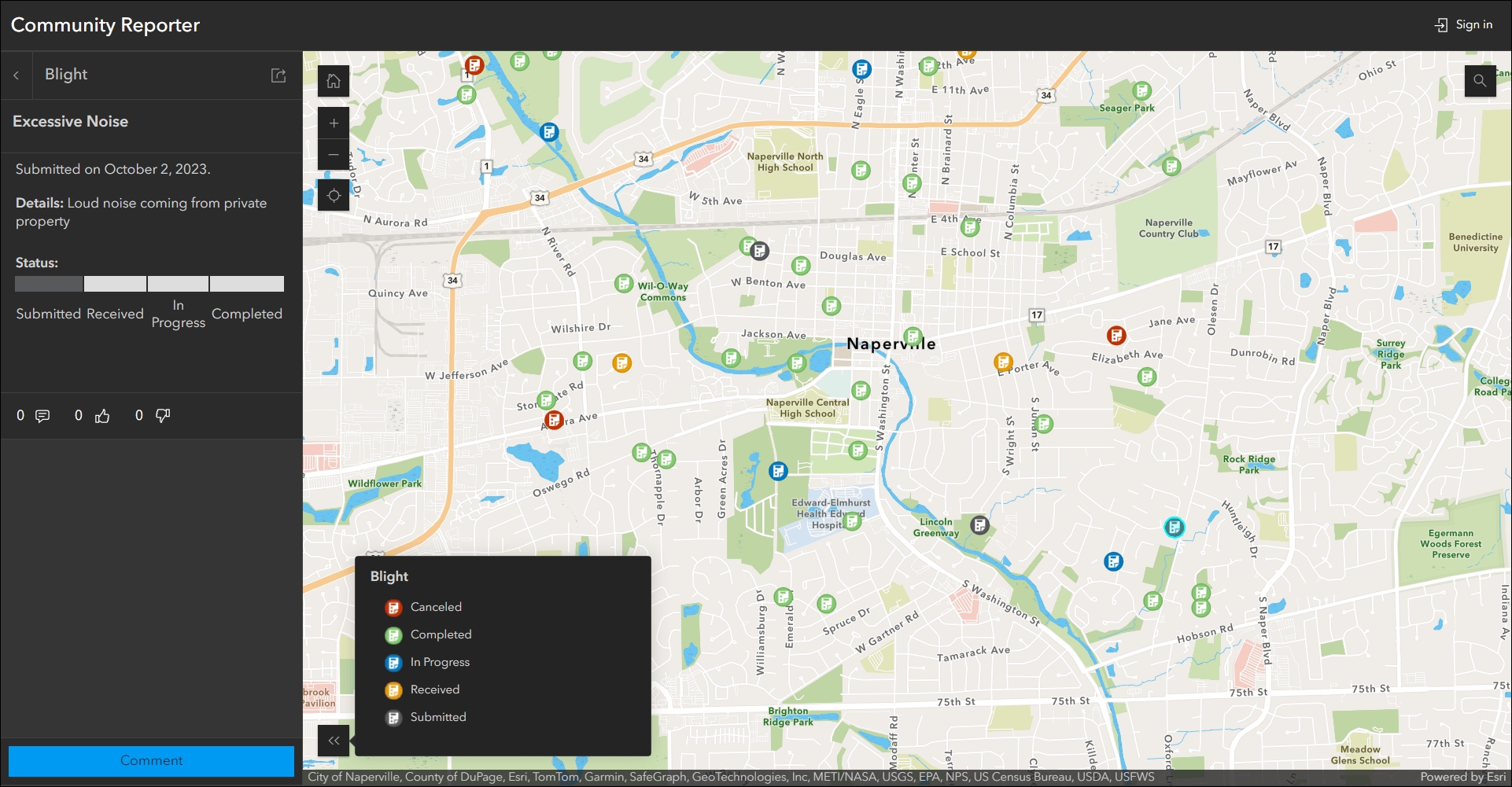

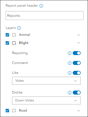

View and submit issues or observations in an area using the new Reporter app template. This new app lets users create a report that displays on the map. They can also view existing reports and use basic map exploration tools to navigate the map. New at this release is the ability to sign in to the app and provide comments and submit votes. To create an app that supports commenting, a related table record is required. Voting requires that you choose a numeric field to store the values. Set up commenting and voting on the Reporter tab of the app configuration on a layer by layer basis.
For a full introduction and more details about creating and configuring an app using Reporter, check out our ArcGIS Instant Apps: Introducing Reporter blog.
Reporter was previously released as a beta app in February of 2024. All apps created in the beta phase (Feb 2024 – June 26, 2024) must be republished to fix a breaking change. For more information, visit this KB article.

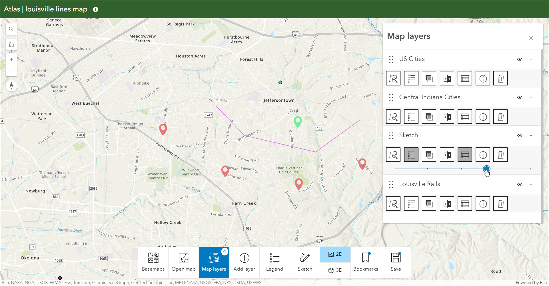

Now when you create sketches you can access and modify them in the Map layers panel. When you create a sketch it will appear as a layer in the Map layers panel and include helpful options such as swipe, layer transparency, and more.

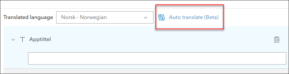

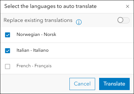

With this update we are happy to offer machine translation directly in the configuration. Now you can automatically translate your text with a few clicks. This feature is currently in beta, and is not intended to replace human translators. Use the Auto translate (Beta) button in the header while configuring your translations to begin the process. Choose to auto translate text for one or multiple languages at once. Click Translate and let the machine translator handle the rest within a few moments.
For more details about Auto translate (Beta) and using it to include machine translations in your apps, please check out our Instant Apps Language Switcher now includes Auto Translate blog on Esri Community.

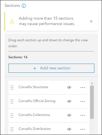

Use Portfolio to showcase different types of content all in one place by curating multiple resources related to a specific topic. We have updated the app to have no limit to the number of sections you can add. When you add new sections in the configuration, it lets you know how many you currently have created and does not display the previous restriction of 20 sections. Note that with adding a lot of sections, especially if they contain performance impacting content, the overall performance of the app and the sections could be affected. When you add a 15th section to the app a message in the configuration will appear that notifies you of this possibility.

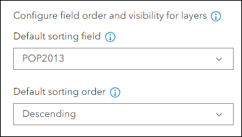

This release we have added the ability to set a sort order on a specific field in the table so that the app displays the records in the table using this order by default. Use the app configuration to set the Default sorting field and Default sorting order options on the Interactivity > Table options tab. First pick a map and then click the Field editor button to the right of any layer to access these two settings. The configuration lets you set this for each layer within each map in the app.

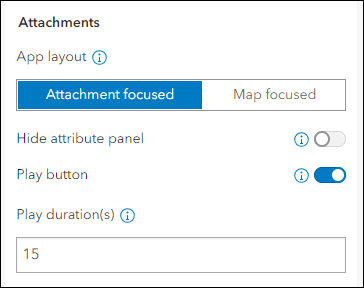

Display photos, videos, and PDF files stored as attachments alongside your map using the Attachment Viewer app template. App users can now auto-play through feature attachments in the app at a given speed. Use the app configuration to enable the Play button setting then supply a Play duration in seconds. This adds a Play button to the header over the map that can be clicked by the app user to begin the auto-play. Note that this new feature is only available for Attachment focused layouts. This is not available for apps configured using the Map focused layout.

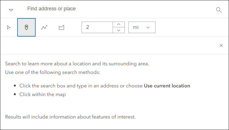

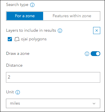

Discover locations within a zone or region to provide information using Zone Lookup. This app is great for identifying school districts, store regions, emergency evacuation zones, and more based on current location or a location provided by the app user. New at this release is the ability to create a search zone by drawing a point, line, or polygon on the map. A buffer distance can then be used around the drawn sketch to find features in the map. In the app configuration, enable the “Draw a zone” setting on the Zone Lookup > Options tab. Then supply a default search distance and units for the buffer. In the app, the user can choose between point, line, or polygon to draw a sketch on the map and also change the distance or units as they explore.

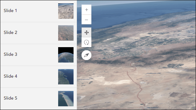

Present a 3D scene with a variety of exploration tools using 3D Viewer. We’ve added a new URL parameter that let’s you open a 3D Viewer app directly to a specific slide from the web scene. The parameter is “slide” and uses a numeric index (starts at 0) to use a specific slide. For example, to have your app open up to the 3rd slide just append “&slide=2” to the URL. Note that the Display preset slides setting in the app configuration must be enabled to use the URL parameter, which can be found on the Interactivity > Explore/navigate tab.

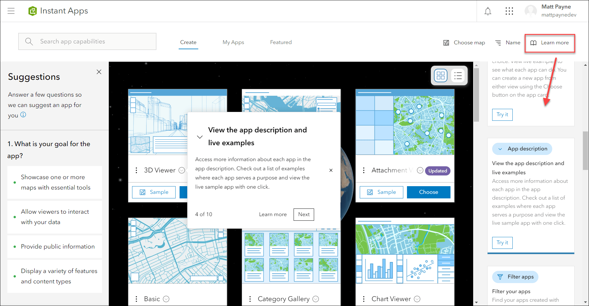

The Instant Apps home page offers a centralized place to browse, choose, create, and manage ArcGIS Instant Apps. This release we have added new onboarding messages and tips that help provide guidance and resources for using and navigating the page. A pop-up displays on the screen calling out a specific feature and offers the ability to click through to the next message or close out. All messages and information are contained within the Learn more panel accessed on the far right side of the header. Within the panel, click Try it for any tip to open it’s respective pop-up on the page.
The new Recycle bin feature is available in the Instant Apps home page. On the My Apps tab, the Delete button will show as a Recycle bin icon if your organization has this feature enabled. You can choose to send an existing app to the Recycle bin for up to 14 days or permanently delete it.

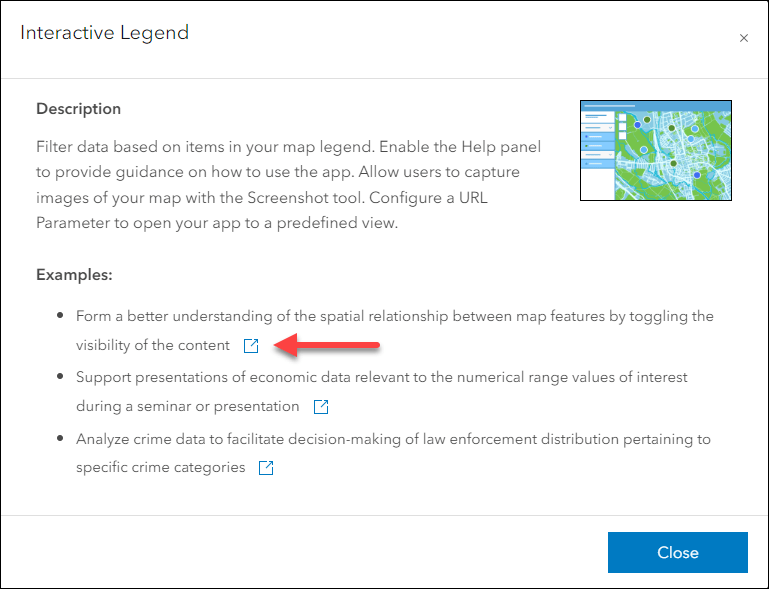

We have added more live example apps to the templates on the Create tab. In Gallery view, click the down arrow icon next to any template name to view its App description and see the examples. In Details view, the app description and examples are already shown by default in this view and the new live app hyperlinks for each template are as well.
