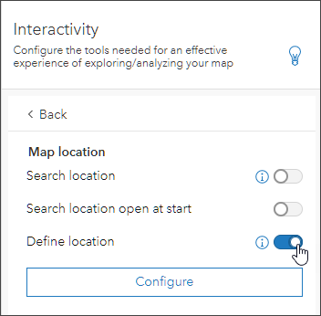

Configure the app
Media Map includes a swipe tool that can be configured when in full setup mode. Open the Interactivity section, then click Modify. Toggle the Swipe tool on and select the leading and trailing layers. You can also configure the swipe direction and position.

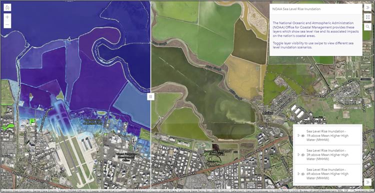

		This second Media Map swipe example shows NOAA sea level rise and adds configuration options to toggle layer visibility across multiple layers, each showing different sea level rise inundation areas. It also adds an information panel, fullscreen button, and bookmarks.

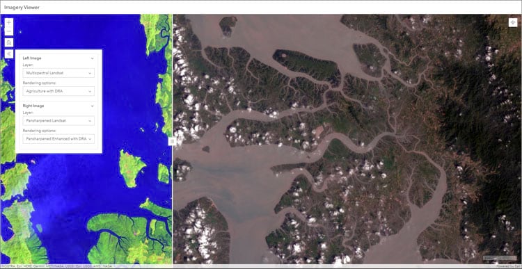

Imagery Viewer
Imagery Viewer is an ArcGIS Instant App that supports both express and full setup modes. It allows users to visualize, explore, and interpret imagery through time and space. It includes tools for navigating through time, recording locations, measurement, and more. When using maps with two or more imagery layers, Imagery Viewer can be configured with a swipe tool that enables users to compare the layers.
Configure the app

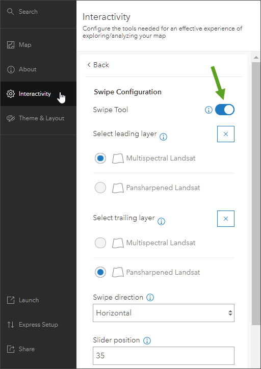

In express setup mode, go to the Interactivity section. Toggle the Swipe Tool on and select the leading and trailing layers. You can also configure the swipe direction and position when in full setup mode, shown below.
		Use the app
Open the Imagery Viewer app shown below, then click and hold the swipe slider to move it. Open the Imagery Viewer settings to choose different rendering options.
		The bookmarks tool has also been enabled and is located in the upper right of the app.

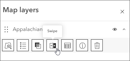

Atlas includes a built-in swipe tool that can be applied to any layer in the map. No additional configuration is necessary.
Use the app
Open the Appalachian Karst Atlas shown below. The app has been configured with a single map and the Map layers pane will automatically open.
		Click the Swipe tool, then drag the swipe handle. Click the Swipe tool again to dismiss it. Bookmarks are also included for navigation. View the example map used in the app.

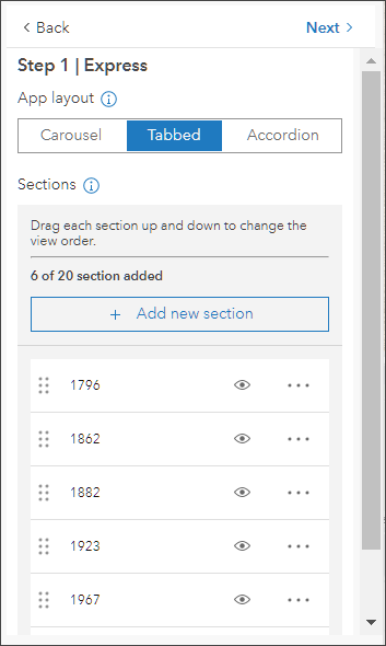

In the General tab, select the layout that you want, then add new sections containing the maps you want to display.
		Portfolio will open each map at its saved extent, however in full setup mode you can define the location to be used across all maps.

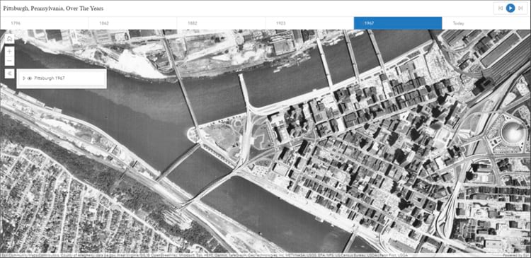

Open the Pittsburgh Portfolio app shown below. A cover page has been configured to introduce the topic. Scroll down from the cover page then click the tabs across the top to view change over time.
The app has been configured so that all maps open at the same location and it includes advance and play buttons in the upper right. A layer tool has also been added so you can view the basemap beneath the imagery.

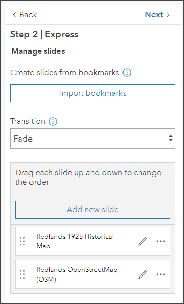

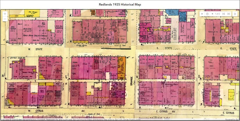

In express setup mode, new slides were added that toggle the layer visibility between the historical map and underlying basemap. Slide notes were omitted but could have been used to provide details about the maps shown.
		Use the app
Open the Redlands 1925 Exhibit app shown below, then click to advance slides using the tools in the upper right. An information panel has been configured to clarify how the app is used.
		Note that the slide titles are unique and have been centered, helping the user understand the maps that are shown.

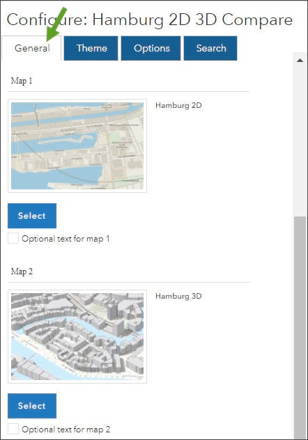

Configure the app
In the General tab, select the maps or scenes you want to compare.

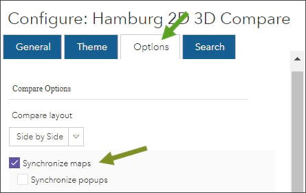

		Open the Options tab to synchronize the maps. You can also change the layout from Side by Side to Stacked, add an expand button, include a basemap toggle, and more.
		Use the app

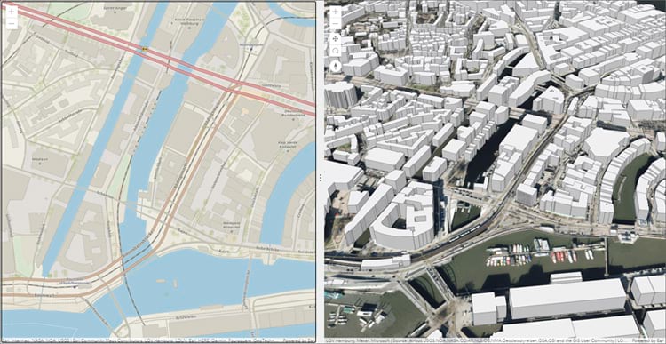

Open the Hamburg 2D/3D Compare configurable app shown below, which uses both a 2D map and 3D scene. Pan, zoom, or tilt to compare the two, or click and hold the comparison slider to change your map focus.
		View the sample 2D map and sample 3D scene used in the application. For more information, view the Compare app item overview.

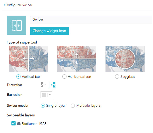

Web AppBuilder includes a swipe widget that can be found in the widget library. Start by choosing a theme, style, and layout. Then add the swipe widget from the widget gallery.
		Once added to a toolbar, click the dot in the lower left to automatically enable the widget when the app is opened, then click the pencil to open the configuration panel.
		The widget can be configured in a variety of ways. You can choose vertical, horizontal, or spyglass swipe mode, and can set the direction, color, and which layer in your map to swipe. Below is shown the configuration used in the sample app.

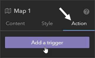

		Comparison using triggers and actions
Build the experience
To link two or more maps or scenes, use triggers and actions. Widget actions are in response to linked trigger actions in other widgets. Select a widget and open the Action tab to add a trigger, then specify the target and action. To sync two maps or scenes, apply the trigger and action in reverse. See Add action triggers to widgets for more information.

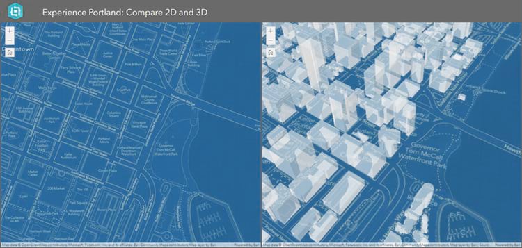

In the Portland 2D/3D experience below, a 2D map and 3D Scene have been synced using triggers and actions. Pan, zoom, or tilt to compare the two.
		View the 2d map and 3d scene used in the experience. For more information, see Get started with ArcGIS Experience Builder: sync 2D and 3D maps.

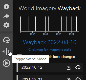

Open the Wayback app, zoom to an area of interest, and enable the swipe tool. Available layers will be shown on the left and right. Turn on the desired layers by clicking them in the left and right columns, then use the swipe tool to compare.

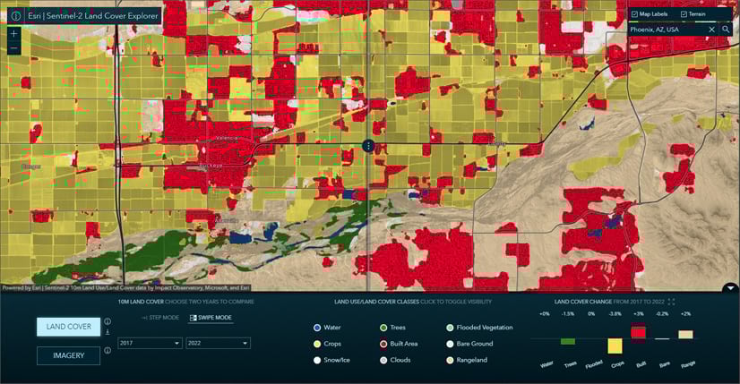

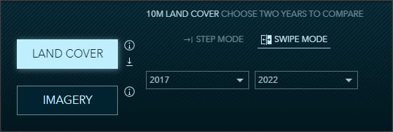

Open the Land Cover Explorer, zoom to an area of interest, and choose either Land Cover or Imagery.
		Use step or swipe mode
Enable the step or swipe tool to begin exploring.
		When Land Cover is chosen, you can view the legend and click to highlight specific land use and land cover classifications.
		A graph shows the selected year land cover totals in step mode, or the land cover change between the selected years in swipe mode.
		When Imagery is chosen, you can choose different renderings to highlight characteristics of the multispectral image.
		As before, a graph shows the selected year land cover totals in step mode, or the land cover change between the selected years in swipe mode.
Copy the URL that you see at the top of the app when you are finished setting things up. This allows you to share your animations and comparisons with others. Here’s some examples:

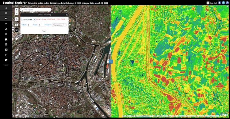

Sentinel Explorer

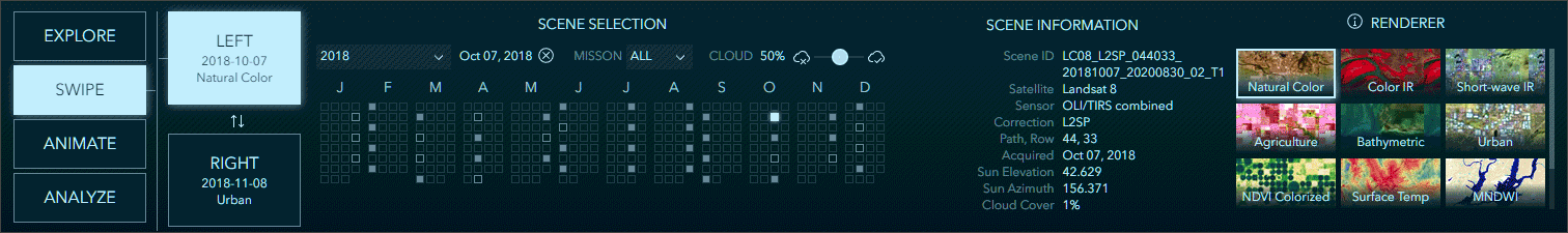

Using Sentinel Explorer, you can apply a variety of tools against Sentinel-2 imagery, accessed directly from the Sentinel-2 collection on Amazon Web Services (AWS) and updated daily. Sentinel-2, 10, 20, and 60m multispectral, multitemporal, 13-band imagery is rendered on-the-fly and available for visualization and analytics via the app.
Use Sentinel Explorer swipe
Sentinel Explorer includes a swipe tool which can be used to compare Sentinel imagery against the basemap, or imagery from different dates and different renderers. Open Sentinel Explorer and sign in to your account.

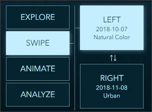

To use the swipe, navigate to your area of interest and render the imagery as desired. Then follow these steps:
Step 1 — Open the time selector to choose a date and add the layer to the swipe by clicking Set current as secondary layer. The secondary layer will appear on the left when you open the swipe tool with the current renderer.
		Step 2 — Move the time selector to a different date. You can also change the renderer.
Step 3 — Dismiss the time selector and click the swipe tool to interactively compare the two dates of imagery. The chosen dates appear at the top of the application.

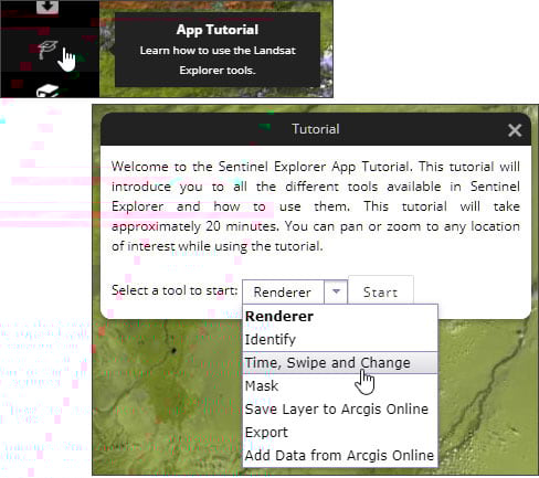

Tip: Click the App Tutorial tool and select Time, Swipe, and Change from the dropdown list to review the steps above and learn more.

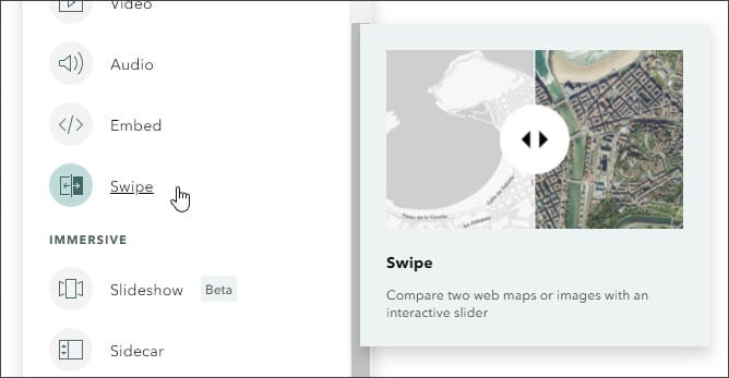

Using StoryMaps swipe
Swipe is one of the blocks that you can add to any story that lets you compare two maps, or two images.
		After you add the swipe block, choose Map.
		You can choose different maps for the left and right side of the swipe, or can choose the same map and toggle layer visibility on the left and right side to compare layers.

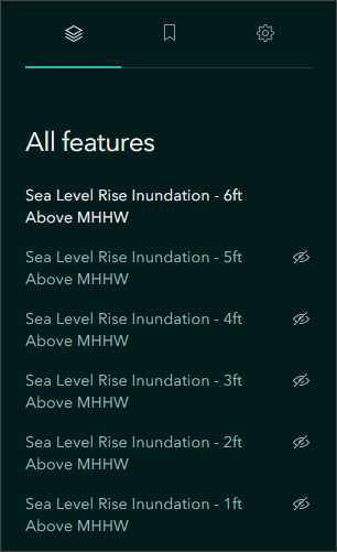

The sample story below uses a swipe block to compare 1-foot and 6-foot sea level rise scenarios. The same map is used on either side of the swipe, but layer visibility is toggled to show the 1-foot scenario on the left and the 6-foot scenario on the right.
