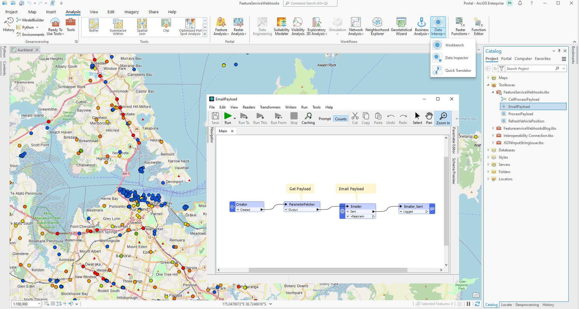

The above screen capture helps illustrate how Data Interoperability can be used with ArcGIS Pro. Here you can see Data Interoperability in use. Notice how functions of Data Interoperability show up in a few different places; the Analysis ribbon provides access to the Workbench, Data Inspector and Quick Translator apps (also available in the ArcGIS program group start menu), the project has custom Spatial ETL tools defined in project toolboxes, and ModelBuilder includes a Spatial ETL tool.
Some of the functions not shown here are the Quick Import and Quick Export system tools delivered through the Data Interoperability Tools system toolbox. These functions use default settings to translate between any tabular or vector format and file geodatabase in each direction, for easy and rapid data conversion.
