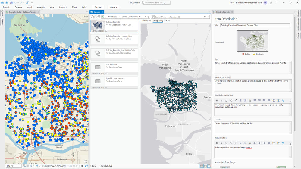

To start we imported data from Vancouver’s open data web site. The data was brought into an ArcGIS Pro project geodatabase by a spatial ETL tool (ImportBuildingPermits) that reads from Vancouver’s open data web site. The dots on the map are today’s permit locations in the feature class BuildingPermits.
Not only was the building permit data written to a feature class, but it also had metadata generated by an ETL process. In the screenshot below, we are viewing the metadata for the BuildingPermits feature class in ArcGIS Pro. Here we can see the item information (title, tags, summary, description, credits, use limitations).
Building permits metadata

It is important to take the time to embed metadata automation during the ETL time process. Doing this ensures that we don’t forget it later and is important because:
  • It ensures that essential information is documented for our data.
  • It helps consumers understand the context of our data and how it should be used in mapping and analysis.
  • It enhances search and discovery of our data- making it easier for people to find.

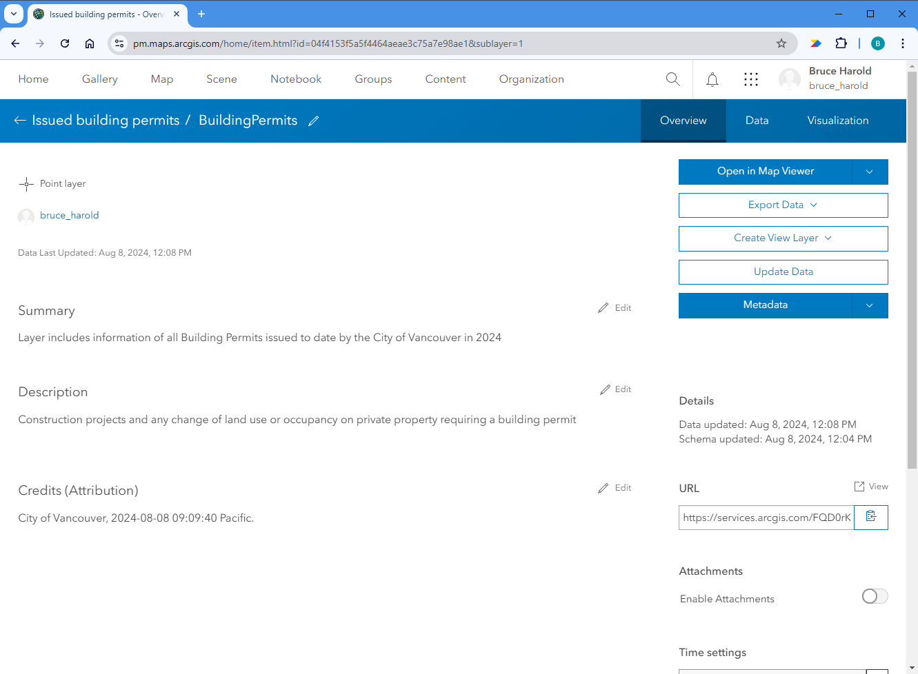

You’ll have noticed in the map and metadata screen grab above that we used the unique value renderer to display the data in categories (type of permitted work) and configured pop-ups. We then published the layer and related tables to ArcGIS Online – the target information product.
When our data is published, the metadata for each layer flows to the sublayers of the hosted feature layer.
Here it is in the BuildingPermits layer:
Sublayer metadata flows through
Because metadata is flowing from the data to the published sublayers of the hosted feature layer this saves us the trouble of recreating it. So that’s how to get metadata into your information product at ETL time and why it’s important to do so.
