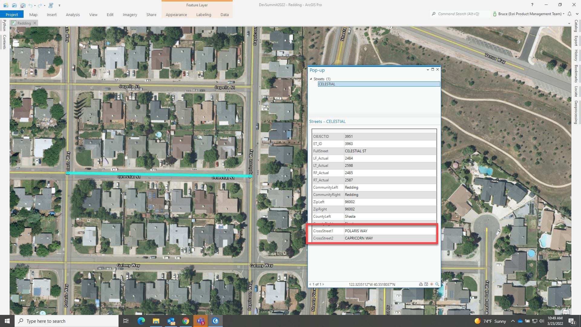

The process of building a street centerline locator returning cross-streets starts with a street centerline feature class. For example, here are some streets in Redding, California where we have derived cross-street fields for a feature class. The pop-up relates to the selected street segment, and we have highlighted the added cross-street fields:
Inspecting Cross-Streets Made by the Tool

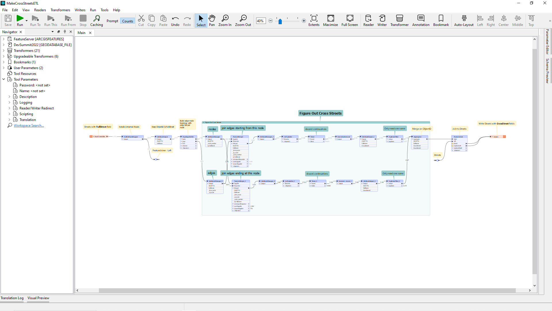

Rather than doing all sorts of math in Python to calculate data structures, we can utilize ArcGIS Data Interoperability to query cross-street information using a no-code approach. This works especially well with TopologyBuilder transformer. For seasoned veterans of ArcGIS, you may remember that arc-node topology was baked into the storage model for polyline and polygon features. That type of topology is no longer included in a geodatabase, nor is it easy to create, except when using ArcGIS Data Interoperability. With ArcGIS Data Interoperability we are able to do this in the ETL tool in the post download (requires Pro 3.3 and ArcGIS Data Interoperability extension):
Geocoding Locators
The ETL Tool that makes Cross-Streets
In the thumbnail we can write out a new feature class by:
  • Reading in street reference data
  • Sending the geometry
  • Including the ObjectID
  • Adding a street name attribute
We can then process that information to figure out cross-streets and join them back onto the street features. We don’t include the data but it is publicly available so you can test drive the tool for yourself after repairing paths.

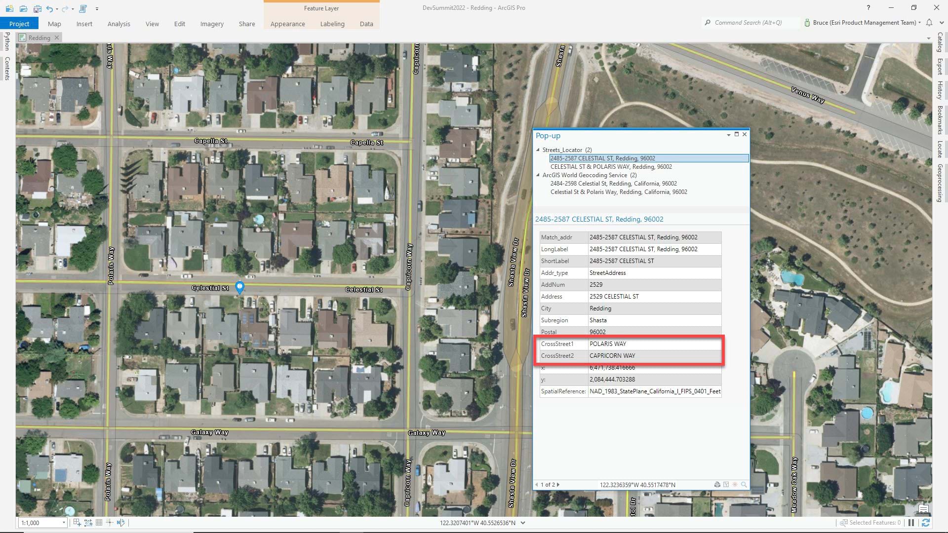

In the download toolbox there is also a model that creates a locator (also included) with custom output fields for cross streets, and here it is in action with a ‘What’s Here?’ query in a map.
You can get to the area by a geocode to 2500 CELESTIAL ST, Redding, 96002 with the supplied locator.
Geocoding Locators
Cross-streets returned by the Locator
In production, street centerlines would often be used as one primary table in a geocoding locator that also uses point address data and zone features. To access the cross-street values from a geocode service you might have to use a category filter of ‘Street Address’.
