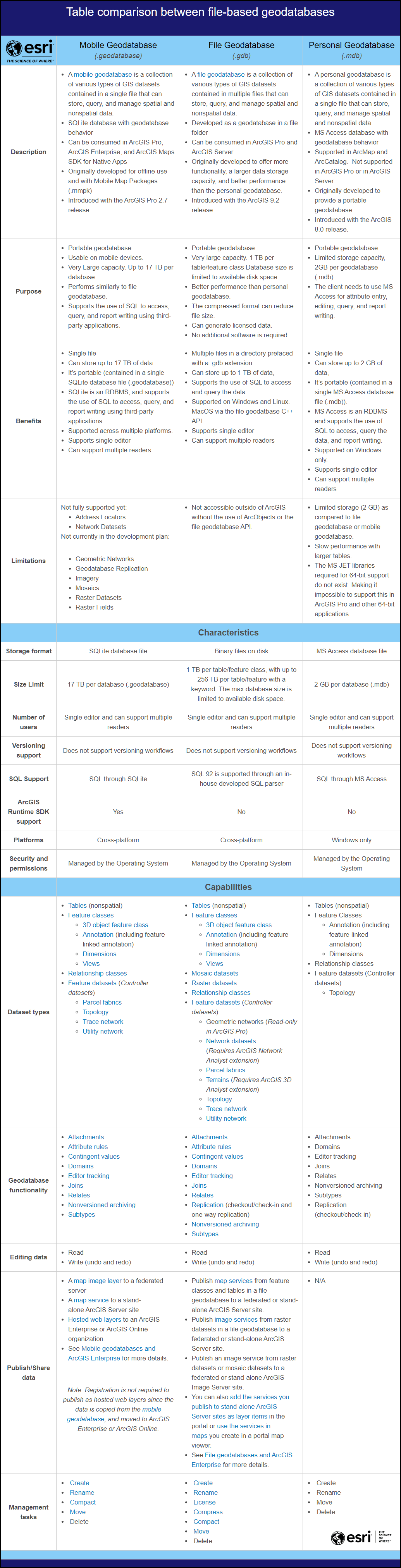

The following table compares the three “file-based” geodatabase storage types (i.e., mobile, file, and personal geodatabases) and excludes any information about Enterprise geodatabases.
Use one of the options below to view the content contained in this table comparison between file-based geodatabases:
- Table – All content within this table, including embedded links, is fully accessible.
Click this link to open a detailed table comparing file-based geodatabases.
Table comparison between file-based geodatabases |

- Image – A high-resolution image where the zoom tool can be used for better clarity. Please note that embedded links within this high-resolution image are not accessible.
Click this link or picture below to open a high-resolution image of the table.
Hopefully, having the information in this table comparison available at your fingertips will enable you to quickly find the details you need to make the best workflow decisions.

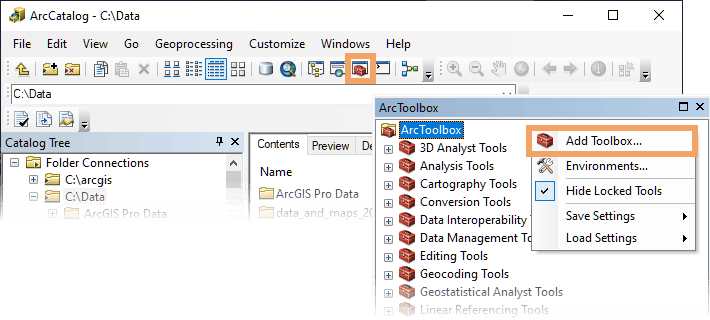

- To add a custom toolbox, open either ArcMap or ArcCatalog.
Note: This custom toolbox should be run in ArcGIS Desktop 10.x
- Click the ArcToolbox icon to open ArcToolbox.

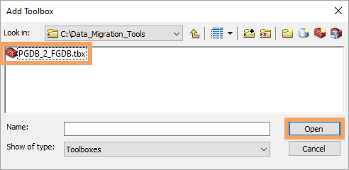

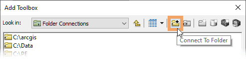

- From ArcToolbox, right-click in the white space and click Add Toolbox. The Add Toolbox dialog box opens.

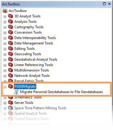

- Browse to the location where you stored the PGDB_2_FGDB.tbx and select Open.
- This new toolbox, PGDBMigrate, appears in the ArcToolbox list; expand the toolbox to see the Migrate Personal Geodatabases to File Geodatabases tool.
- Double-click the Migrate Personal Geodatabases to File Geodatabases tool to open.

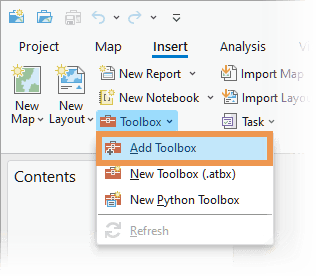

- To add a custom geoprocessing tool, open ArcGIS Pro.
- You can add a toolbox using one of the following options:
- From the Insert tab, click the drop-down next to Toolbox and click Add Toolbox.
- From the Catalog pane, right-click the Toolboxes folder, and click Add Toolbox.

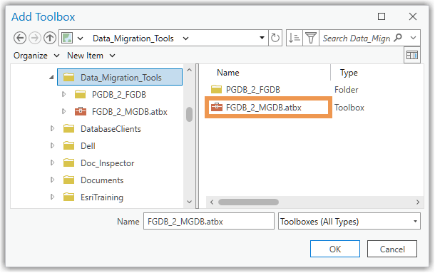

- Browse to the location where you stored the FGDB_2_MGDB.atbx and select Open.

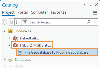

- From the Catalog pane, the newly added FGDB_2_MGDB toolbox is now under the Toolboxes folder. Expand the toolbox to see the File Geodatabase to Mobile Geodatabase tool.
- Double-click the File Geodatabase to Mobile Geodatabase tool to open.
