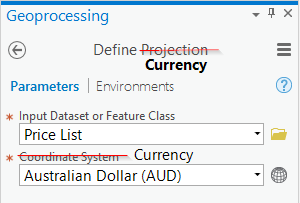

You think perhaps there’s something wrong with the currency. You live in Australia, so you want to make sure those dollar amounts are in AUD. You run the Define Currency tool with your price list and choose Australian Dollars.
You look at your new price list and discover that the tool did not solve your problem. The total still doesn’t match your credit card statement:

1. Run the Define Currency tool and choose Canadian dollars:
Your new price list looks like this:

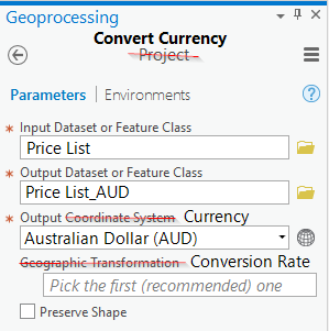

2. Run the Convert Currency tool and choose Australian:
Now the price list looks like this:
| Shoes | $24.37 AUD |
| Hat | $12.33 AUD |
| Water Bottle | $8.22 AUD |
| Total | $45.22 AUD |
