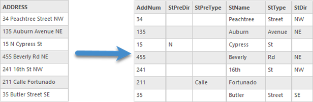

Another common term related to geocoding is address standardization. Address standardization is about taking a complete address and breaking it down into its components. For example, a USA address may have a house number, a street name, a postal code, city name and state. The street name could be further parsed into components such as the street direction, base street name and street type. It may be useful to have address components standardized so you can query addresses based on those existing, for example in a postal code.
Address data that is standardized can be easier to work with and is a key part of Esri’s geocoding system. All reference addresses are standardized. When you match an observed address against a reference address, the fully standardized reference address is returned in the result. So, for any unstandardized input address that is validated and verified, you will receive a fully standardized reference address in the geocoding output. Addresses that geocode against Esri’s geocoding system at the subaddress and Point Address level are validated against comprehensive authoritative data, and the output includes a standardized form of the address for effective organization or address components and querying.

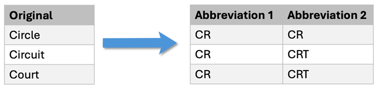

Another common term used in geocoding is address normalization. Normalization is about taking different terms like STREET, STR and ST and converting them to a common representation. STR and ST are abbreviations for Street. Converting them all to the same value can simplify how data is represented and can make querying data more straight forward.
However, address normalization does have some challenges. By changing the original authoritative reference data it’s possible to introduce ambiguity into an address. Consider the street types of CIRCLE, CIRCUIT and COURT. It’s possible to abbreviate all these streets to CR, but only CIRCUIT and COURT would abbreviate to CRT.
Street type normalization

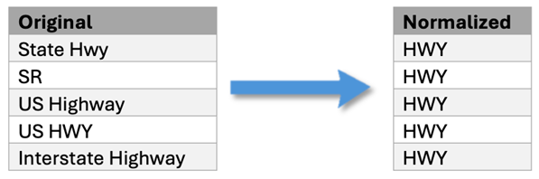

Another example of normalization would be the conversion of a series of differently named highways to a single name.
Street name normalization
In both examples, the intent of the original data is no longer available to users. By constraining data to a single representation, contextual detail about the street type and street name is absent. For the maintenance of comprehensive address data, this is an undesirable outcome.
Address normalization can be challenging to implement; there are always some edge cases where errors are introduced into the data and false positive matches are the result. Esri has built a geocoding system where normalization is minimized to preserve the original authoritative data, thereby maximizing the quality of address validation by not changing the original authoritative address source.

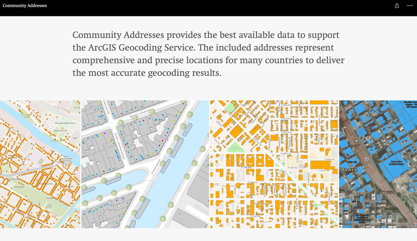

We’ve used the concept of an authoritative address data source above. Some great authoritative sources are local governments who are responsible for managing local property ownership, building permits, tax rolls and more. These local sources are key in ensuring address data is collected and managed to support local activities. Esri is focused on supporting local agencies who manage authoritative addresses, with a pathway to have their data used in Esri’s geocoding system.
The ArcGIS Community addresses program allows local organizations to feed their curated data directly through to Esri for inclusion in our geocoding capability. That way we can validate and verify the existence of an address against the most comprehensive up to date sources. At the same time Esri is working with commercial organizations who are focused on building out addresses for interior spaces such as apartments and units. This helps us achieve the broadest possible coverage and the most comprehensive data to geocode or validate addresses against.
ArcGIS Community Addresses Program
