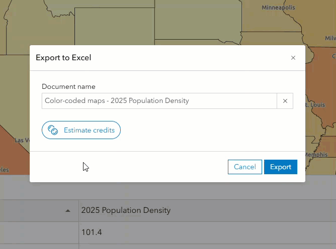

Some capabilities in Business Analyst consume credits, which are the currency used in ArcGIS. In Business Analyst Pro, you are typically able to click Estimate credits to get an idea of how many credits are consumed in a workflow. In Business Analyst Web App, you are able to click Estimate credits for some workflows, like exporting results to Excel or creating a PDF.
Animation of estimating credits to export color-coded maps results to Excel

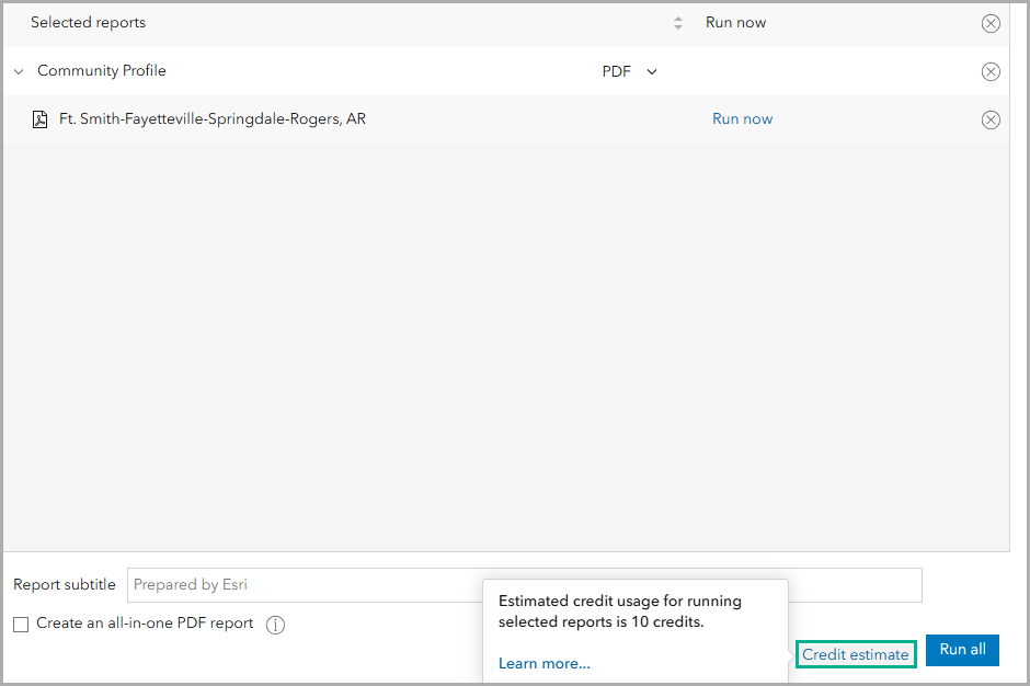

To use credits responsibly, there are several optimized ways to perform workflows. For instance, use the Run infographics workflow to view a tabular infographic prior to exporting it, saving you credits that are charged with exporting. Another example is when you’re running classic reports, you can click Credit estimate to get credit costs for running reports.
Click Credit estimates to estimate credit consumption of running a classic report.

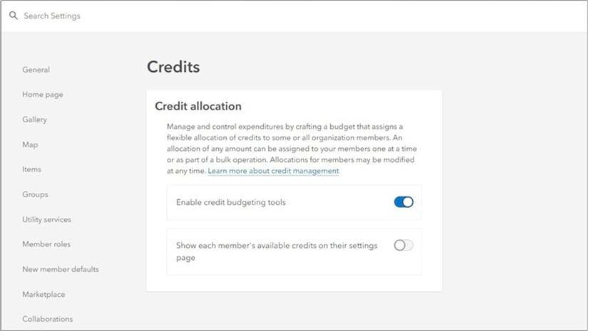

Some organizations provide a standard number of credits, such as 1,000 credits per user. Allocating a limited number of credits to each user creates a baseline of credit consumption. While you periodically review credits, be sure to check for outliers. If there is a heavy spike in credit usage, that can be used as a teaching opportunity.
