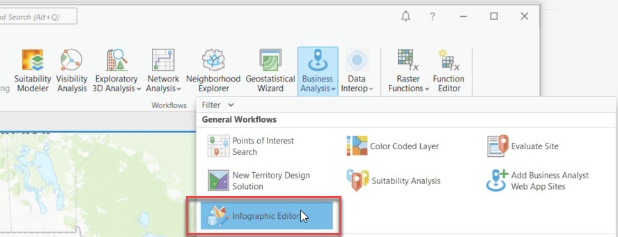

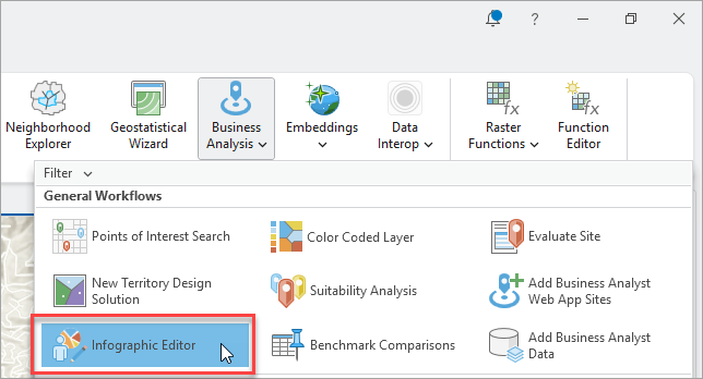

You can access the infographic editor from the Business Analysis gallery.
Infographic Editor on the Business Analysis menu

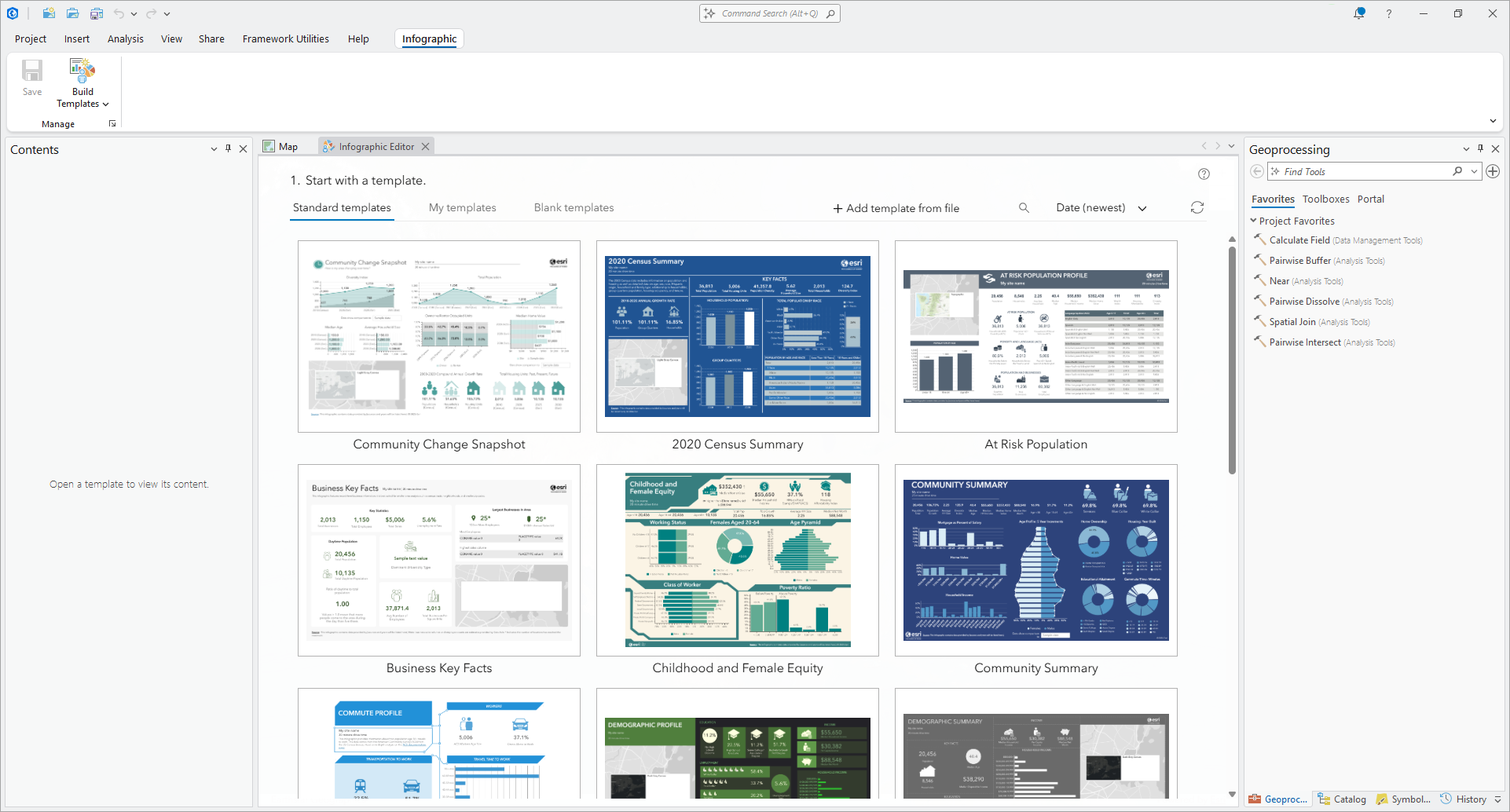

The editor opens in a new ArcGIS Pro view, similar to views for a map, model, Python notebook, or layout. You can float the view to full-screen for the best experience.

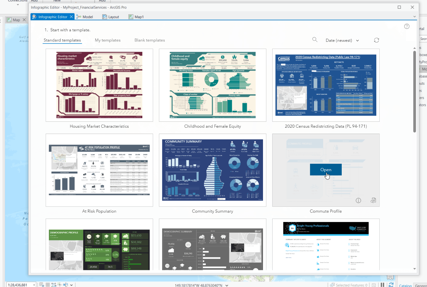

Once you’ve opened the infographic editor, you can choose from the following options to build infographic templates:
  • Standard templates tab – Modify Esri’s predesigned templates
  • My templates tab – Edit customized templates
  • Blank templates tab – Build a template from scratch
Editing an infographic template in using the float option.

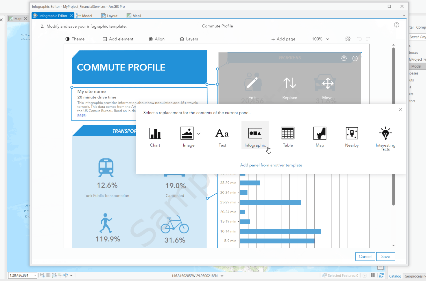

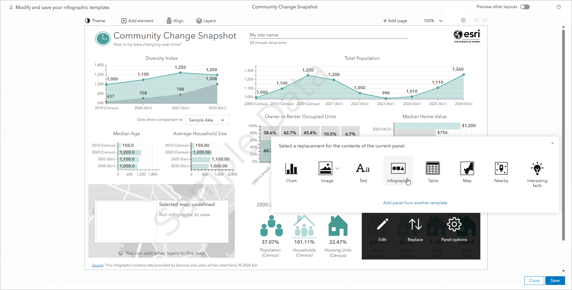

The following is an example of a standard infographic in the editing process. The editing options from Business Analyst Web App are now available in ArcGIS Pro, such as adding and modifying a chart, map, table, or image, and more.

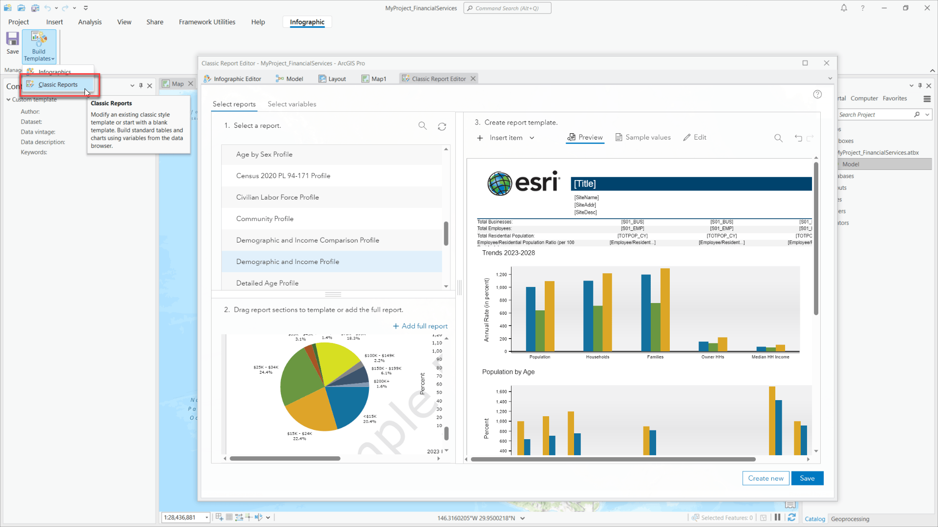

To open the report editor, click the Build Templates drop-down menu and click Classic Reports.
Editing a classic report template.
Finally, you can use ArcGIS Pro to edit a custom classic report that was created in ArcMap.
