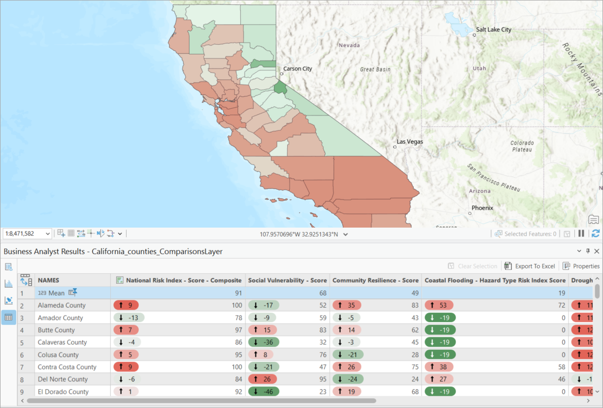

Tutorial results in Business Analyst Pro

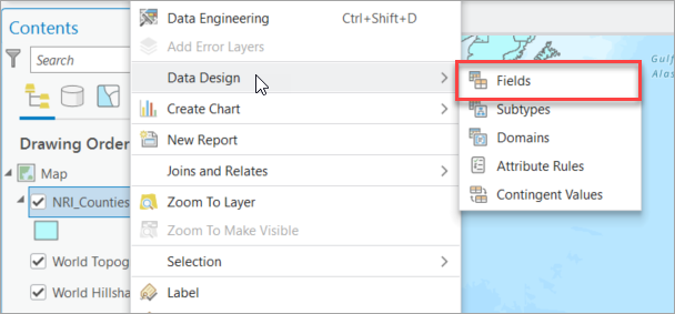

  2. Right-click the layer in the Contents pane and select Data Design > Fields to open the Fields view.
Opening Fields view

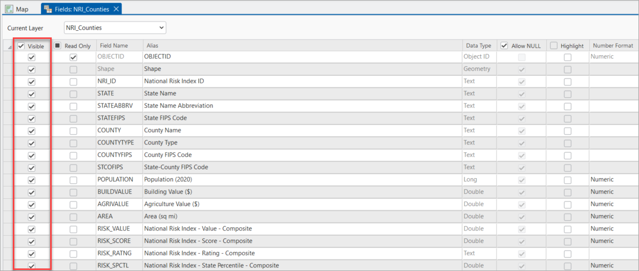

  1. Uncheck the Visible check box for non-essential fields—for example, OBJECTID, internal IDs, or irrelevant metrics, to exclude them from processing. Save your changes.
Visible check boxes in Fields view
This reduces the number of variables loaded into the SDCX, significantly speeding up index creation and analysis.

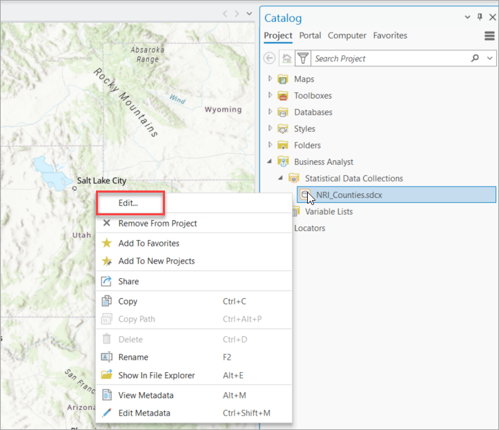

  1. Browse to the SDCX in the Catalog pane, right-click it, and select Edit.
Opening SDCX from Catalog pane

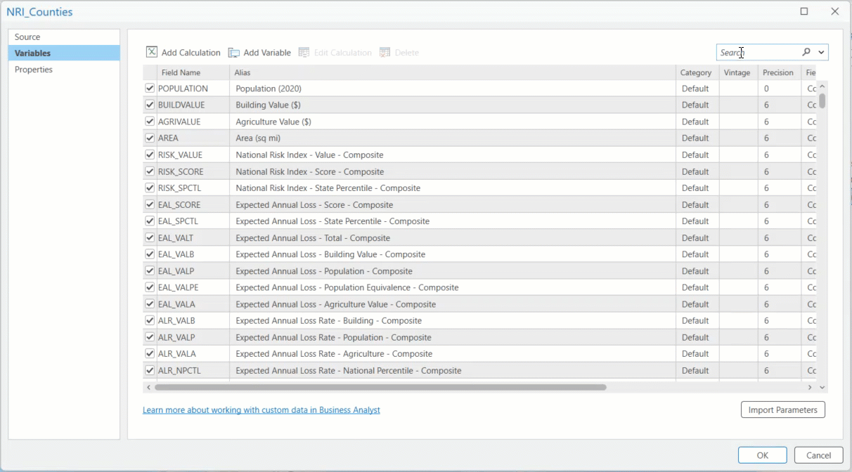

  1. On the SDCX editor’s Variables tab, use the Search box to filter and select only the variables needed for your analysis—for example, you could search for risk variables associated only with the word “drought.”
Searching variables in SDCX
  1. Avoid including all variables by default. Use Ctrl+A to select all, uncheck to deselect, then check only essential fields to minimize processing overhead.
This narrows the variables down to just the ones you picked.

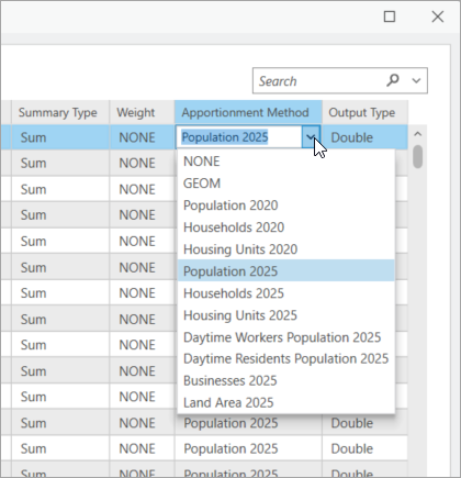

Apportionment defines the calculations used for estimating amounts of a variable geographically. For example, you may have mapped custom data in neat little block group polygons—but what if you then draw a drive-time area and want to know how much of a custom variable lies in that shape? Follow these guidelines for apportionment settings:
  • Choose an appropriate Apportionment Method parameter—for example, Population 2025 apportionment for demographic data, or Land Area 2025 apportionment for spatial metrics—to align with your analysis goals. Incorrect methods can increase processing time and produce garbled, unhelpful results.
Choosing an apportionment method
  • Set Weight fields, such as POPULATION, only when necessary. Weighted calculations add computational load.

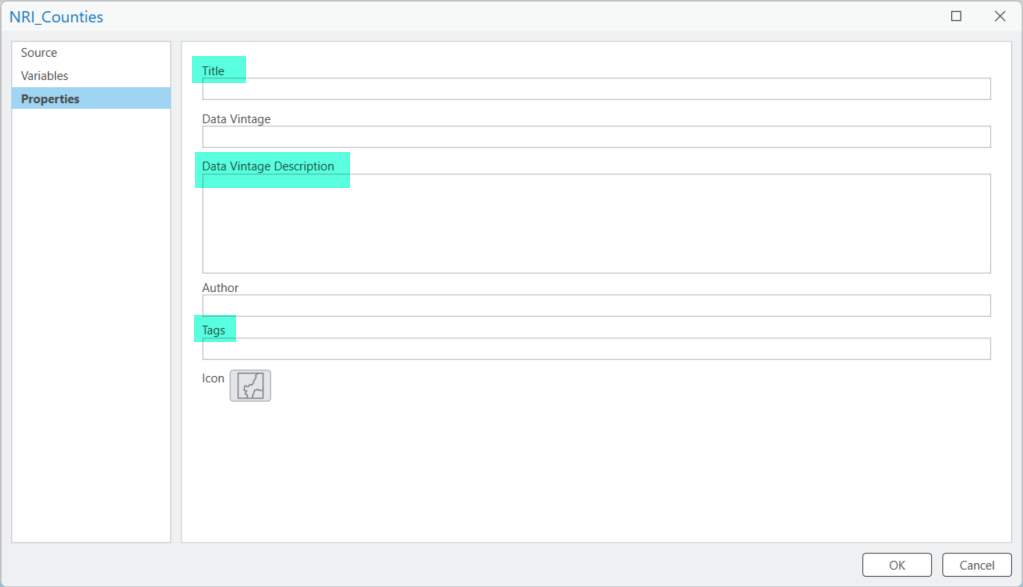

  • When sharing the SDCX via ArcGIS Online or ArcGIS Enterprise, include clear metadata—for example, Title, Tags, Description—to help team members understand the dataset’s scope and variables.
Metadata fields in SDCX editor window
