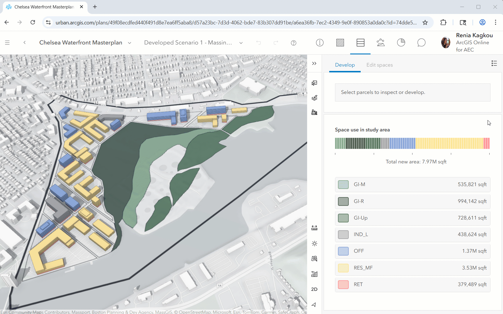

An easy way to start with programming and massing studies is by leveraging ArcGIS Urban. If zoning is not part of the project’s agenda, generate massing using custom building footprints from Rhino, AutoCAD, or SketchUp. Overlay on the site any type of analysis to guide the design, such as FEMA’s flood risk zones.
programming and massing with ArcGIS Urban
The advantage of creating the programming and massing studies in ArcGIS Urban is that you can quickly calculate their outputs and compare different scenarios. The metrics are completely customizable so anything can be calculated– from how many housing units you are adding, to energy use.
scenario output metrics in ArcGIS Urban

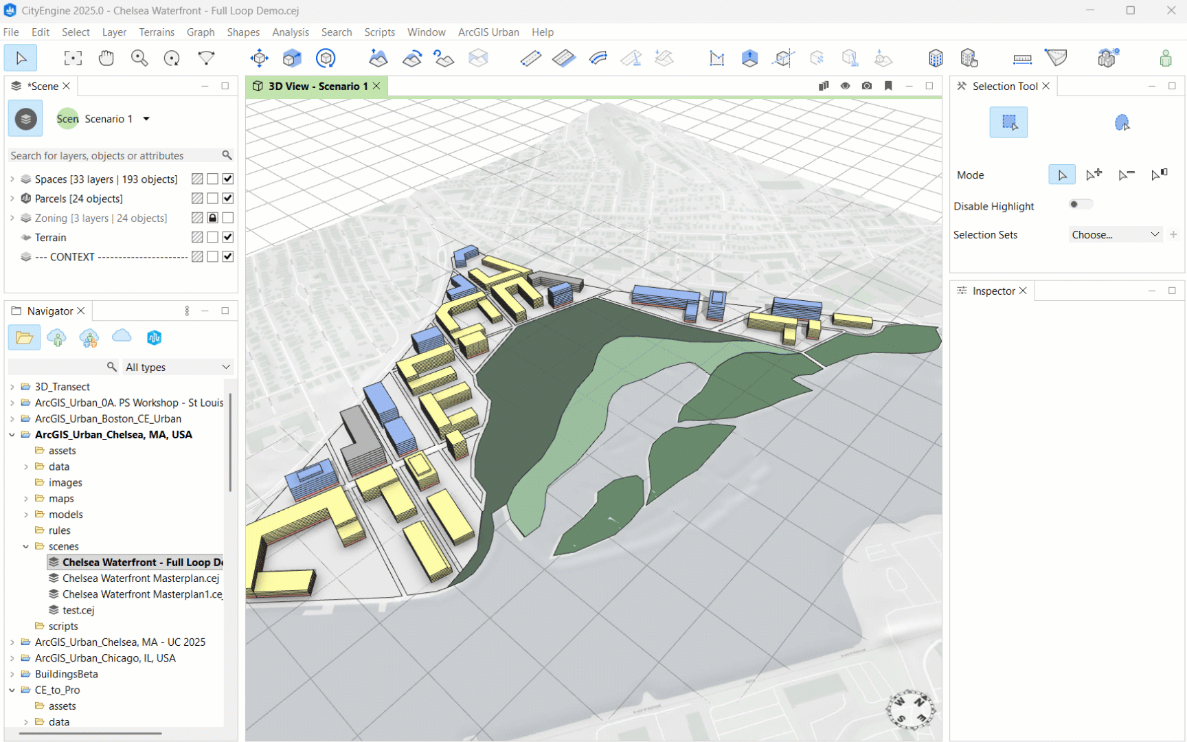

Sync your schematic design between ArcGIS Urban and CityEngine to design elements such as circulation, blocks, and landscape. For terrain alterations, use CityEngine’s terrain edit brush tool. Export the new elevation data from CityEngine as a DEM for analysis in ArcGIS Pro.
terrain editing with CityEngine

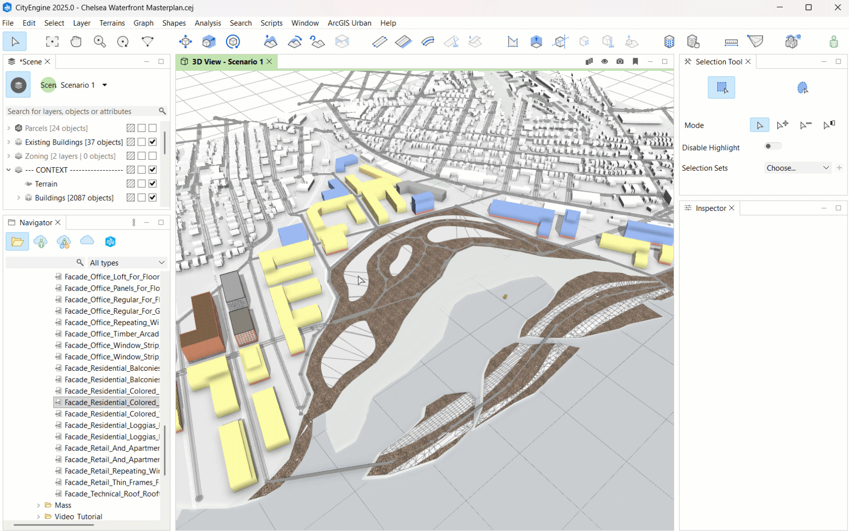

The design can be further advanced in CityEngine with procedural rules for vegetation, building envelope components, or streetscapes.
procedural design development in CityEngine

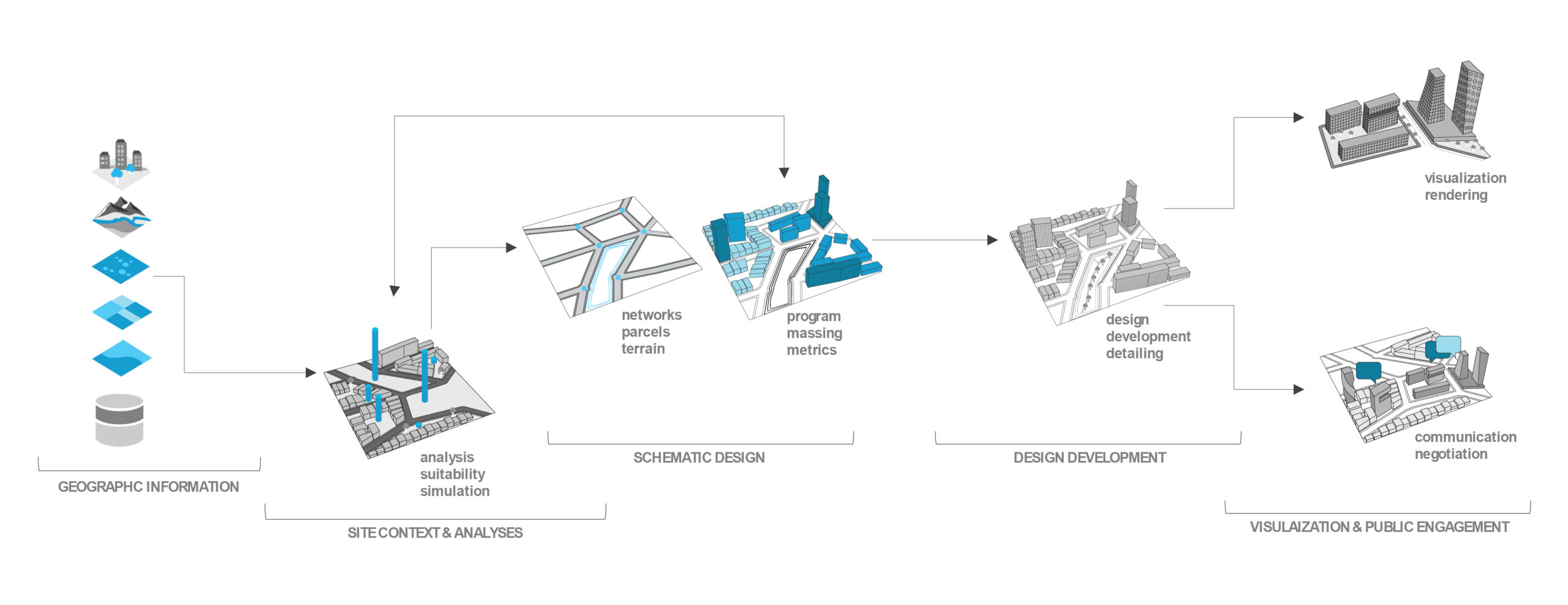

This full loop workflow represents a system of solutions and integrations. You can create your own workflows, choosing what tools and connections you want to make. Have fun exploring!
