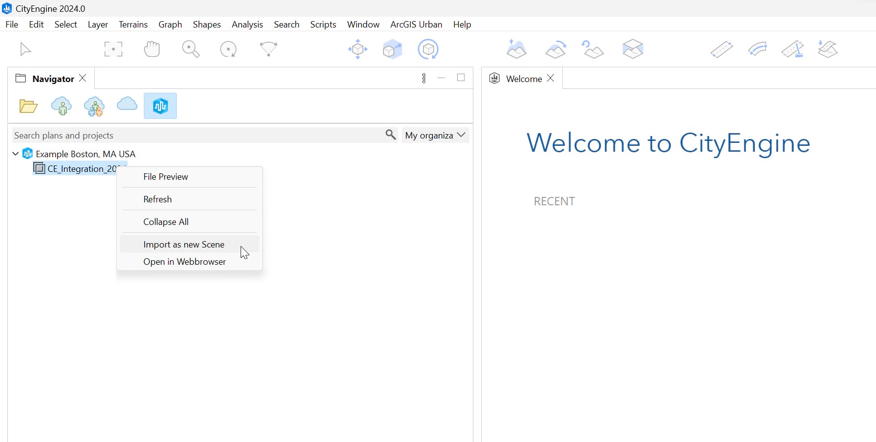

Once logged in to CityEngine, we can connect to the Urban items through the ArcGIS Urban tab in the Navigator window, which displays all the Plans from ArcGIS Urban that you have access to.
Right-click on the Plan we want to integrate and select “Import as new Scene”:
The ArcGIS Urban tab in CityEngine displays the Plans from ArcGIS Urban that you have access to.
The freely available example of the Boston Dot. Ave. Plan open in CityEngine.

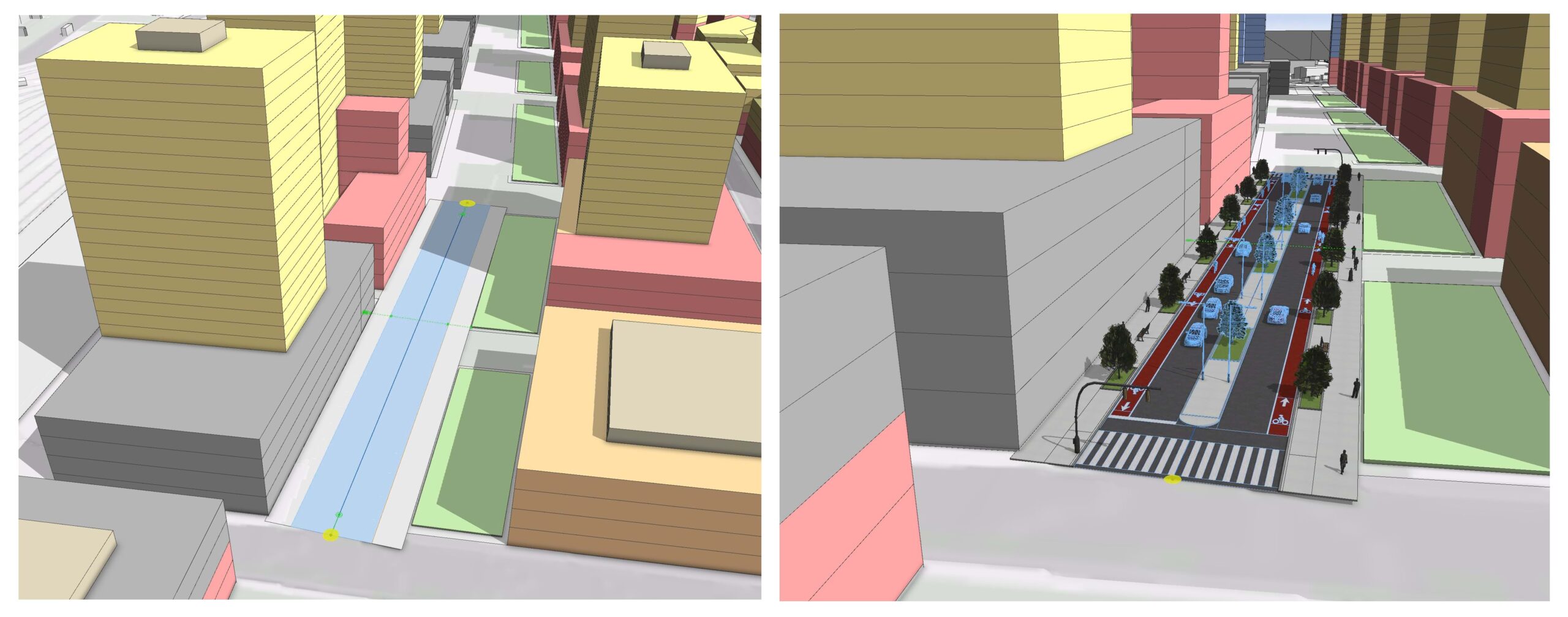

Street networks can easily be created using the Street Creation Tools. Then we recommend that you apply the CGA rule from the “Complete Streets” example project (can be downloaded in CityEngine under “Help – Download Tutorials and Examples”). The rule provides controls to design each type of street in 3D.
Example of street graph creation and Complete Streets Rule applied.

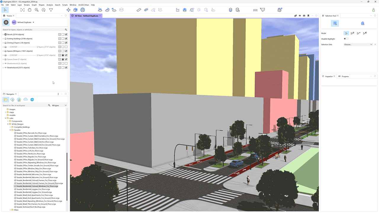

3. Generate procedural facades
Now it’s time to give your massing models some personality — and to do that, the official VCGA (Visual CGA) Playground Example is the best place to start. This is same example that we use here, and it’s a great source of rules directly available from the CityEngine Help menu.
In the Boston Dot. Ave. Scene you will find a good number of façade rules that we can apply immediately to Custom and/or Procedural Spaces. This way, we can turn their exterior appearance into detailed buildings that reflect a variety of uses and architectural styles with very little effort.
Facade rules applied to Custom Spaces at the podium of a building.
Applying facade rules to Custom Spaces at the podium of a building.
You can watch a short demonstration below to quickly learn how they work:

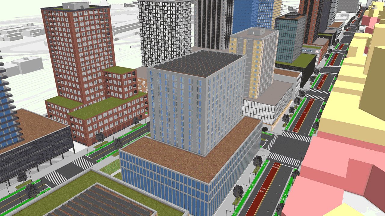

Combining different types of facade rules results in richer urban landscapes.

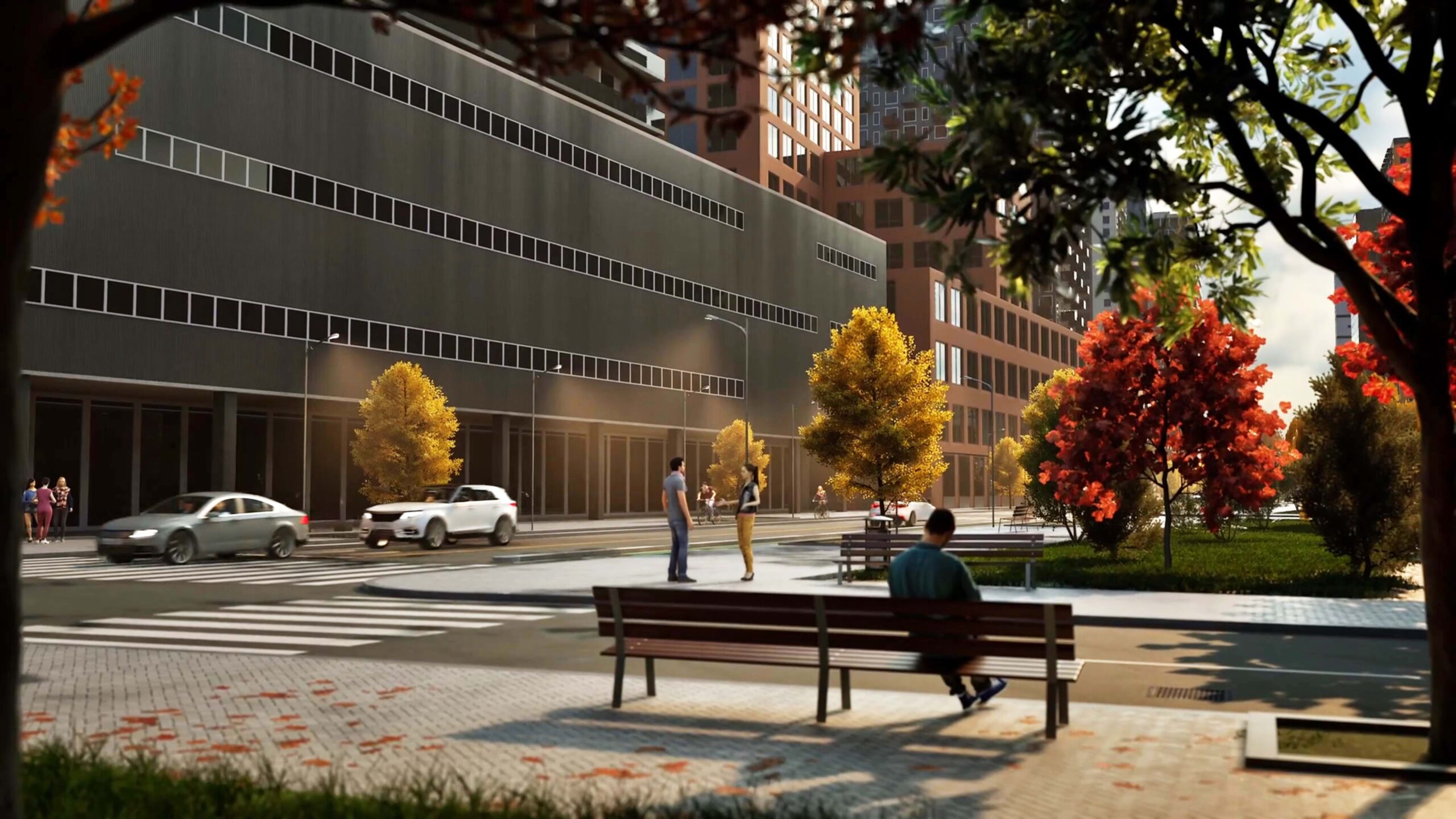

To bring our scene to the next level, we can export it into Twinmotion to create compelling visuals and animations.
A scene from the Boston Dot. Ave. Plan rendered in Twinmotion.
Once we’re happy with our façade designs, streets and terrains in CityEngine, the whole scene can be easily exported as a Datasmith file format and opened in Twinmotion. We can benefit from this powerful platform and replace assets and materials with their libraries, so our urban concepts really shine in both static and video presentations.
