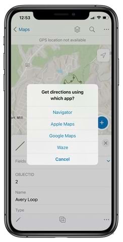

QUESTION: Is there a way to use internal mapping layers (for example, roads and trails) for ArcGIS Field Maps to give directions to a site?
ANSWER: If you want to route to an asset in your map, you can select it in ArcGIS Field Maps and then select the directions tool. The directions tool will then display your installed navigation apps and pass through the asset’s location. However, if you wanted to route to assets that are on private roads or use your own network datasets (roads and trails), you would need to use ArcGIS Navigator.

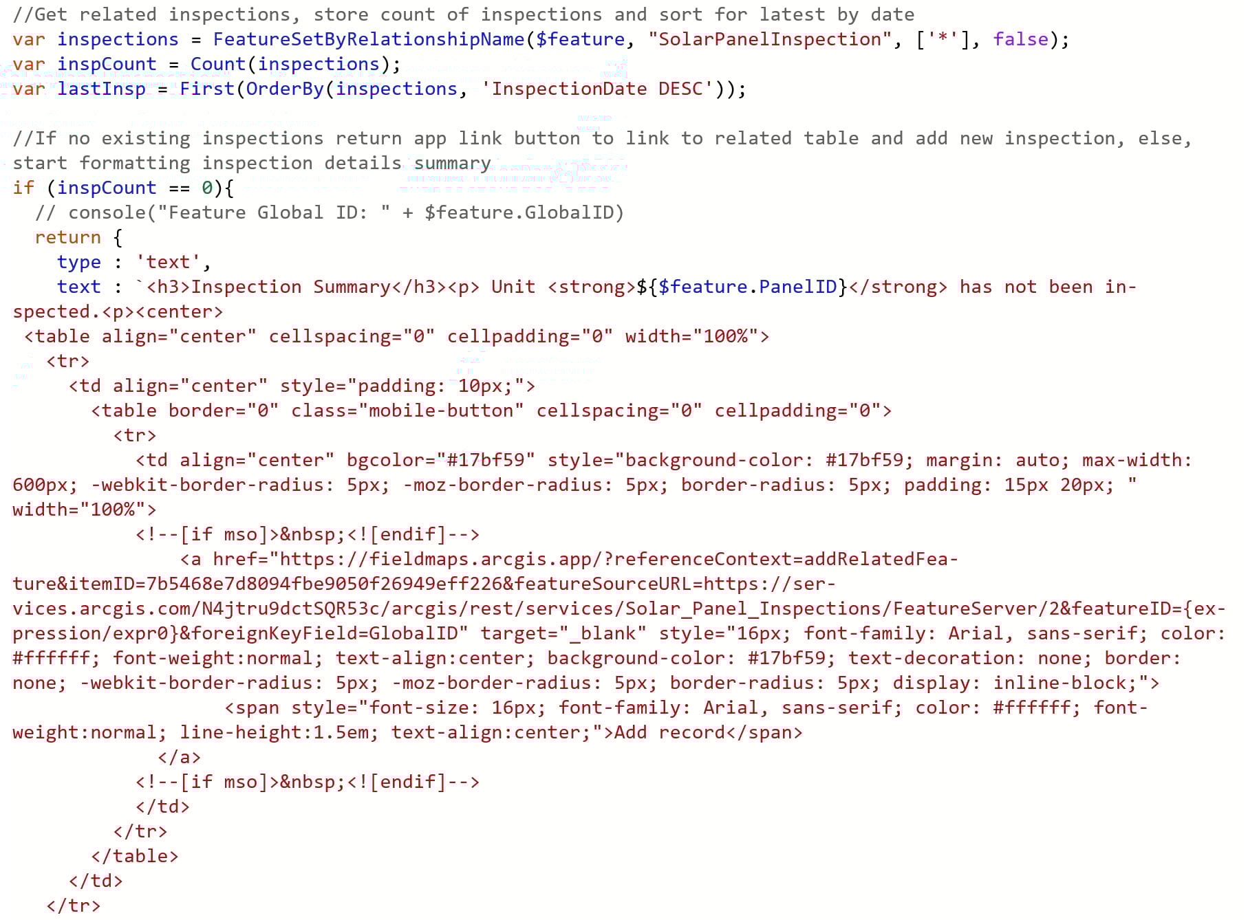

QUESTION: How do I create a new record for each inspection, instead of overriding the existing inspection?
ANSWER: Using related records, you can keep a history of inspection activities for each asset. The attributes for your assets will not change and reside in the parent layer. By creating a related table, you can add the fields needed for your inspections to your table. Then anytime you perform a new inspection, a new record is created in your related table. To learn more about related tables and how to set them up, see Join a table to a feature layer in ArcGIS Online or Create Relationship Class (Data Management) for ArcGIS Pro.

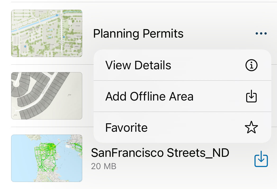

QUESTION: Can users create offline areas?
ANSWER: Users can create offline areas in the ArcGIS Field Maps mobile app. In the browse view, select the overflow menu next to the map, and select Add Offline Area. Users can create multiple offline areas for a single map.

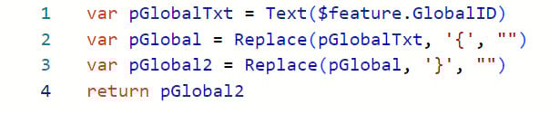

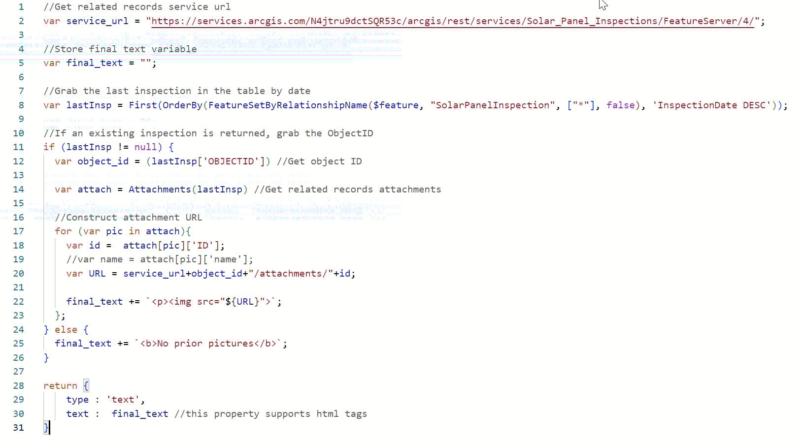

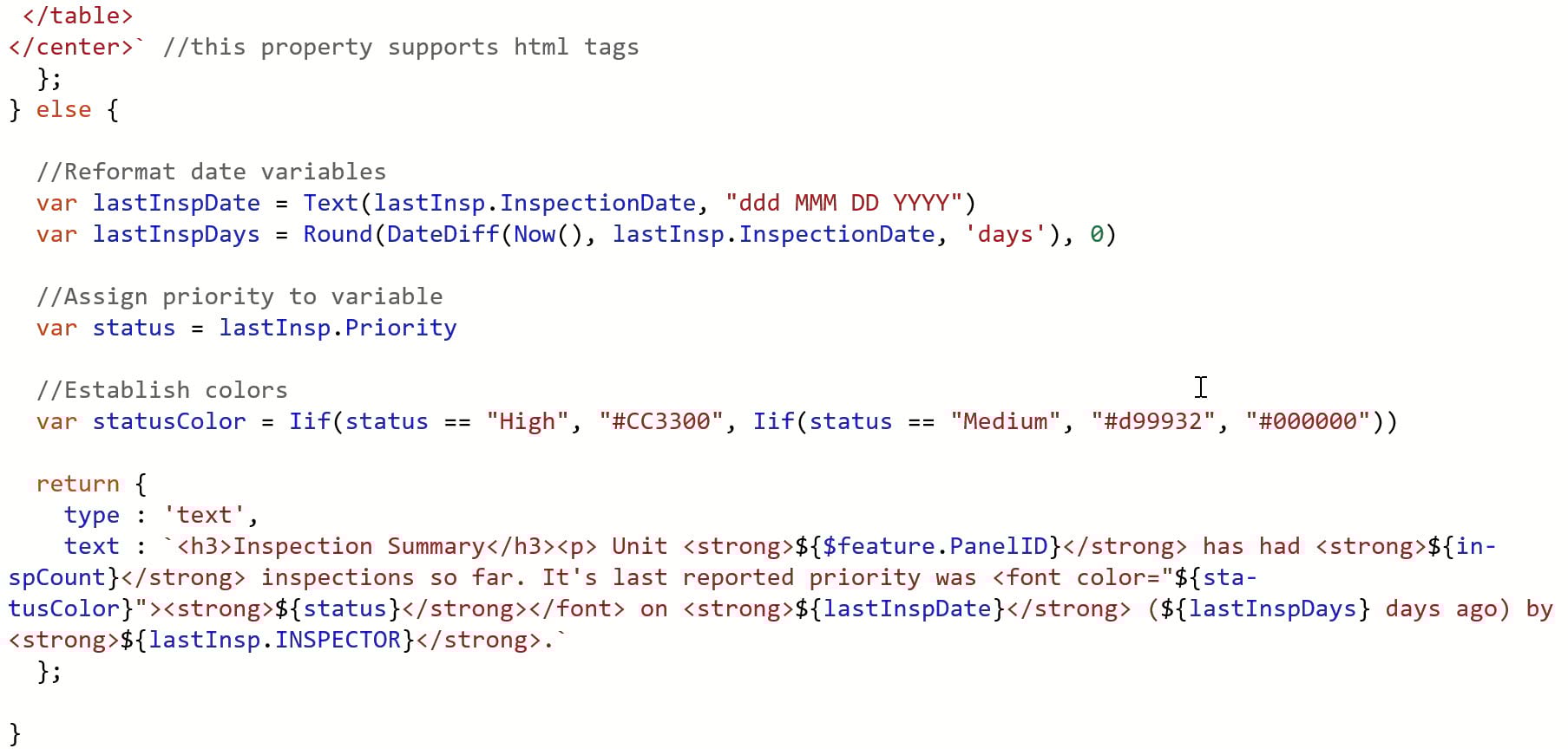

ANSWER: Yes, here are the Arcade expressions used by Colin in the webinar:
Globalid Format
globalid format
Fetch last attach pop-up
Last Inspection details
Last Inspection details part 1
Last Inspection details part 2
