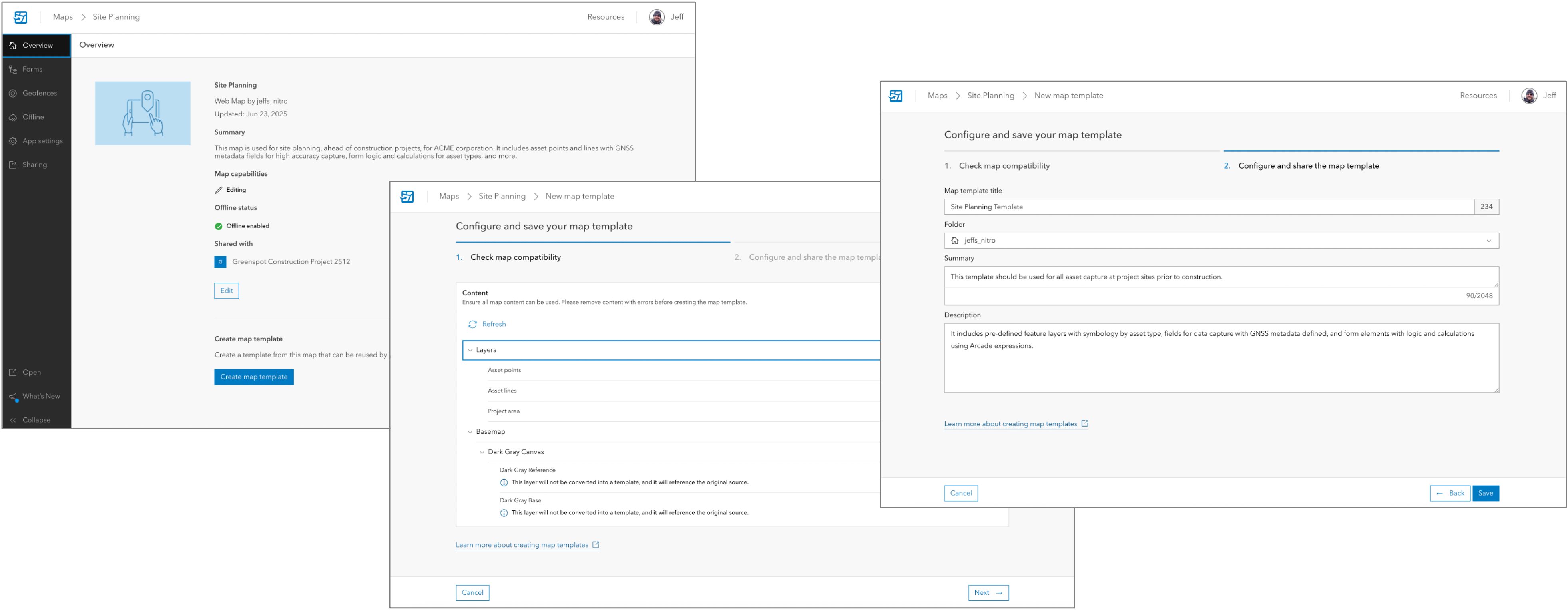

Creating map templates
To create your own template for future projects, click Create map template from the Overview tab. The new map template wizard will then analyze the content within your map for compatibility and identify content that will not be converted into a template. In some instances, this may simply identify map layers that will “reference the original source” in the new template and in others may result in errors that need resolution.
Important considerations:
  • Feature layers
    • For a layer to become a template, it must be a hosted feature layer and the map author must either be the owner of the service or an administrator in the organization.
    •  A hosted feature layer can “reference it’s original source layer” if it is contained within a group layer. This can be quite useful for layers you do not edit in the field but are used as a source for calculated expressions (like a parcel layer for example). You must still be the owner of this layer. If ownership is a challenge, consider using organizational templates for these type of layers where an administrator can create the template.
    • Referenced, non-hosted feature layers are not supported at this time.
  • Map image layers
    • These layers will carry over to the template and referenced to it’s original source layer.
  • Vector tile layers
    • These layers will carry over to the template and referenced to it’s original source layer. Note that a vector tile layer with a vector tile style type keyword will be copied and not referenced.
  • Basemap layers
Once compatibility is achieved, providing a name, summary and description is needed to configure and share your new map template.
You can create a new map template from an existing map in Field Maps Designer.
With the June release, you can not update map templates once created. If you’d like to make updates, update the map used to create the template, delete the old one, and create a new map template from the updated map.

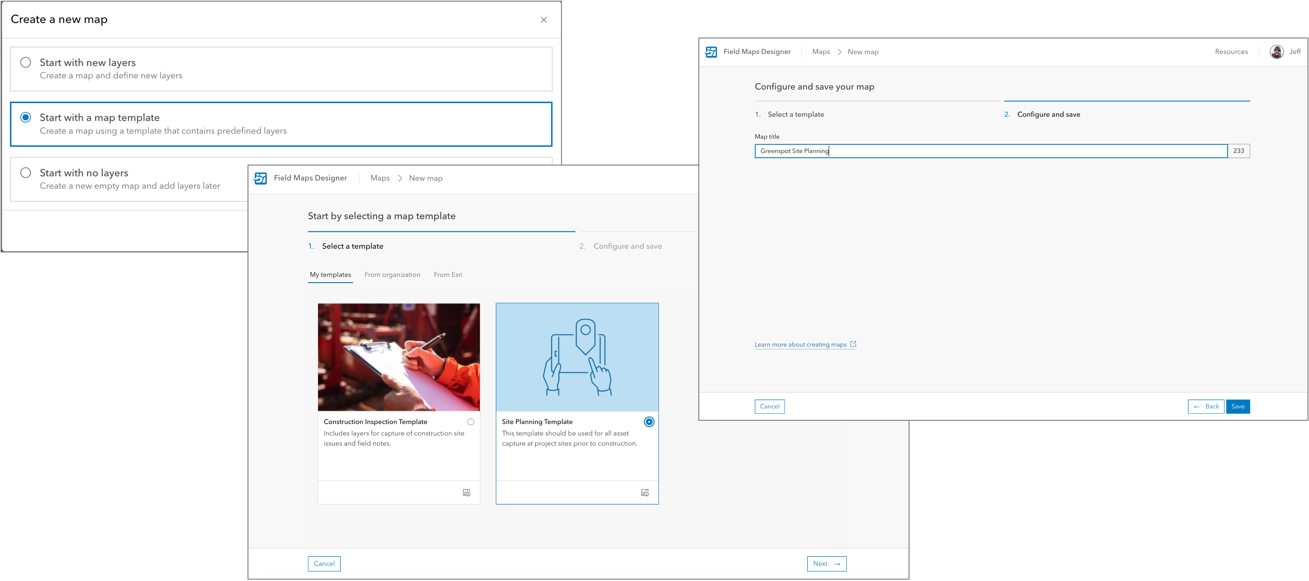

Creating a new map from a template
You can easily create new maps from the template by clicking the New Map button and choosing Start with a map template. Select the template you wish to use and then provide a name for the new map.
New maps from a template will create new layers using the symbology, templates, forms, and pop-up definition of the map template.

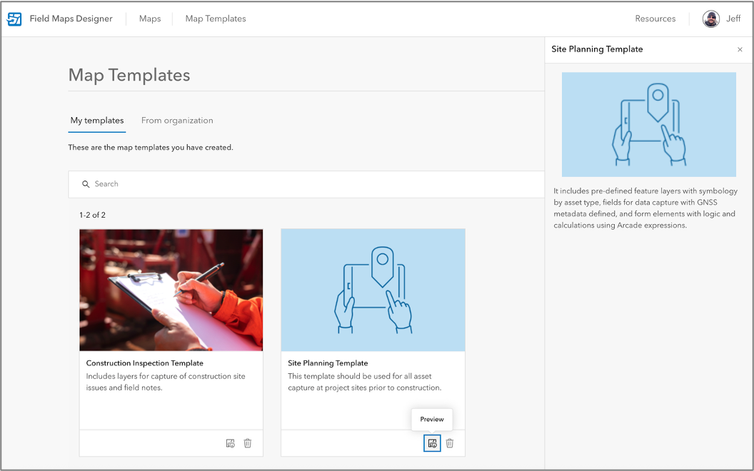

Clicking the Map Templates tab, you can search for map templates, preview their capabilities, and delete those no longer used.
Search, preview and delete templates from the Map Templates tab.

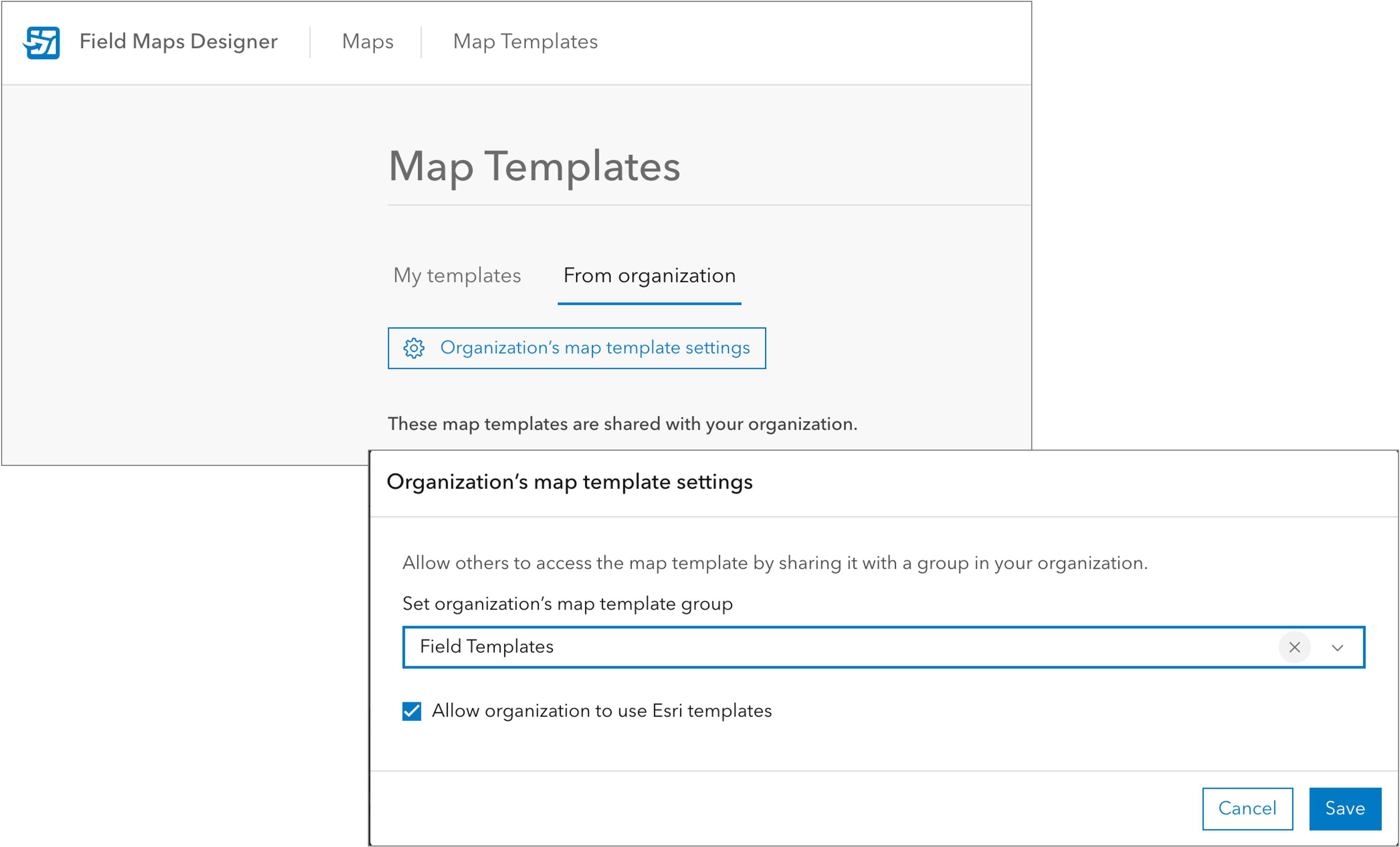

Organization templates
GIS administrators can set a map template group for use by all map authors in the organization. For large organizations that centrally manage field project data conducted from regions/remote offices or business units, this is a great solution for streamlining project creation and providing consistent map content.
Signed into Field Maps Designer, an administrator with default administrator privileges, or with the Organization setting > Organization website privilege, can configure Organization’s map template settings by clicking on the From organization tab. From the settings dialog, they can choose a group that includes maps that will be used as templates by map authors and optionally enable/disable the use of Esri map templates within the organization.
Administrators can allow map authors to access templates shared within a group.
When creating the group, consider appropriate use of these group settings:
  • Who to invite to this group? – map authors across your organization that will be creating maps using Field Maps Designer. If a map author doesn’t see any organization templates, it’s likely they are not a member of the group!
  • Who can view the group? – setting to Only Group Members you can restrict access to map authors using templates.
  • Who can be in this group? – set to My organization’s members only.
  • Who can contribute content? – the likely choice would be Group owner and managers. This group setting, coupled with the Shared update group designation, provides flexibility on how you want to maintain templates and who can update templates shared across the organization.
