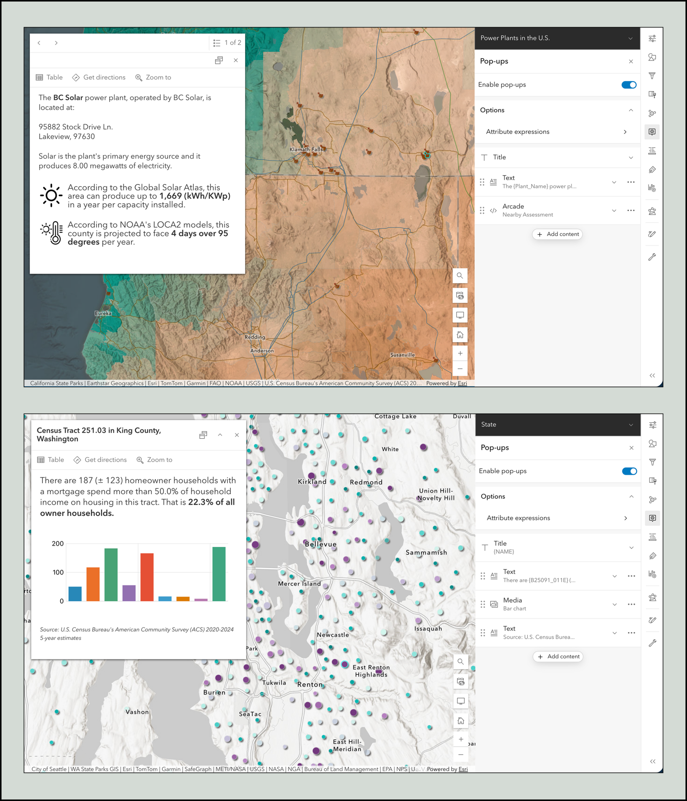

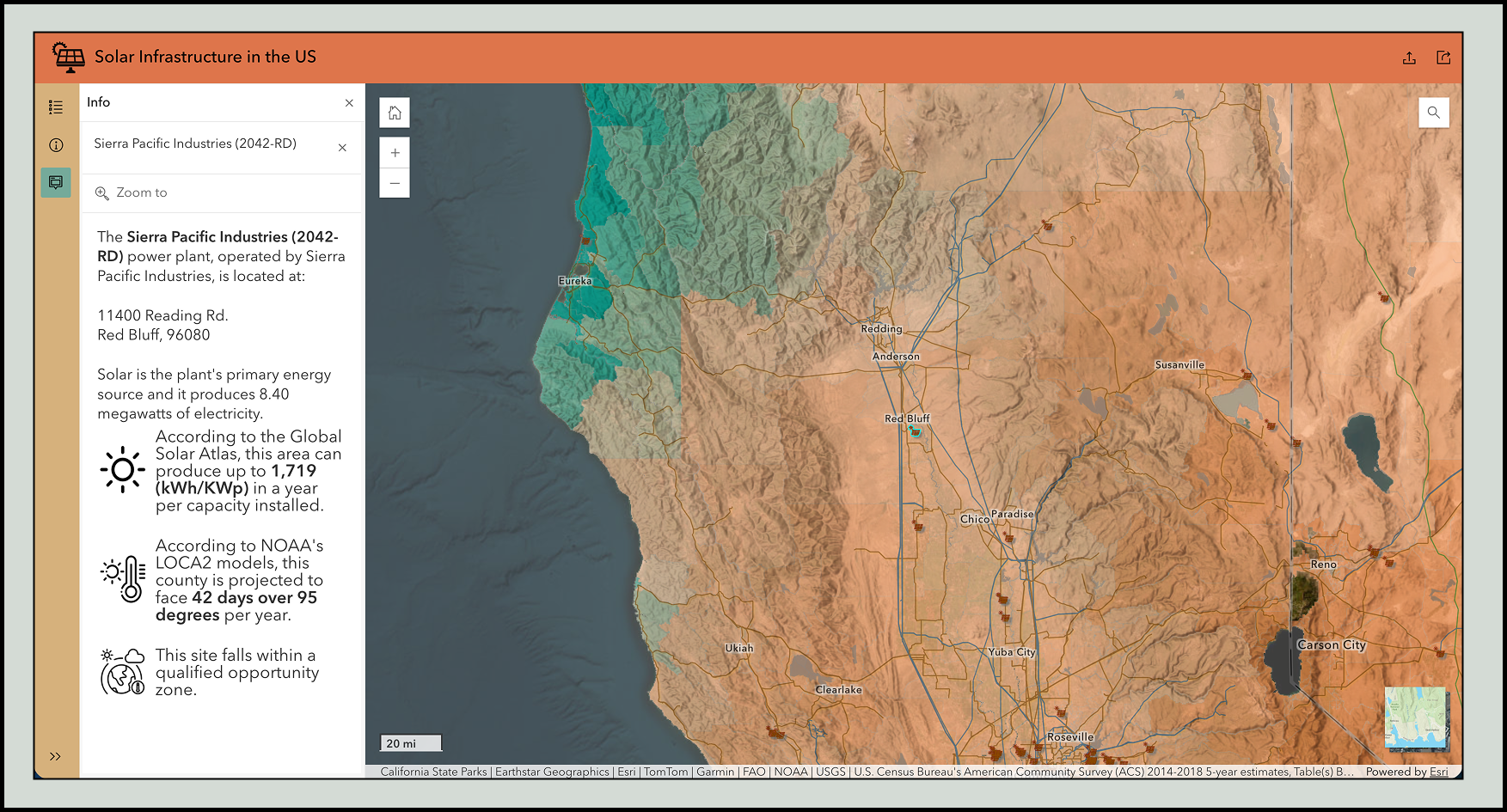

Pop‑ups
Pop-ups are often a user’s first window into your data. Well-designed pop‑ups can answer questions, reveal insights, and help users quickly understand what exists at a selected location.
Map Viewer provides a comprehensive set of tools for crafting meaningful pop‑ups, including:
Examples of pop-up configurations open in Map Viewer
Once your pop-ups are configured, they instantly carry over into many Instant Apps templates. A few templates in particular showcase them especially well:

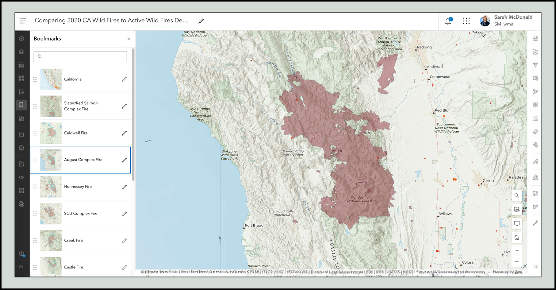

Bookmarks
Bookmarks are shortcuts to key locations, helping users return to important areas in the map with a single click. They can preserve extent, scale, and rotation—making them valuable storytelling tools.
Screenshot of bookmarks in Map Viewer
Most Instant Apps templates include a standard bookmark widget, but a couple templates take them even further:

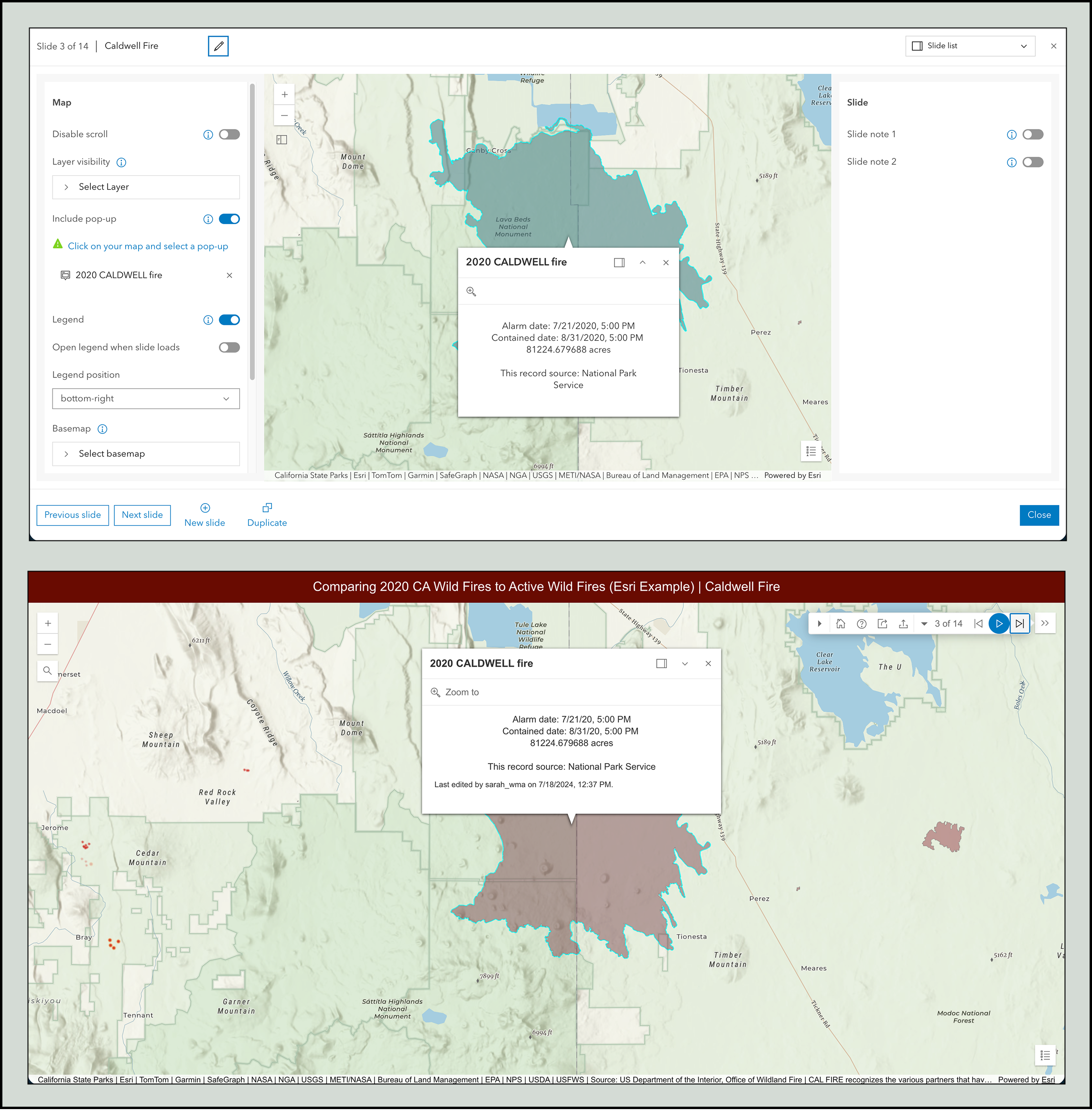

Exhibit – Show bookmarks as slides and automatically play through them. You can also enhance each slide with:
  • Layer visibility changes
  • Basemap switches
  • Pre-opened pop‑ups
  • Layer filters
  • Descriptive notes
Screenshot of Exhibit slide authoring and sample Exhibit app.
Interact with the Exhibit app: https://webapps.maps.arcgis.com/apps/instant/exhibit/index.html?appid=c85b979b481048088a9968b2c406769b

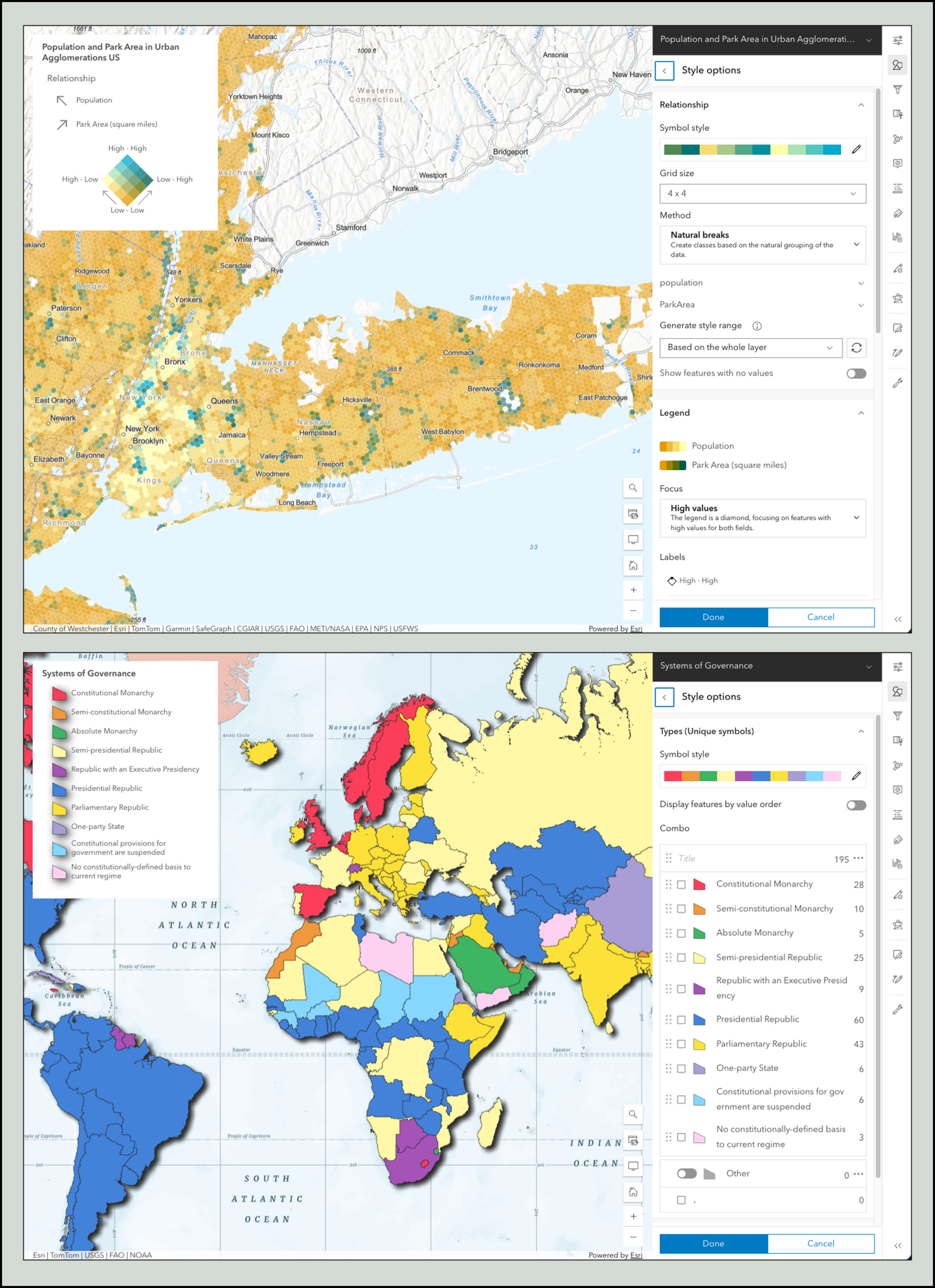

Styles
Smart mapping makes it easy to design data-driven visualizations using color, symbology, size, rotation, classification, and themes. Good map styling allows users to understand patterns and themes with just a glance.
Screenshots of style configuration in Map Viewer

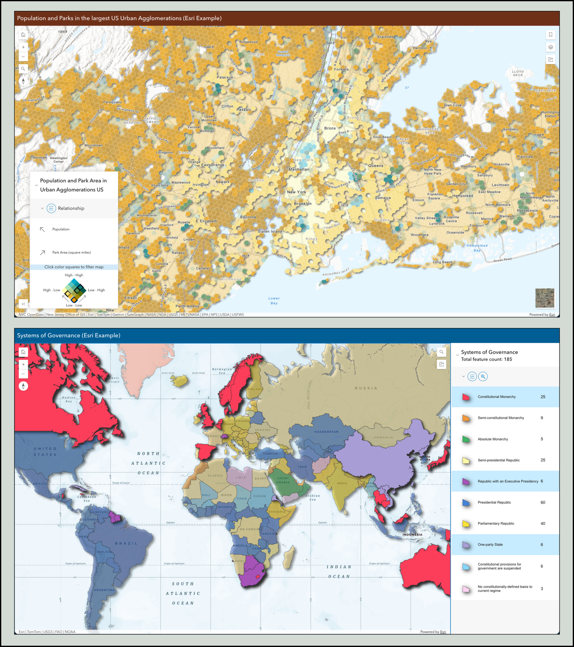

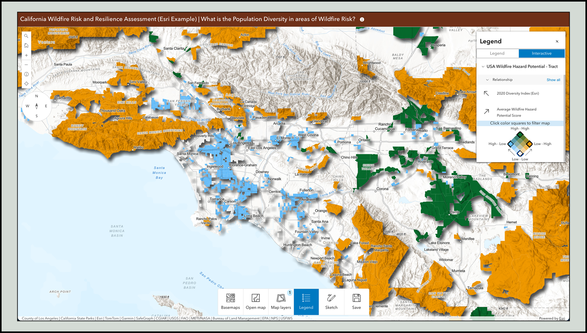

All Instant Apps templates include a map legend, but some support the Interactive legend tool, which lets users toggle categories or ranges directly from the legend itself.
Interactive Legend – Display the Interactive legend as a floating tool or as a fixed side panel, enabling users to filter features quickly.
Screenshot of interactive legend apps.
Interact with either of the Interactive Legend apps: https://webapps.maps.arcgis.com/apps/instant/interactivelegend/index.html?appid=e250d3b16f814e958ba055896d8e4c5f https://webapps.maps.arcgis.com/apps/instant/interactivelegend/index.html?appid=9636abf8b52a40319869f821c547f0a7

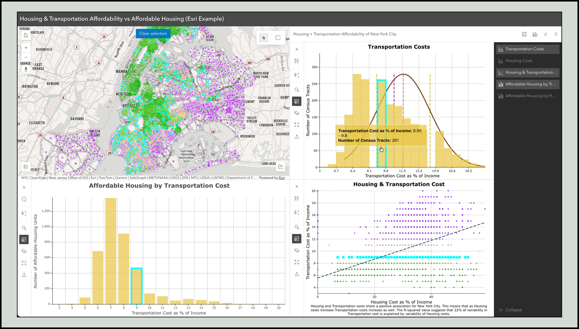

Charts

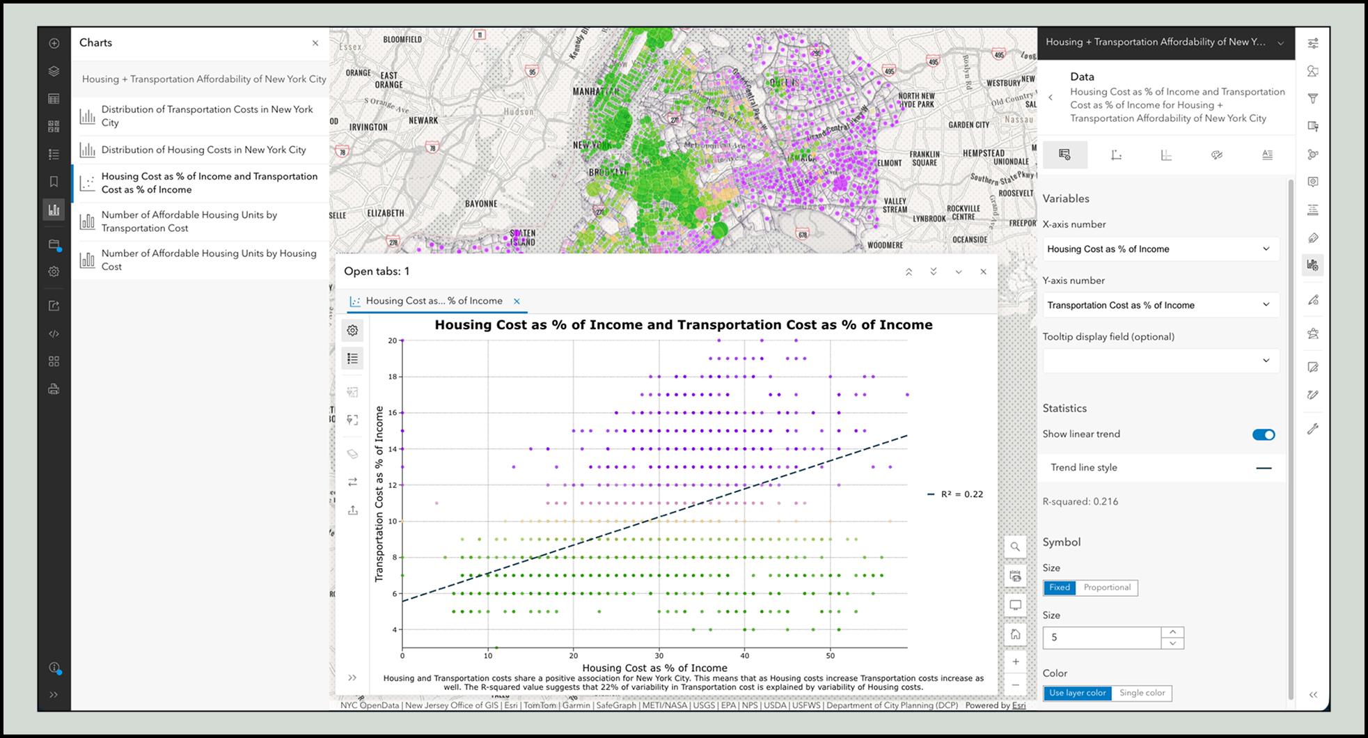

Charts configured in Map Viewer help reveal trends, patterns, and relationships in your data.
Supported chart types include:
You can configure titles, axes, guides, text, and symbols—putting significant control in the hands of the map author.
Screenshot of chart configuration in Map Viewer.
Chart Viewer – This template centers charts in the experience, automatically pulling in all the chart elements you’ve authored in the map. You can stack charts or place them side-by‑side with the map for easy comparison.
Screenshot of charts open in Chart Viewer app.
Interact with the Chart Viewer app: https://webapps.maps.arcgis.com/apps/instant/charts/index.html?appid=20c2f521452b49f7b6ee9d4043baa9d0

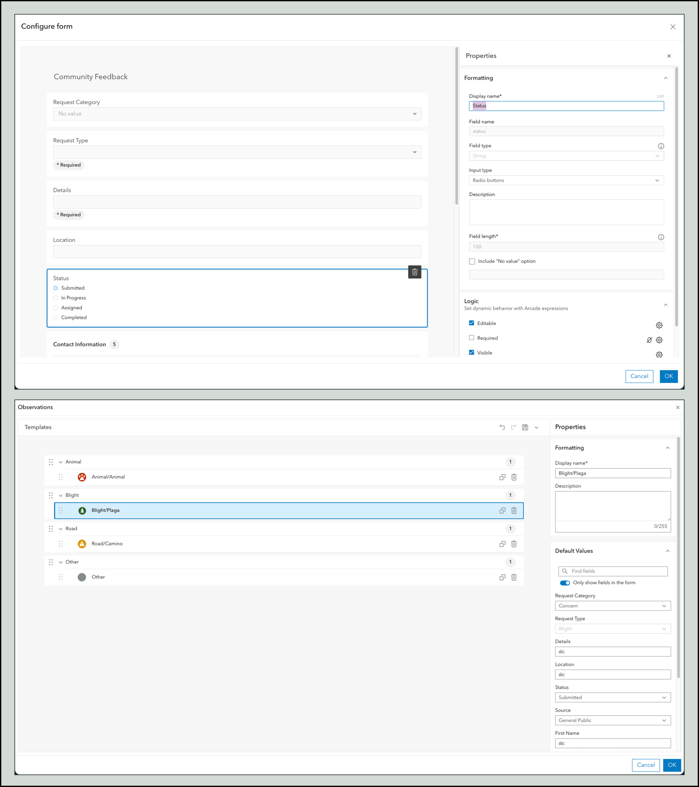

Forms and feature templates
If your map includes editable layers, forms and feature templates help ensure high quality edits:
  • Forms specify which fields are shown, required fields, allowed values, and contextual descriptions.
  • Feature templates provide predefined categories and default values, reducing repetitive data entry and guiding editors to consistent results.
Screenshot of field and template configurations in Map Viewer.

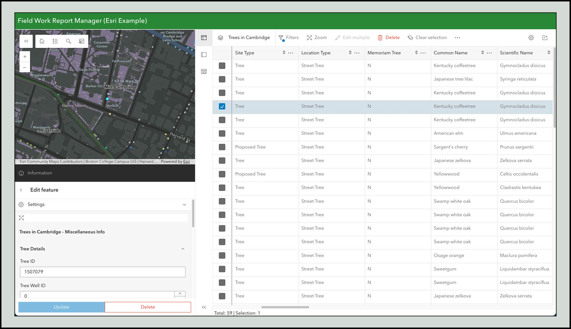

Instant Apps that support editing automatically use the forms and templates defined in your web map. Here are a few example of templates that support editing:
Manager – Allow users to review and edit features. It leverages your editing form configurations when updating existing features or creating new ones.
Screenshot of Manager app.
Interact with the Manager app: https://webapps.maps.arcgis.com/apps/instant/manager/index.html?appid=8e04a8829d9244ed92d7486c1ecbb73c

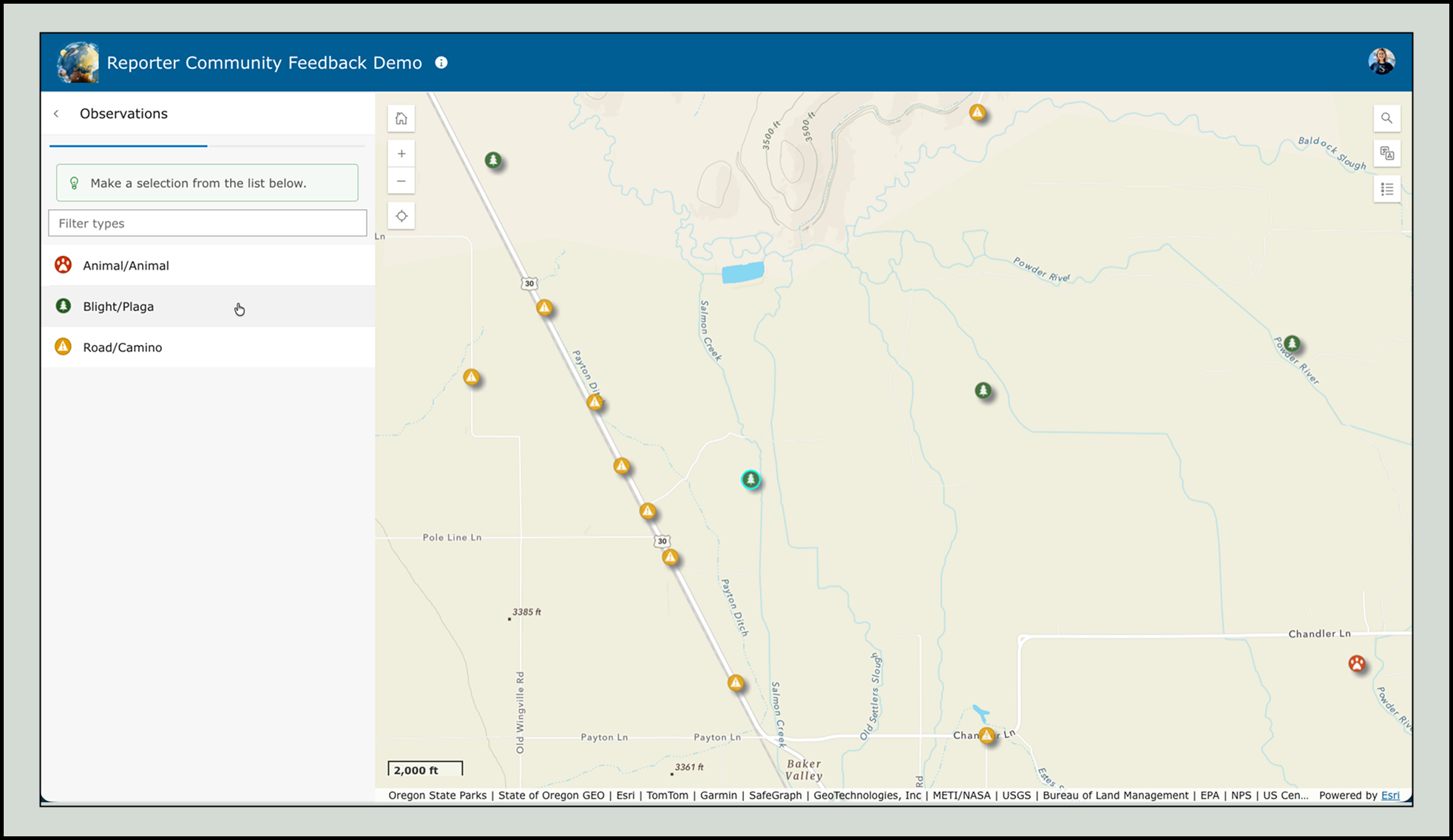

Reporter – Enable users to submit issues or observations on a map. Any templates or forms you’ve authored are applied during the reporting workflow.
Screenshot of Reporter app.
Interact with the Reporter app: https://webapps.maps.arcgis.com/apps/instant/reporter/index.html?appid=533c20e81c0e4dc6a3683b49f24c3fad
