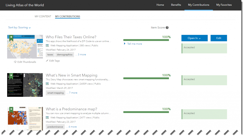

Within the Living Atlas site, the “My Contributions” tab shows items you own. The My Content tab shows which items are eligible for nomination, and the My Contributions tab shows the items which you have already contributed. Each item is scored by the completeness of the item and its metadata. The score helps to identify key characteristics of your item which will make sure others can find and understand the item. Sections left blank, or with too little content, decreases the score of an item.

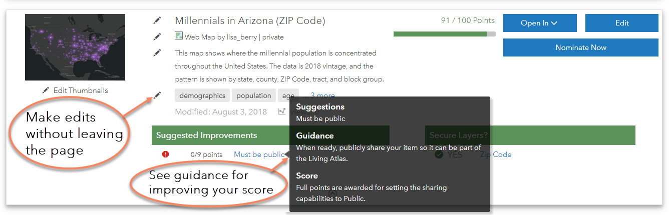

Click on an item to view the scoring, make edits, see suggested improvements, and to nominate an item. You can make certain edits directly to your item by using the editing pencils. You can also hover over the suggested improvements for more guidance.
An item requires a score of 80 before you can nominate to the Living Atlas. There are a few scored items that are required in order to see the “Nominate” button appear:
