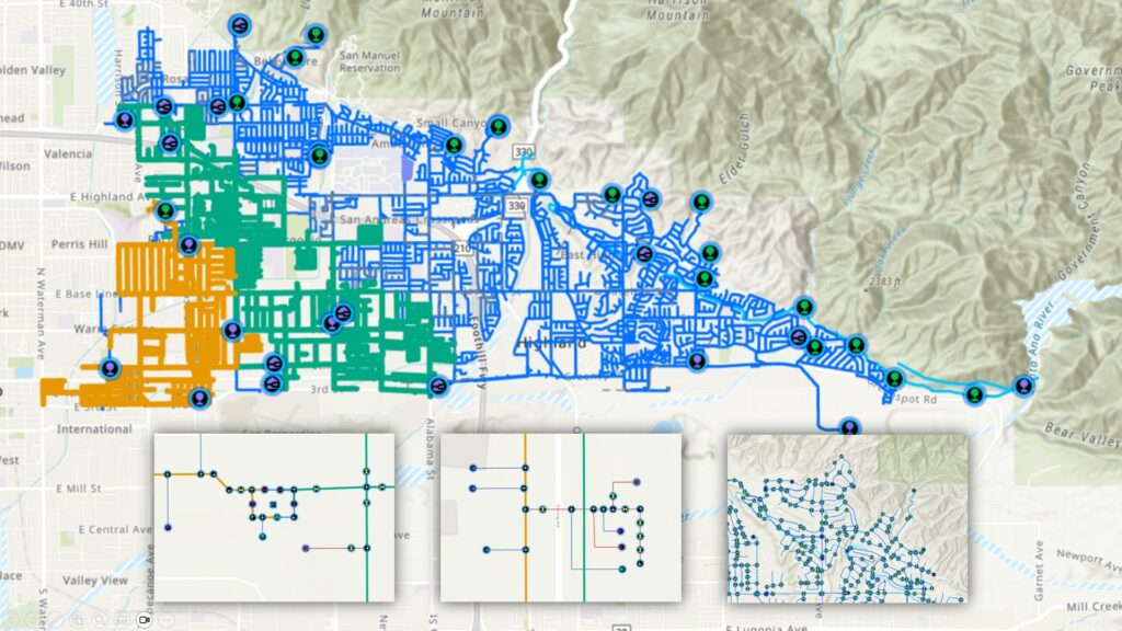

East Valley Water District’s water distribution network—with system subnetworks and some pressure subnetworks configured—is shown above. Inset photos (left to right) show a pressure regulation station between two subnetworks; a location in the network that includes commercial, fire, and irrigation services near the boundary of two pressure subnetworks; and, close up, the network near the eastern boundary of the district’s service area.

After the data was prepared and the final data model was designed, the data was officially migrated into the utility network model, and connectivity rules and other network elements were configured.
After a period of testing and initial review, a few adjustments and additions were made to asset types and connectivity rules, and the data was loaded onto the district’s enterprise database. Pro-West supported the district with training targeted for engineering staff, who will integrate utility network data into their work, and IT staff, who are leading editing workflows. Operational activities and organizational resources were transitioned to ArcGIS Utility Network through the development of viewers for field staff; integrations with inspections, asset management, and work order management systems; and new editing workflows that include QC performed by engineering.

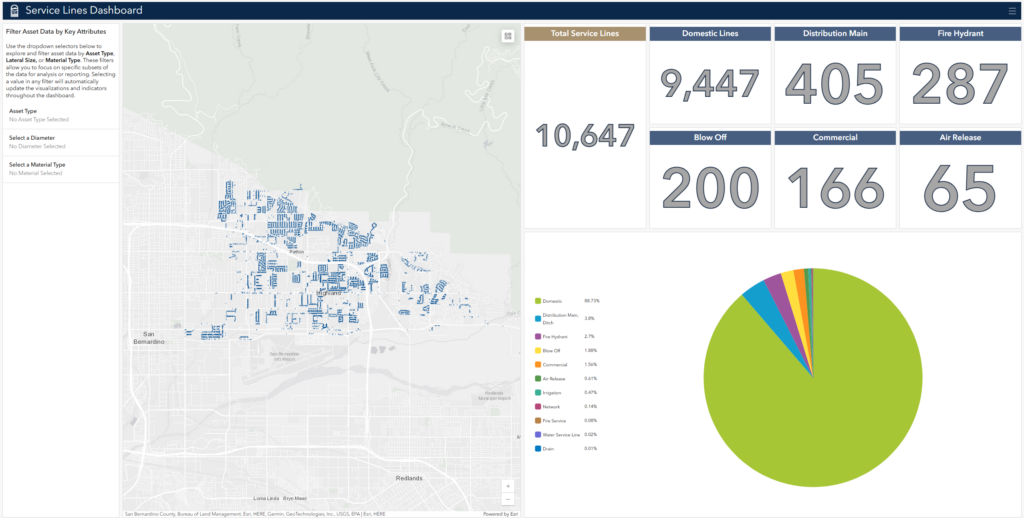

The district’s Service Lines Dashboard streamlines utility workflows by giving staff a real-time visualization of service line data. By combining mapping elements, charts, and indicators, the dashboard improves situational awareness for key stakeholders.
