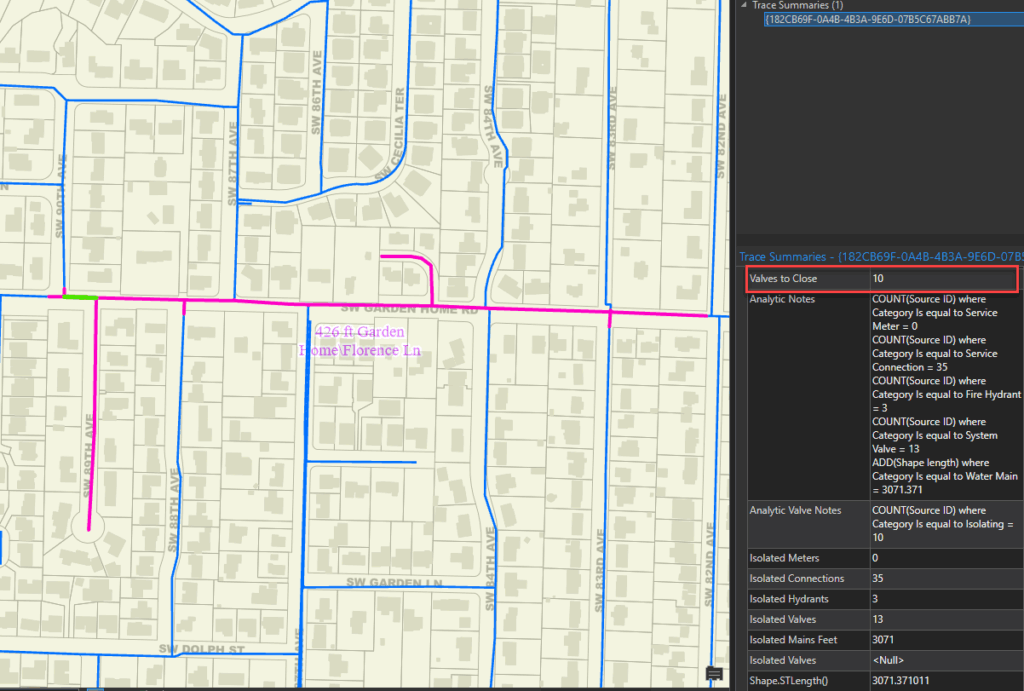

Trace Summary with 10 Valves to Shut Down with Origin Main
To address these questions and considerations, NV5 developed and ran two system-wide trace analyses:
  • Valve Impact Trace: For each of the 42,000 pipe segments in TVWD’s network, the trace calculated how many valves would need to be closed to isolate that segment. This helped flag areas—sometimes as many as a dozen—that required excessive valve manipulation just to isolate one pipe.
  • Customer and Asset Impact Trace: For each potential isolation, NV5’s tool calculated how many customers, hydrants, and feet of main would be affected. This summary provided a clear view of where outages had disproportionate impacts and where looping or new valves could reduce risk.
Both traces were automated and repeatable, allowing TVWD to refresh the analysis periodically as the water system evolves. These tools are now part of TVWD’s GIS quality control, ongoing planning, and operations workflows.

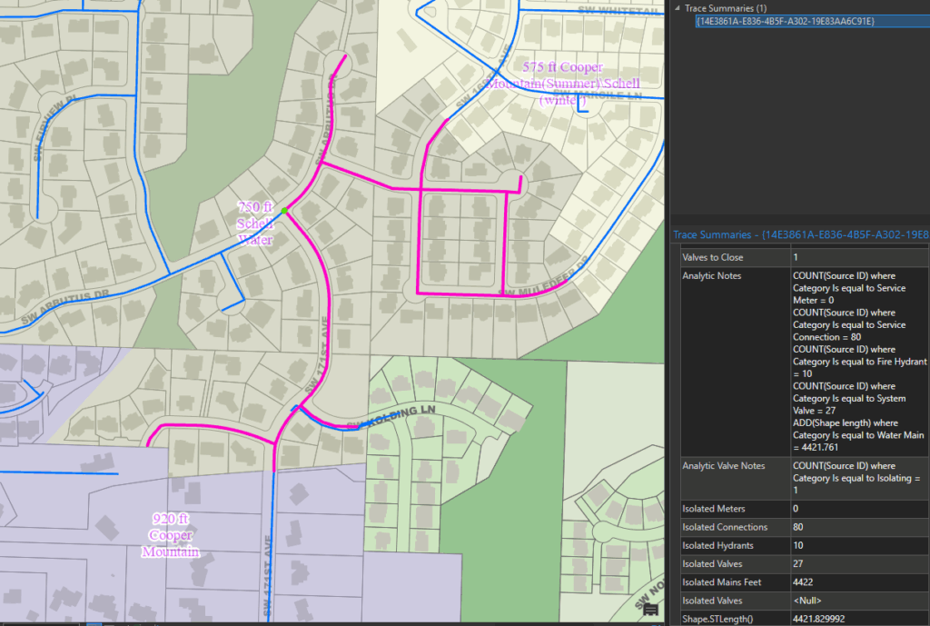

Single Feed Where One Valve Shuts Down Service to 80 Customers
“Our GIS team has always provided us with access to accurate mapping. We’ve been able to quickly identify which valves we need to close in response to a pipe break. We had an incident years ago that would have required a shutdown of nearly one mile of 24-inch main affecting nearly 800 customer connections. Luckily, our operators quickly devised several system manipulations that greatly reduced the size of the outage. Now, we’re able to find areas of our system that are susceptible to impacts like this and add valves or additional pipes to increase resiliency before an emergency occurs.” Pete Boone, TVWD’s Chief Operating Officer
