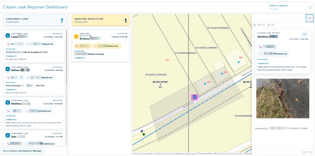

MAWC Citizen Leak Reporter Dashboard

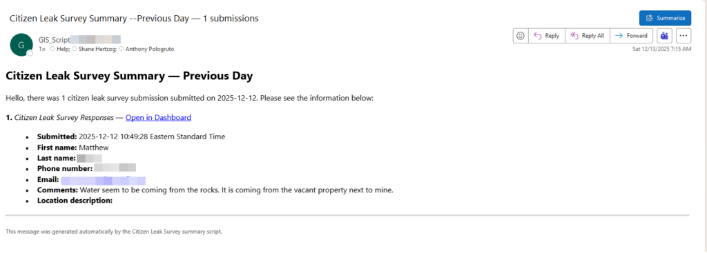

Using out-of-the-box Esri products including ArcGIS Survey123, ArcGIS Dashboards, and ArcGIS Field Maps, MAWC was able to publish a public-facing app that harnessed the power of the crowd to report and identify surface leaks. The app providing a mobile-friendly smart form that allowed the end user to pinpoint where they spotted the water and attach photos. Staff were then notified of the potential leaks via email using scripts. Within the email were the important details along with a link to a dashboard where staff could pan and zoom to the location. Field staff were then dispatched to investigate. Nearly 70 percent of citizen-reported leaks turned out to be true leaks on MAWC main lines.
MAWC Email Notification of Newly Submitted Leak

Simultaneously, another group of field staff were tasked with walking along a cross-country transmission main to look for visible leaks. To keep the crew on target, workers used the Field Maps app to see their location in respect to the water line. Starting at opposite ends of the line, two groups began surveying the line, looking for any surface water that could be the result of a leak. The accuracy of the app allowed the two groups to meet in the middle.
