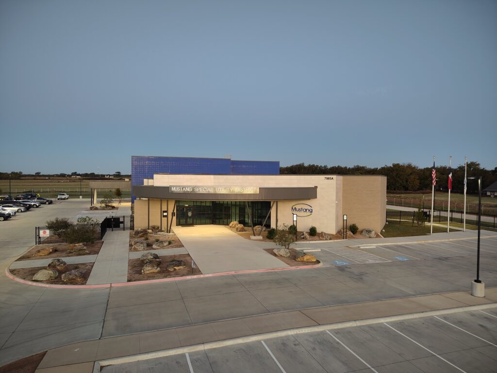

Mustang Water headquarters photographed on the MAX drone

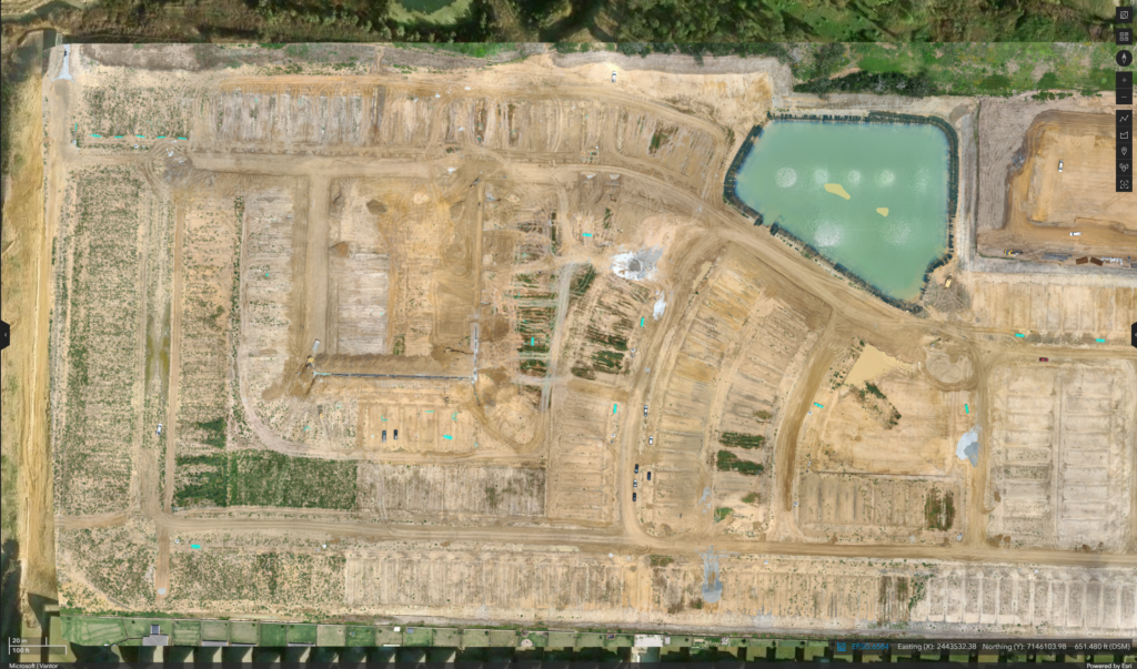

Aerial orthophoto of active construction site
When developers begin construction projects, Mustang SUD’s drone team is deployed to document site conditions and infrastructure installation activities. Drone imagery is brought into GIS, where staff compare current conditions against engineering plans and as-built drawings to ensure assets are being constructed correctly. The captured information is then shared across departments for review and decision-making.

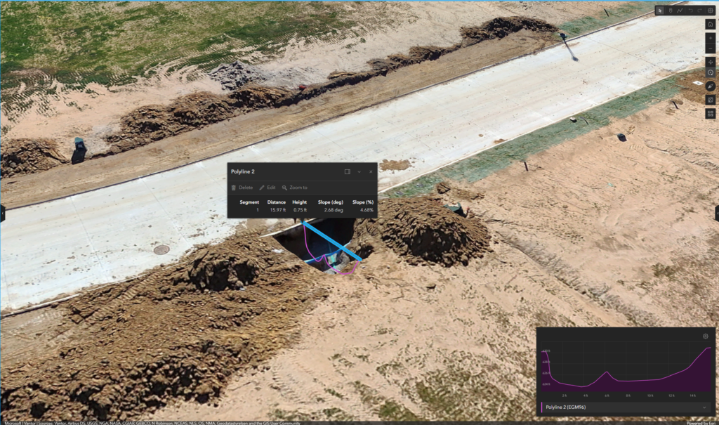

Drone imagery of an open trench allows for the creation of a trench profile

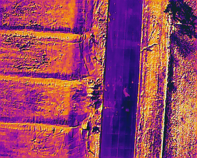

Mustang SUD is also using thermal drone technology to assist with leak detection. The utility currently uses thermal imagery to investigate water loss and identify potential leaks across its system and is exploring future applications to assist customers experiencing unusually high water bills.

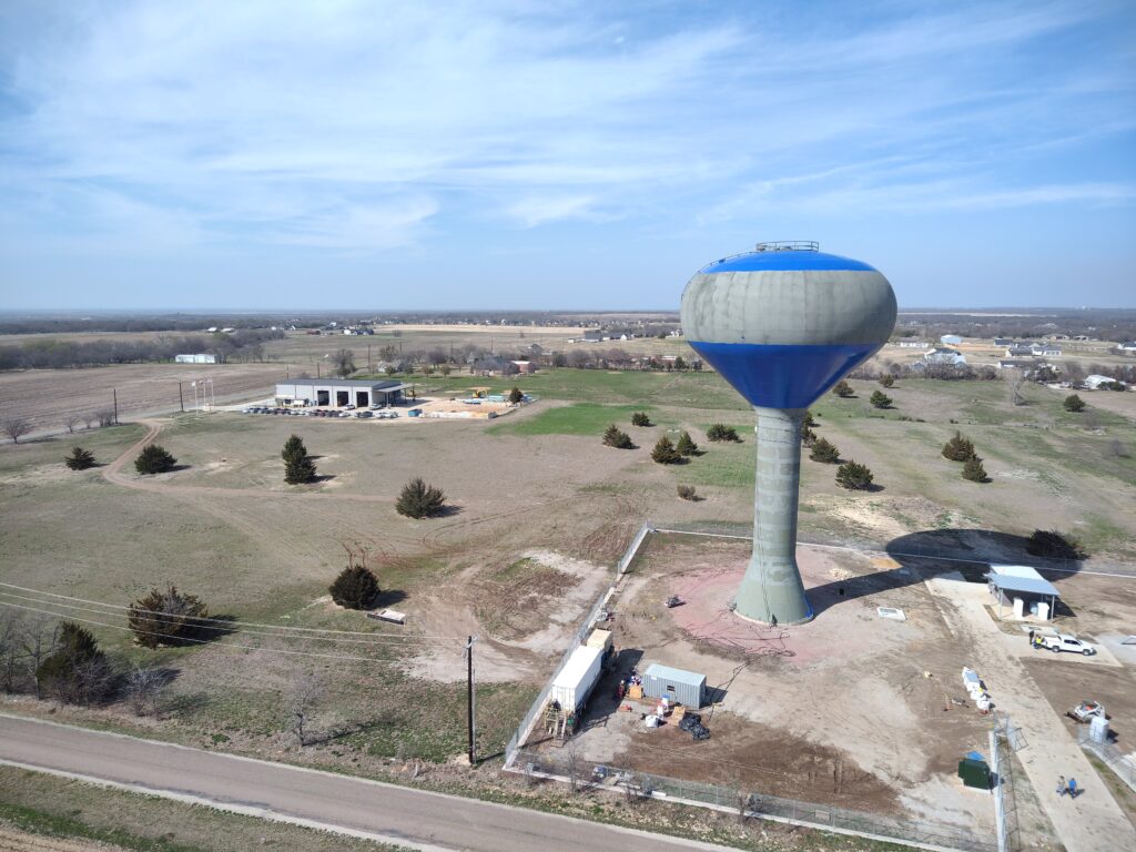

Utilizing the drone during active construction of a new water tower allows for real time assessment of construction progress
