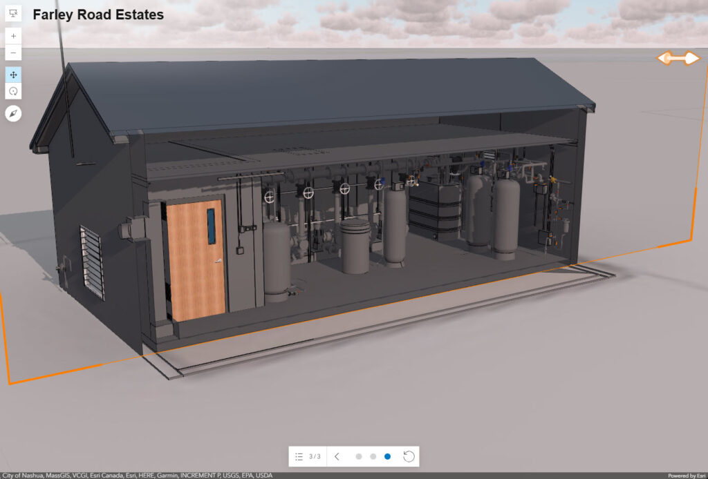

Pennichuck launched a pilot project to explore the role of digital twins in facilities management. The effort focused on three key sites: a pump station, a booster station, and the finish water pumping station at the main treatment plant. The workflow followed a structured but adaptable path:

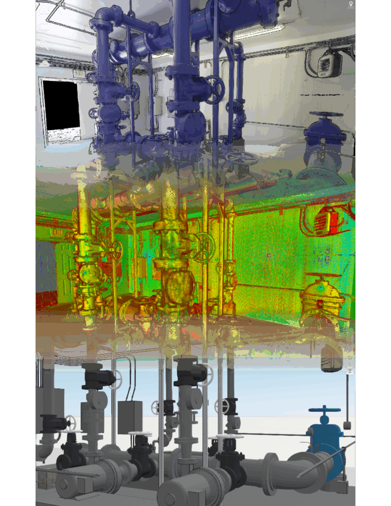

Using a Leica RTC360 laser scanner, LandTech captured each site at 2mm accuracy, with the added benefit of 360-degree imagery. The scanner’s speed, just one to two minutes per scan, enabled the team to complete the main treatment plant in a week, while both smaller stations were scanned in less than a day.
Phase 2 – Model
The scan data was converted into highly accurate 3D models. Water process devices were modeled at Level of Development (LOD) 350, providing detail sufficient for precise identification and operational context. Structural elements were modeled at LOD 200, balancing accuracy with efficiency.
Phase 3 – GIS Conversion
The models were transformed into GIS-ready formats, including building scene layer packages, web scene layers, and derivative 3D point features. A critical step in this phase was Pennichuck staff participation in asset identification within the models, a painstaking but essential process that enabled interactivity and ensured the GIS environment reflected real-world conditions.

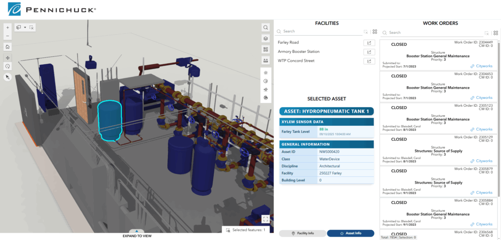

The interactive models were deployed through a browser-based application built with ArcGIS Experience Builder. Customization leveraged ArcGIS Arcade expressions and Python scripts to create a seamless experience. Staff could explore facilities in 3D, visualize inspections and work orders directly in the scene, and launch into existing systems with a single click—including linking to mobile applications for work order management.

Data integration was designed to maximize visibility and ease of use while minimizing complexity. Asset management data was connected via web services, operational data was integrated through APIs, and deep links enabled smooth navigation between applications. Python routines supported real-time and historical data polling, writing results into hosted tables for use within the app.
Screenshot of ArcGIS Experience Builder Application with Interactive 3D Scene, Asset Data, and List of Work Orders

The response from staff was immediate. Seeing familiar facilities in realistic 3D detail was exciting, but what truly resonated was the usability. Staff valued being able to see multiple systems together in one spatial view, without needing to toggle between platforms.
For operators, the workflow felt familiar: Visualize a work order in context, then click directly into the work order system. This mirrored the field workflows already established for distribution assets, making adoption natural and seamless.
“By integrating the 3D models with our CMMS, an operator can stand in front of any asset in any station and instantaneously pull up maintenance history on that exact pump. No searching. No phone calls. I’m excited to continue integrating the digital twins into our evolving asset management program.”
