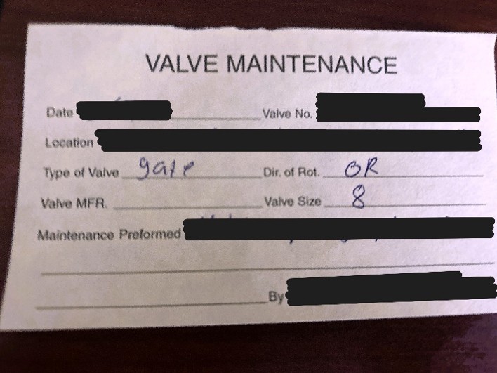

A prime example of this utilization can be demonstrated with Pueblo Water’s Valve Exercising Program. There are 15,118 valves across 73 square miles of service area that must be exercised (turned) annually. Pueblo Water’s previous workflow of recording and quantifying the number of valves exercised was done manually on valve cards with limited GIS use. It was challenging for staff to monitor what work was being completed out in the field.
Pueblo Water needed a better way to track valves turned, streamline workflows, and improve understanding of the status and condition of each valve.
Example of a valve maintenance card used by crews to log work.

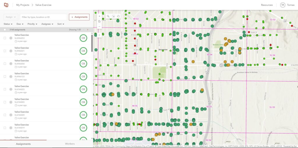

ArcGIS Workforce dispatcher map example with valves being written from ArcGIS Utility Network with prototype valve status showing as small red circles.

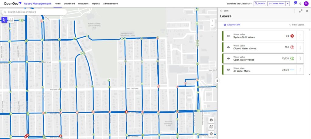

Live map showing status of valves.
Esri’s ArcGIS Utility Network is great for mapping assets; OpenGov solutions enhance asset management planning and dispatching work. When combined, the two systems produce a useful map with detailed asset information that is user-friendly and packed with information.

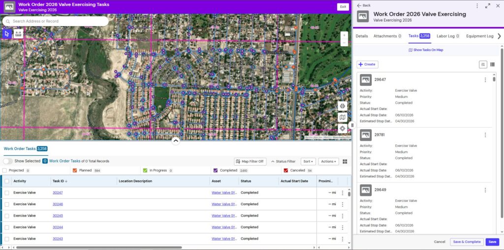

OpenGov Valve Work Order showing task list and status of each assigned task. Purple dots are completed and orange dots are planned for a future date.
