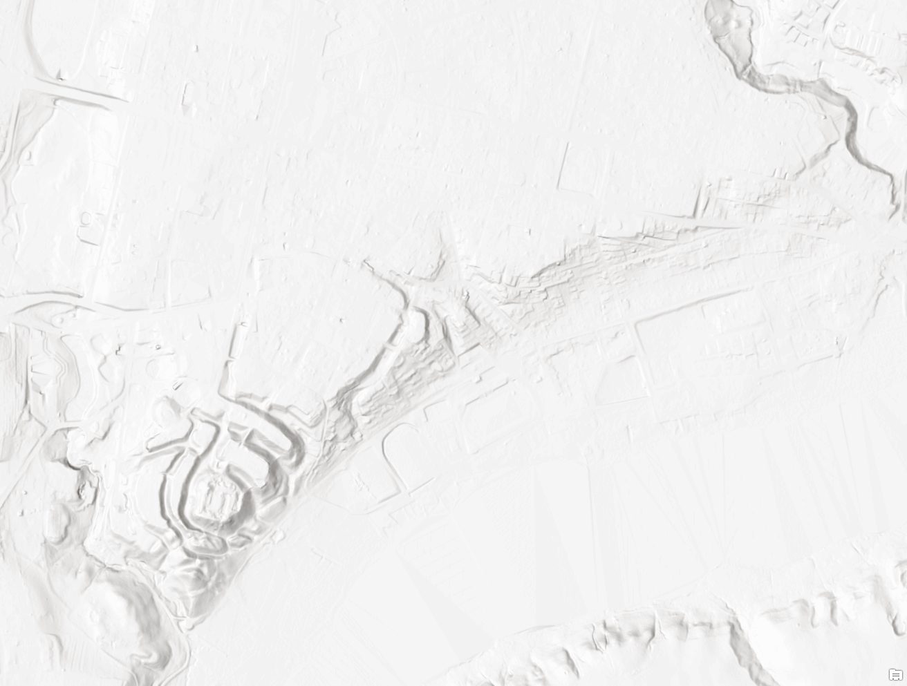

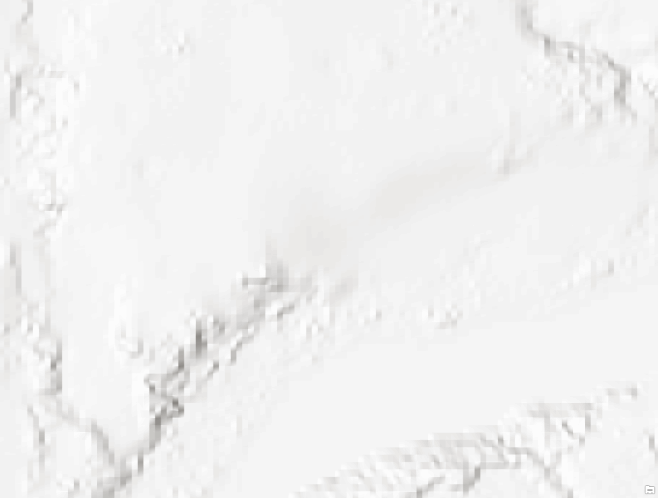

Vijandi, Estonia – fine details depicted with 1 m lidar DTM (bottom) in urban area over WorldDEM4Ortho 24 m (top)
Vijandi, Estonia 24m WorldDEM4Ortho
Vijandi, Estonia 1m Lidar

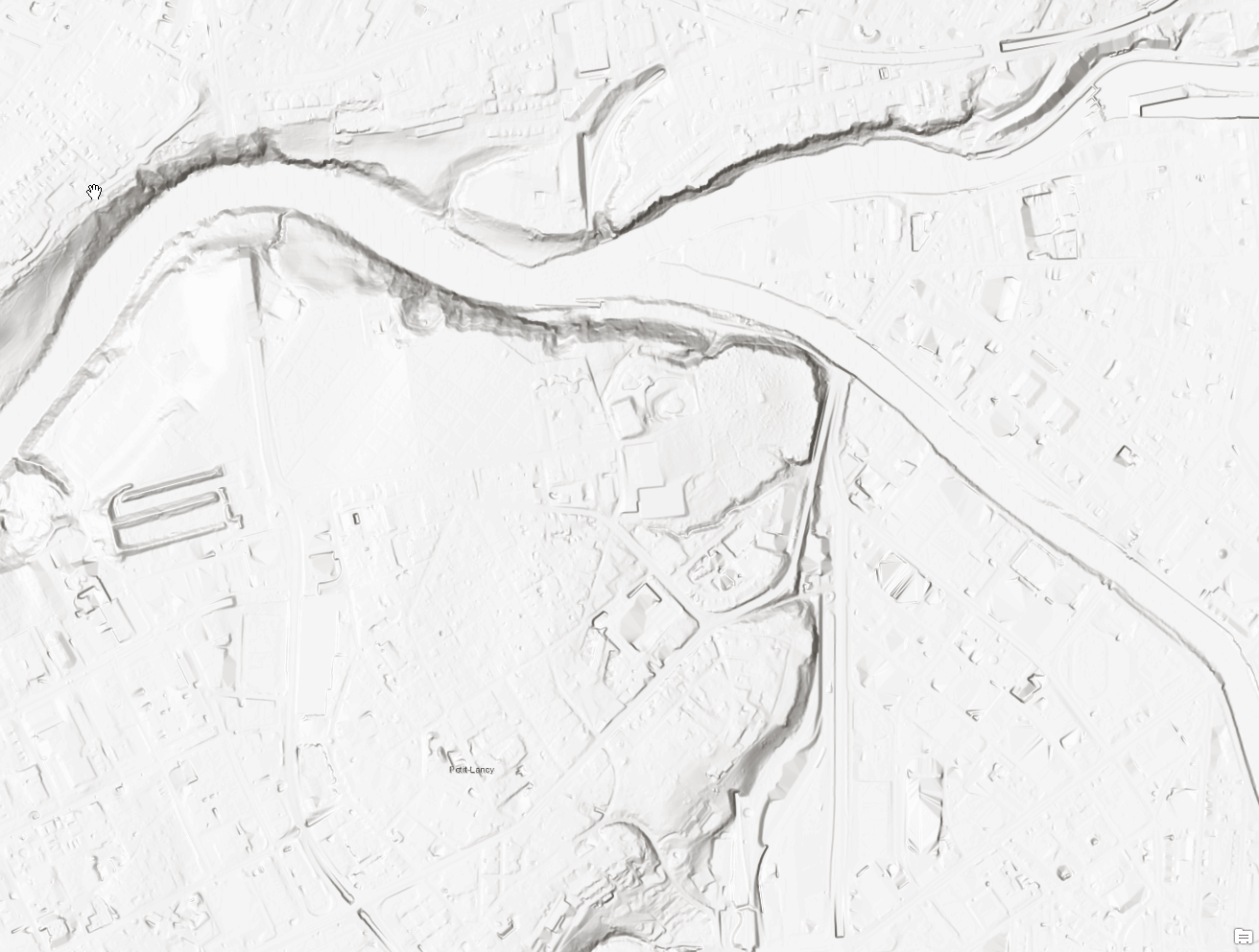

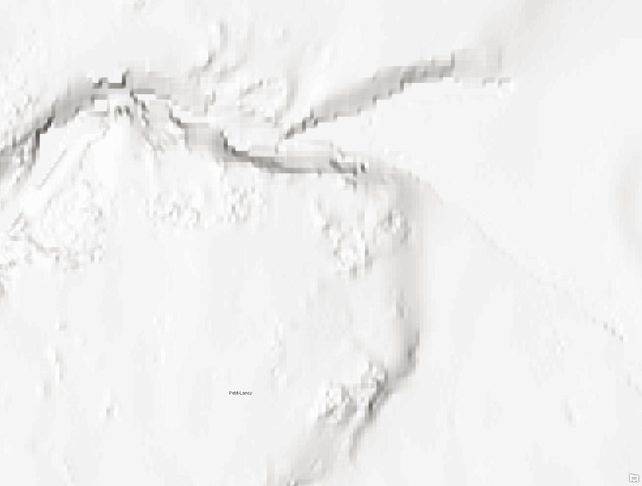

Geneva, Switzerland – fine details depicted with 50 cm lidar DTM (bottom) in city over WorldDEM4Ortho 24 m (top)
Geneva, Switzerland 24m WorldDEM4Ortho
Geneva, Switzerland 50cm Lidar

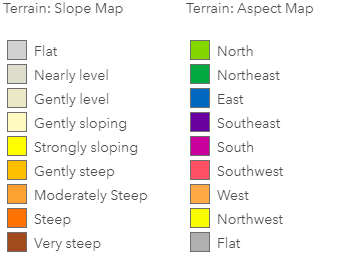

In this release, Slope Map and Aspect Map functions are enhanced to return class values and descriptions with legend instead of 3 band RGB values. This enhancement will also allow you to change the pre-defined symbology from client side (desktop or AGOL).
Slope and Aspect Map Legend
