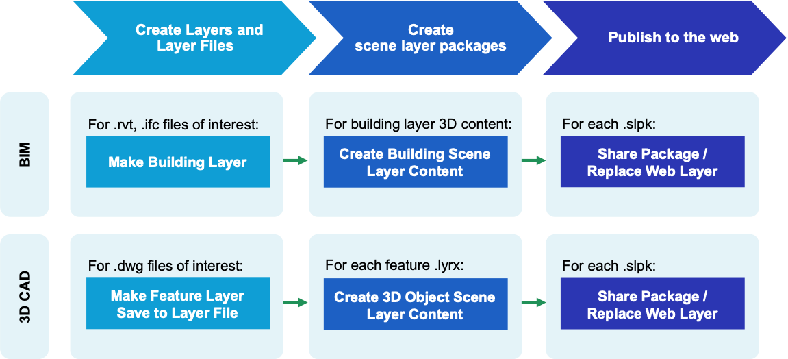

A high-level flowchart showing three main steps for creating and publishing content from CAD and BIM files.
An illustrative workflow for creating scene layer packages from 3D CAD and BIM content, and then publishing as scene layer (hosted).
1. Represent CAD and BIM data as spatial features. For example, run Make Feature Layer and Save To Layer File for the rail corridor objects stored in the Civil 3D files. For BIM files, run Make Building Layer to create building layers.
2. Whether created from one or several engineering files, package data into scene layer packages (.slpk files). For BIM datasets, this creates composite layers that organize design and engineering data as spatial features by discipline. Package 3D CAD content into 3D object scene layer packages.
3. After creating scene layer packages, publish them for efficient web streaming.

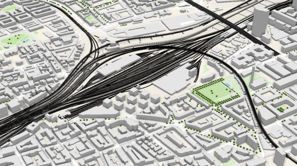

A 3D model with CAD, BIM, and GIS data illustrating a complex arrangement of railway track network in an urban setting.
Visualize, analyze, and share the transportation network scene using ArcGIS Pro.

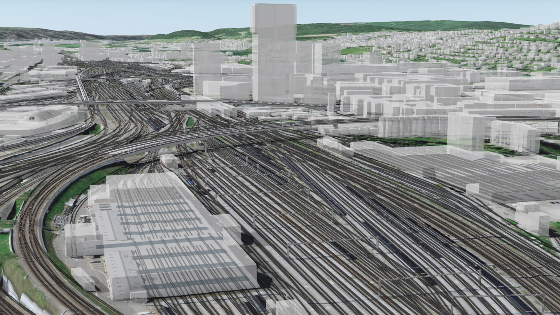

Automated publishing steps better enable stakeholders to coordinate in context on the latest design for the railway track segment.
