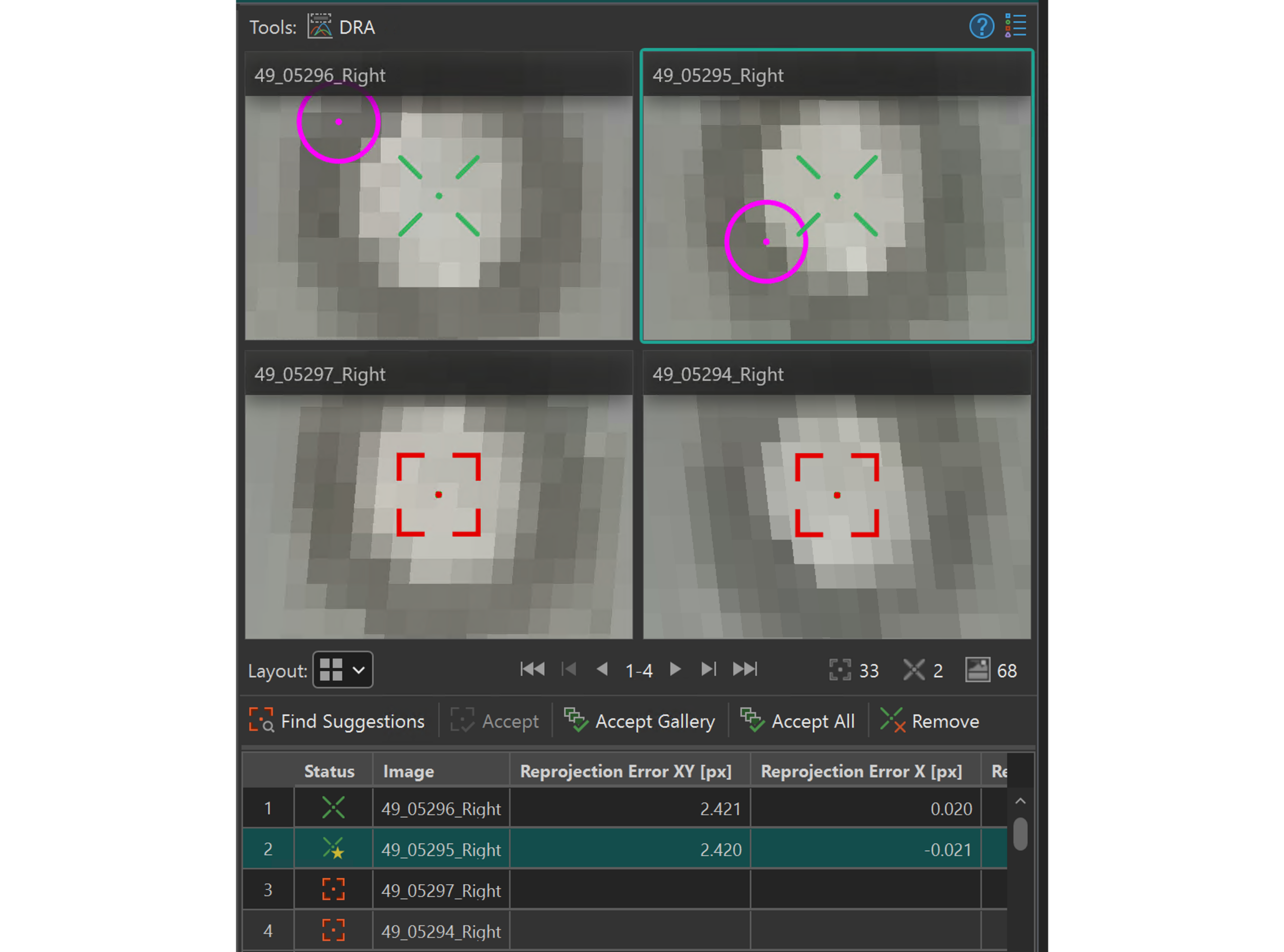

To support this, the Image Measurement Tool in ArcGIS Reality Studio provides point suggestions. After measuring a point in two or more images, the tool suggests its location in additional images. This reduces the need for manual search and speeds up the process significantly.
Performing an initial alignment in advance enhances both the quantity and reliability of point suggestions, as the optimized camera positions provide a stronger foundation for accurate predictions.
Point suggestions (red marker) in the Image Measurement Tool in ArcGIS Reality Studio

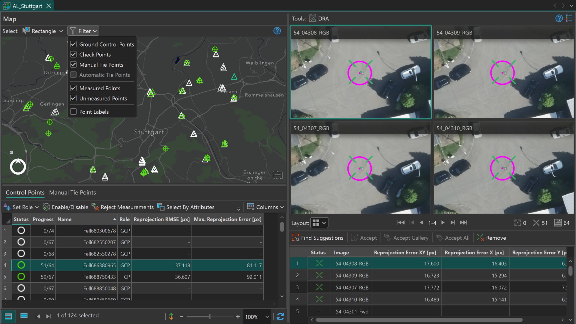

The Image Measurement Tool introduces a map-centric approach that helps you do exactly that.

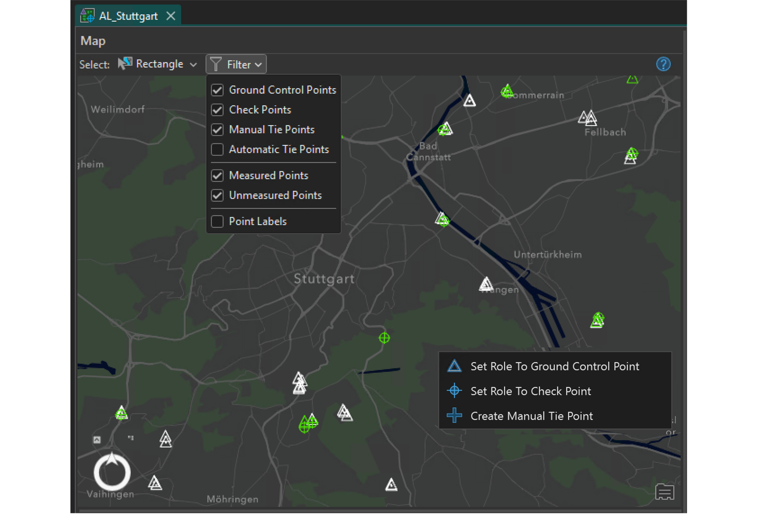

From the map view, you can select, filter, and create points directly within the project area. Once a point is selected, you can immediately measure it in the images. This connection between map and image space helps you quickly decide where additional measurements are needed. The map centric user interface helps to achieve a good spatial coverage across the entire project while keeping the measurement process efficient.
Filtering options support a quick assessment of how ground control points and check points are distributed. A well-balanced set of ground control points contributes to stable georeferencing, while evenly distributed check points allow for meaningful accuracy evaluation across the full extent of the dataset.

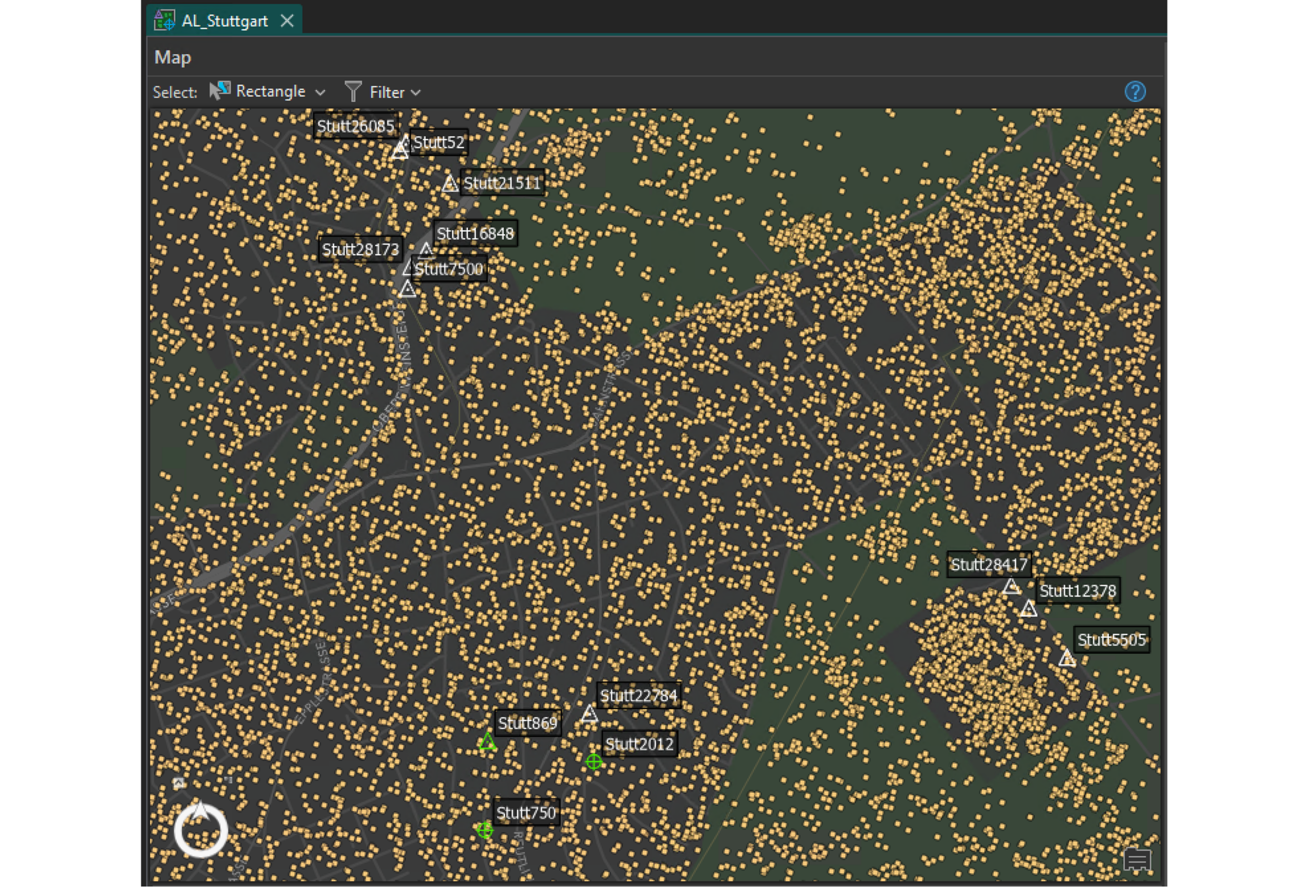

The Map of the Image Measurement Tool offers functionalities to filter, select, create and define the role of points on a common base map
By visualizing the automatic tie points generated during the Alignment, the map also helps identify areas with weak connection. In such regions, you can create manual tie points – points without known field coordinates – that strengthen the block by adding image observations where automatic tie points are sparse.
Visualization of Automatic Tie Points, along with ground control points and check points in the Image Measurement Tool Map

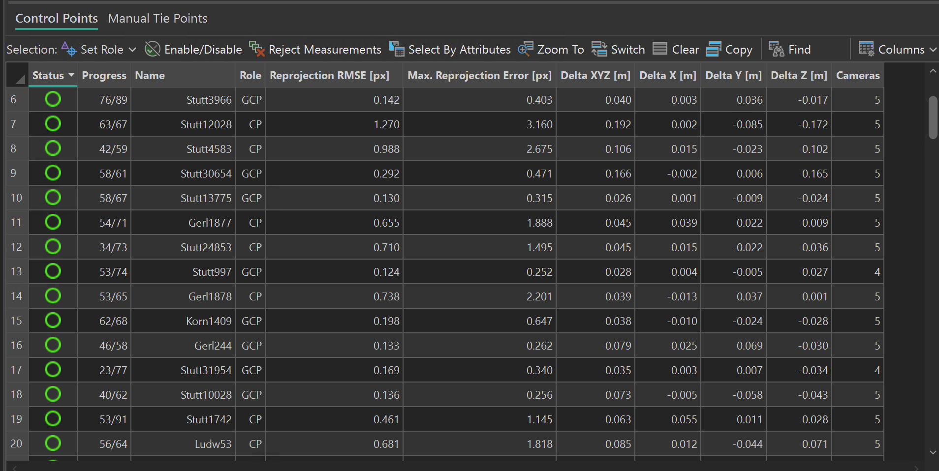

Points’ measurement quality and distribution directly influence the accuracy of the alignment and of the derived final outputs. Understanding and interpreting this quality is therefore an important step in the workflow.
The Image Measurement Tool provides these indicators to identify inconsistencies or gaps in the dataset and guide further refinement:
  • Reprojection error describes how well a 3D point fits its observed image positions. It is calculated as the difference between the measured pixel location and the projected position of the reconstructed 3D point back into the image. Higher values (e.g. above 2 pixels) often indicate inconsistent or imprecise image measurements.
  • 3D residuals represent the difference between the known real-world coordinates of a point and its estimated position after adjustment. They provide a direct measure of positional accuracy in object space.
  • Point distribution on the map reflects how well ground control points and check points are spread across the project area. A balanced distribution is essential for a stable and reliable solution.
 A high reprojection error may suggest revisiting image measurements for that point, while large 3D residuals can indicate issues with point accuracy. An uneven spatial distribution of points may highlight areas where additional control points or manual tie points are needed to stabilize the solution.
Control points table in the Image Measurement Tool to evaluate quality parameters for informed decision making of next fine-tuning steps
