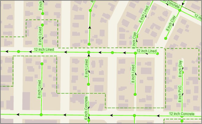

Legacy and new—ArcGIS Utility Network allows the city’s sanitary sewer network to be visualized in a manner consistent with existing drafting standards while enabling significant improvements in the underlying data model and business processes.

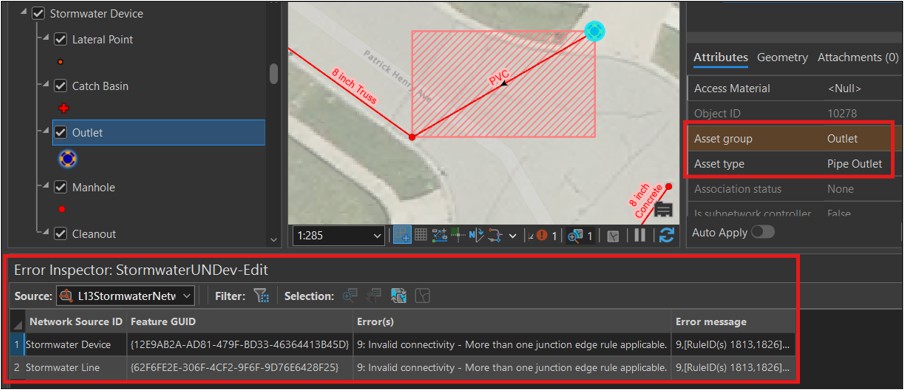

Validation within ArcGIS Utility Network allows errors to be recognized immediately. In this stormwater example, an outlet device has been placed in a location that violates network rules and is automatically flagged for correction.
The ArcGIS Utility Network validation framework has also improved data quality and operational confidence. Editors receive immediate feedback when network rules are violated, allowing issues to be corrected before they become part of the production system. For example, the system can automatically identify invalid asset relationships that previously may have gone unnoticed.

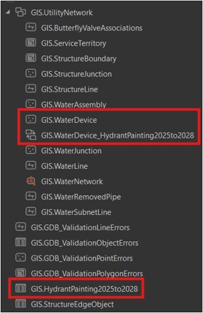

Previously, hydrant maintenance relied on exported GIS snapshots. With ArcGIS Utility Network, branch versioning and related table workflows enable seamless integration between field inspections and GIS records, improving data accuracy and operational efficiency.
The city has also improved integration between GIS and field operations. Previously, hydrant maintenance data relied on exported snapshots of GIS information. Today, branch versioning and related table workflows support more seamless integration between field inspections and GIS records, helping ensure that operational data remains current and accessible.
