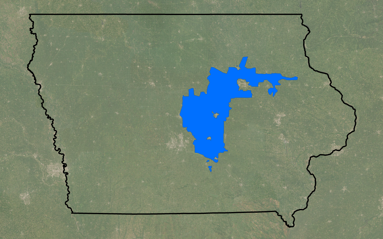

To support this geographically expansive system, IRUA modernized its mapping and asset management workflows using Esri’s ArcGIS platform. What began as a project focused solely on migration from legacy AutoCAD paper drawings to digital maps, evolved into a full transformation to ArcGIS Enterprise in the Amazon Web Services (AWS) Cloud that now serves as the organization’s authoritative source of truth for water and sewer infrastructure, along with utilizing the GIS platform in other areas of the organization, like land rights document management and customer service information.
IRUA service territory located in Central Iowa, United States

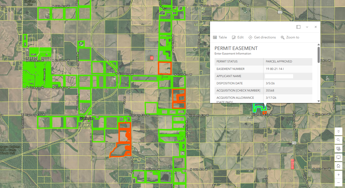

Permitting workflows faced similar inefficiencies. Easement records were stored in filing cabinets, making retrieval slow and requiring staff to contact other offices to verify documentation or status. New construction updates could also take months to appear on paper maps, limiting visibility into recently installed assets and increasing the risk of using outdated information in the field.

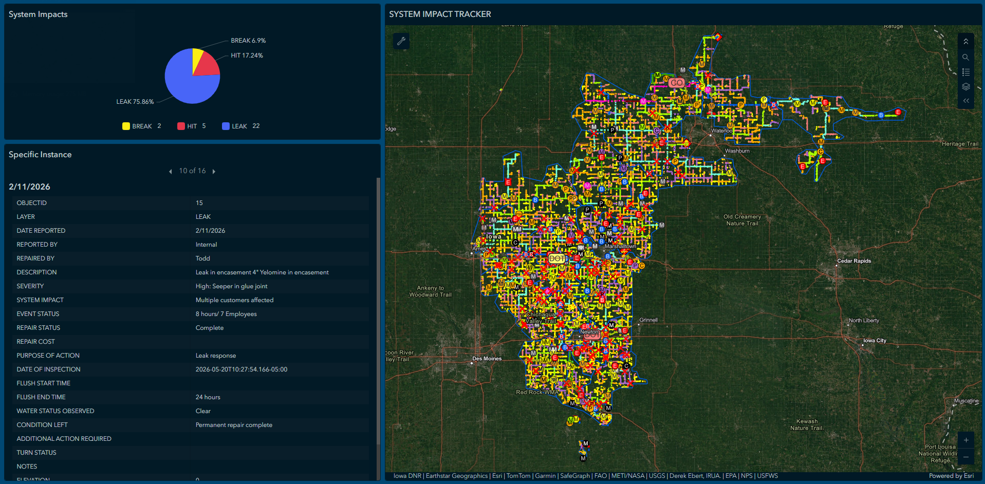

Dashboard tracker for system leaks, breaks, and hits

IRUA permitting department map highlighting an easement with pop-up attribute
