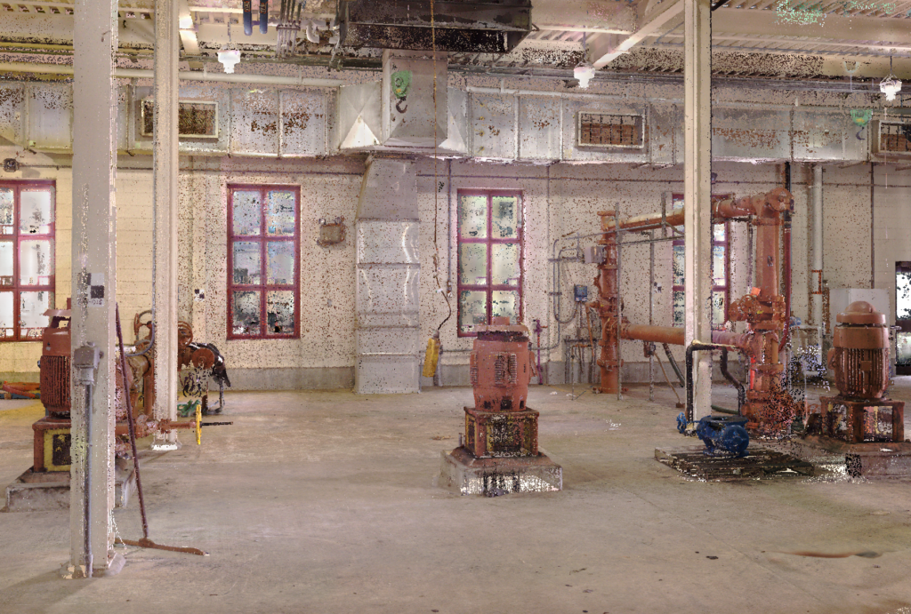

Point Cloud Rendering of the First Floor in the Equalization and Blending Building

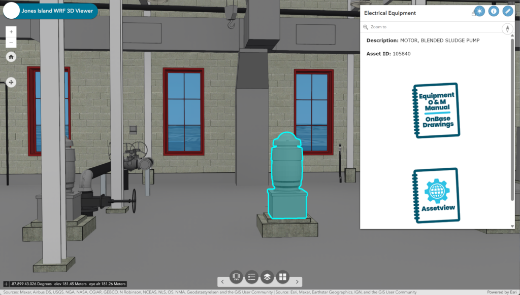

Custom pop-ups are configured to link vertical assets (3D objects) to different internal systems of record. These include document management repositories (OnBase) for 2D construction and as-built drawings, as well as operation manuals. The pop-ups also link to asset management records (BI-Cycle) and Microsoft SharePoint. MMSD uses custom expressions and thumbnail graphics to link assets based on a unique Asset ID. Finally, staff publishes a web scene with a building scene layer to MMSD’s internal ArcGIS Enterprise portal. By combining multiple web scenes, MMSD configures BIM 3D viewer solutions for each WRF.
Staff feedback was instrumental to the user experience design of the BIM 3D viewer solutions. Users preferred preset bookmarks to quickly navigate to different positions inside buildings and underground galleries. Dockable information pop-ups allow users to easily view asset information and links to related system applications. The Building Explorer widget enables users to filter the model to specific disciplines such as electrical or piping, providing an isolated view of assets in those categories. Together, the Scene Viewer tools and widgets support MMSD’s BIM Vision objectives.

3D Scene Viewer Application Displaying Motor Equipment with Links to Related System Information
