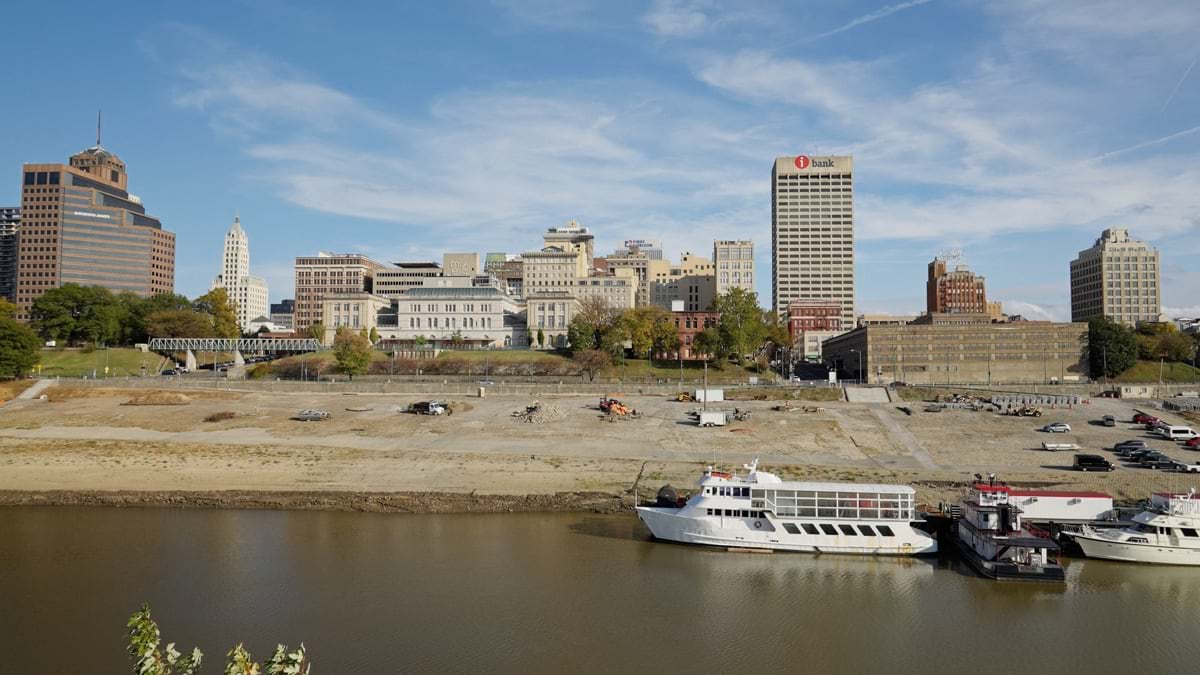

In 2019, record precipitation kept the river above flood stage for more than 235 days. Then in summer 2022, water levels fell 11 feet below average due to protracted drought. Low levels caused barges to run aground and forced vessels to carry less cargo. Trucks had to take on loads in some spots. As freight costs rose, difficulties moving goods to market drove down the domestic price of grain and farmers faced losses.

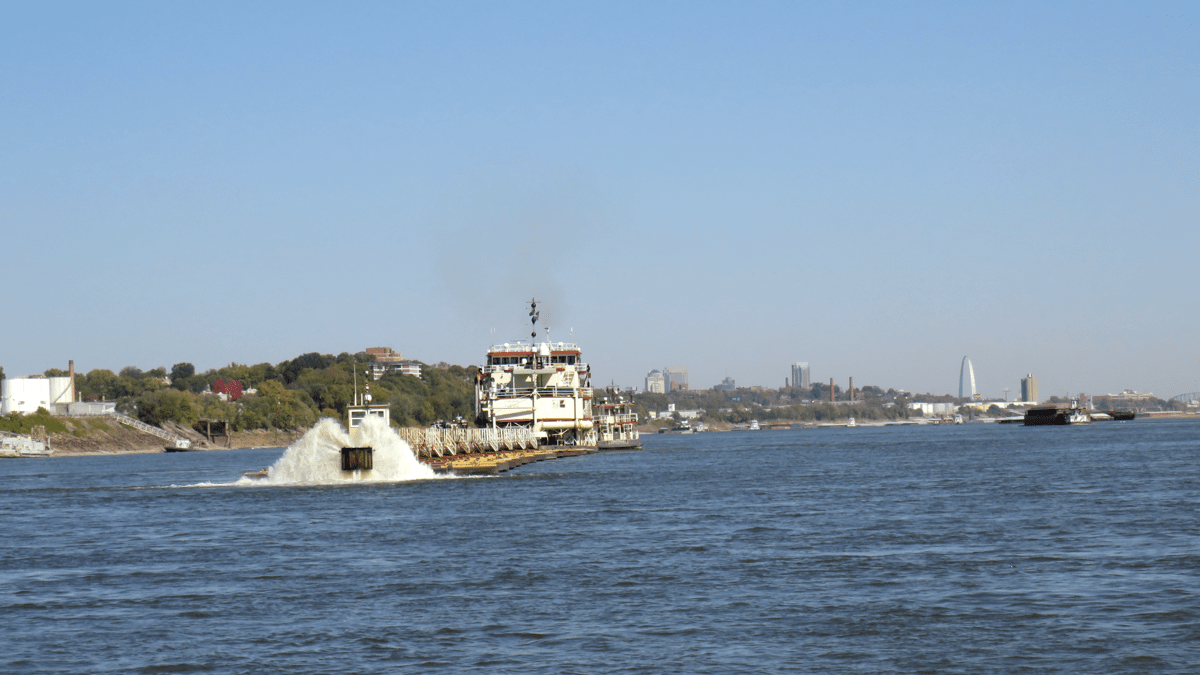

To help keep barge traffic and commerce flowing, the US Army Corps of Engineers directed crews to dredge the river around the clock. For six straight months they worked to maintain the nine-foot-deep channels barges require. They managed this endeavor—keeping an eye on river conditions, operations, and vessel traffic—using geographic information system (GIS) technology.

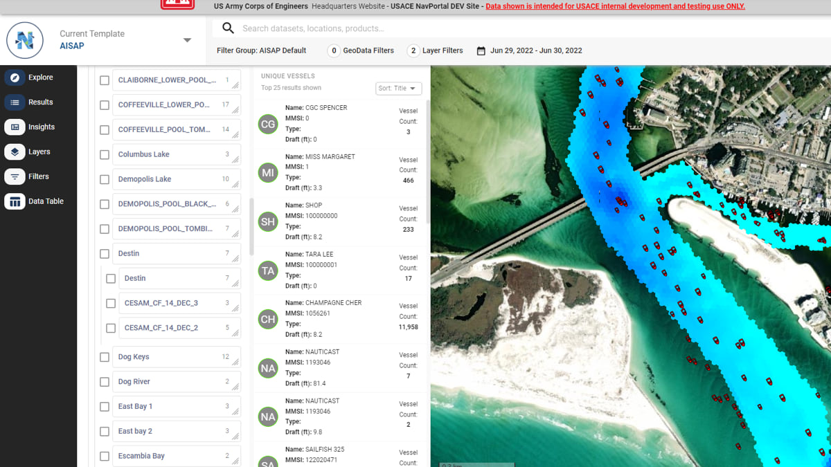

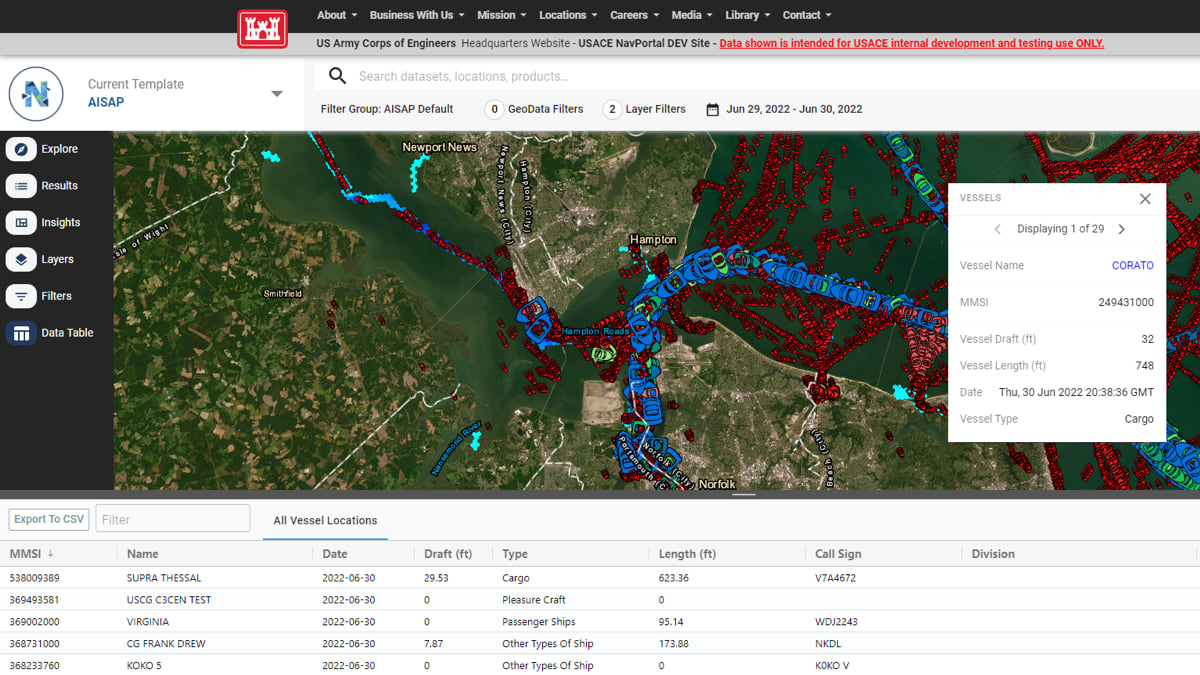

To monitor this work, the corps uses many purpose-built GIS-powered systems (see sidebar) that monitor conditions and analyze vessel traffic. A new navigation portal, NavPortal, combines these data inputs to provide an operations-wide digital twin. NavPortal combines cloud computing, ship tracking, and artificial intelligence to process and present huge volumes of data. It shows current channel conditions and compares that information to river traffic.
“We’ve got hundreds of dredge locations nationwide, and we need a tool like NavPortal to be our early-warning indicator,” said Ned Mitchell, a research civil engineer at the US Army Engineer Research and Development Center and NavPortal product manager. “We need to see the worst trouble spots forming before they become full-blown emergencies.”

Now, NavPortal provides clarity. It affords each corps district a current view of its stretch along with the entire river. When there’s little time to gather data and conduct in-depth analysis, NavPortal delivers ongoing awareness. It empowers staff to identify problems and plan fixes before channels clog.

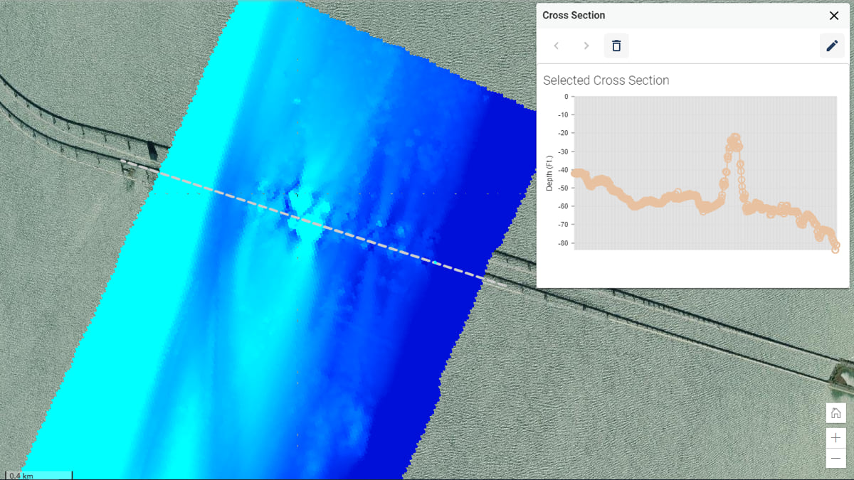

The corps’ project engineers have a tough job to understand channel depths and sediment buildup. In the midst of drought, for instance, intermittent rains can make any stretch of the river viable for barges one day and impassible the next. “Trying to chase the bottlenecks in a system like that is a real challenge,” Mitchell said.

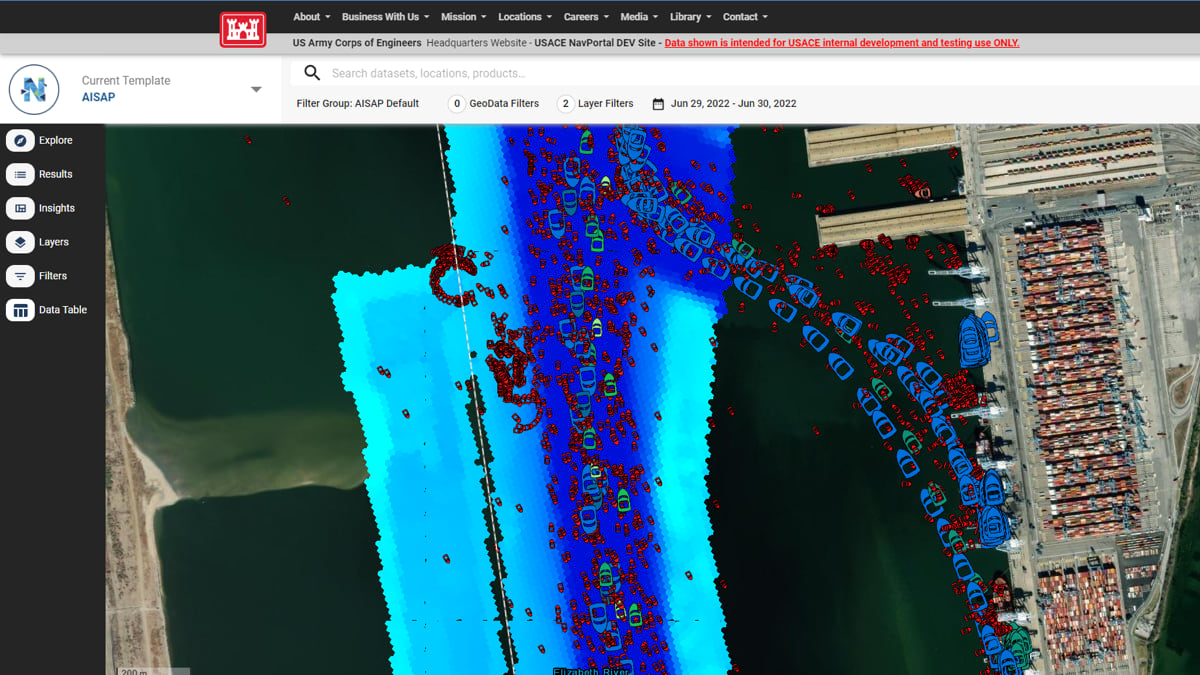

The portal’s mix of map visualizations, charts, and graphs provide a holistic view of navigation projects and alternatives. “The idea is to make all the data accessible and understandable,” said Josh Pritchard, a GIS and NavPortal manager for the USACE Mobile, Alabama district office.
This comprehensive resource proves crucial as channel blockages can multiply quickly, with one or two choke points turning into dozens across many states. It gives engineers insight into current and historical patterns, plus predictions about what’s likely to happen.
“NavPortal lets us see trends through time,” Mitchell said. “We can plot time series charts at particular locations where we’ve seen trouble before. And we can anticipate seasonal shoaling events that tend to create trouble.”
