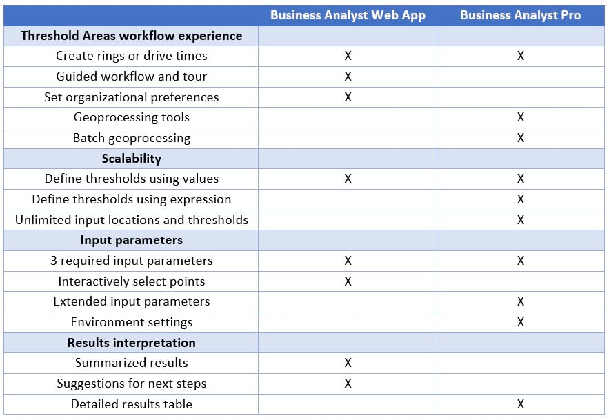

The table below highlights each application’s features and can help when choosing which Business Analyst solution to use for creating threshold areas. These aspects are discussed in more detail in the sections that follow.
Comparison chart of BA Web and BA Pro

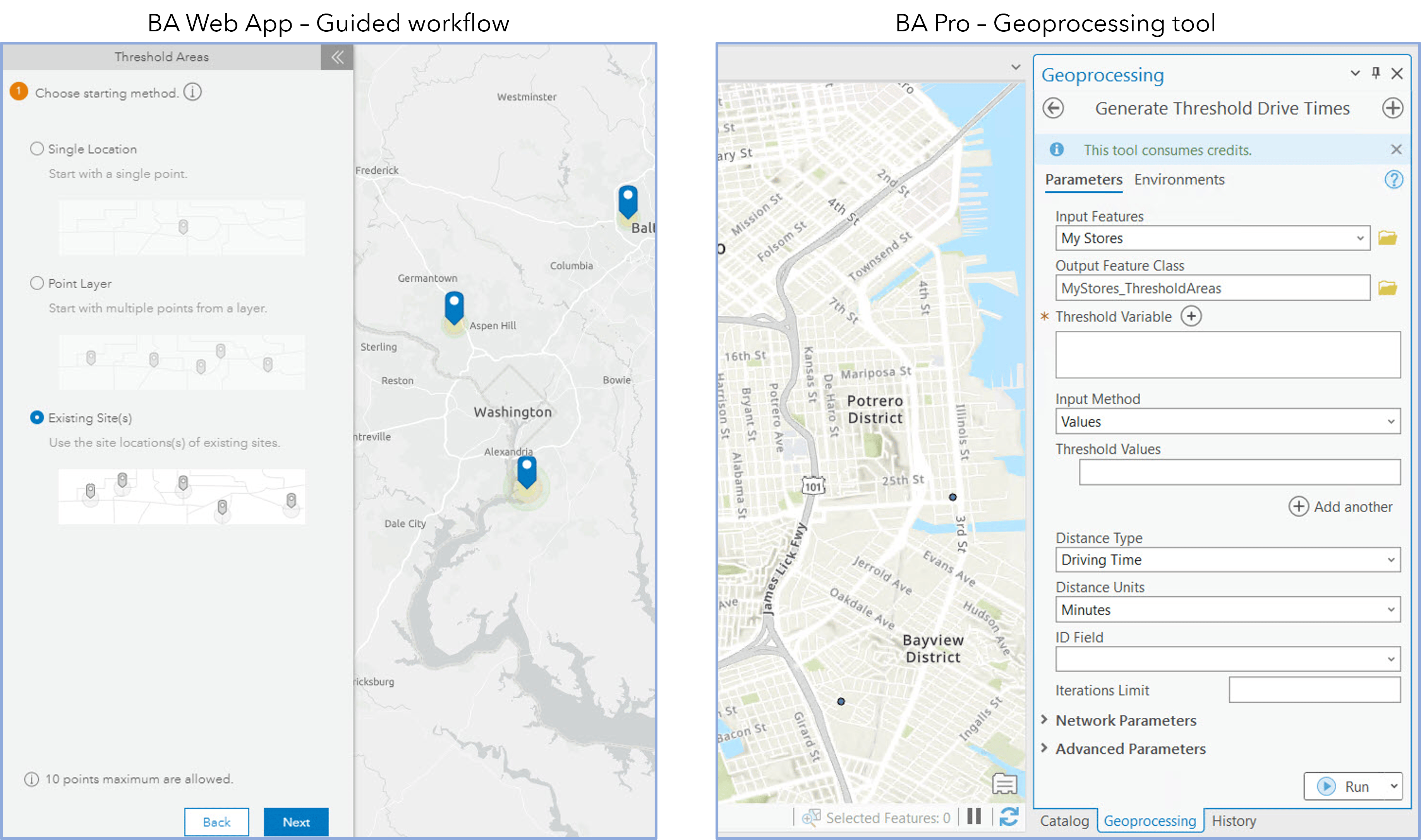

Thinking about the type of user experience that best fits your working style can help in deciding which Business Analyst application to leverage for creating threshold areas. Business Analyst Web App uses a guided workflow experience, including step-by-step instructions with preselected values to help you understand the required inputs. You can also customize the workflow experience by using the app preferences to set the preselected values and settings for a single user or for your entire organization. Business Analyst Web App also has a guided tour to help familiarize you with the workflow, walking you through the process of determining a drive-time service area that has a population of 100,000 people.
With Business Analyst Pro, you can access the Threshold Areas workflow through two different geoprocessing tools, Generate Threshold Rings and Generate Threshold Drive Times. When working with geoprocessing tools, the input parameters are entered all at one time and then the tool executes the analysis. These geoprocessing tools offer powerful options for batch execution and automation to support larger scale or repetitive projects.
Depending on your preferred experience, one application may be more suitable for you than the other. For example, both applications require point locations that can be defined using a layer of points or by selecting individual points. An additional option is provided through Business Analyst Web App, where you can interactively place a point on the map using a single click, search for an address or coordinates, or select from sites stored in projects. With the threshold areas tools available in Business Analyst Pro, an existing point layer must be used to define the point locations.
Workflow style for threshold areas - BA Web vs BA Pro

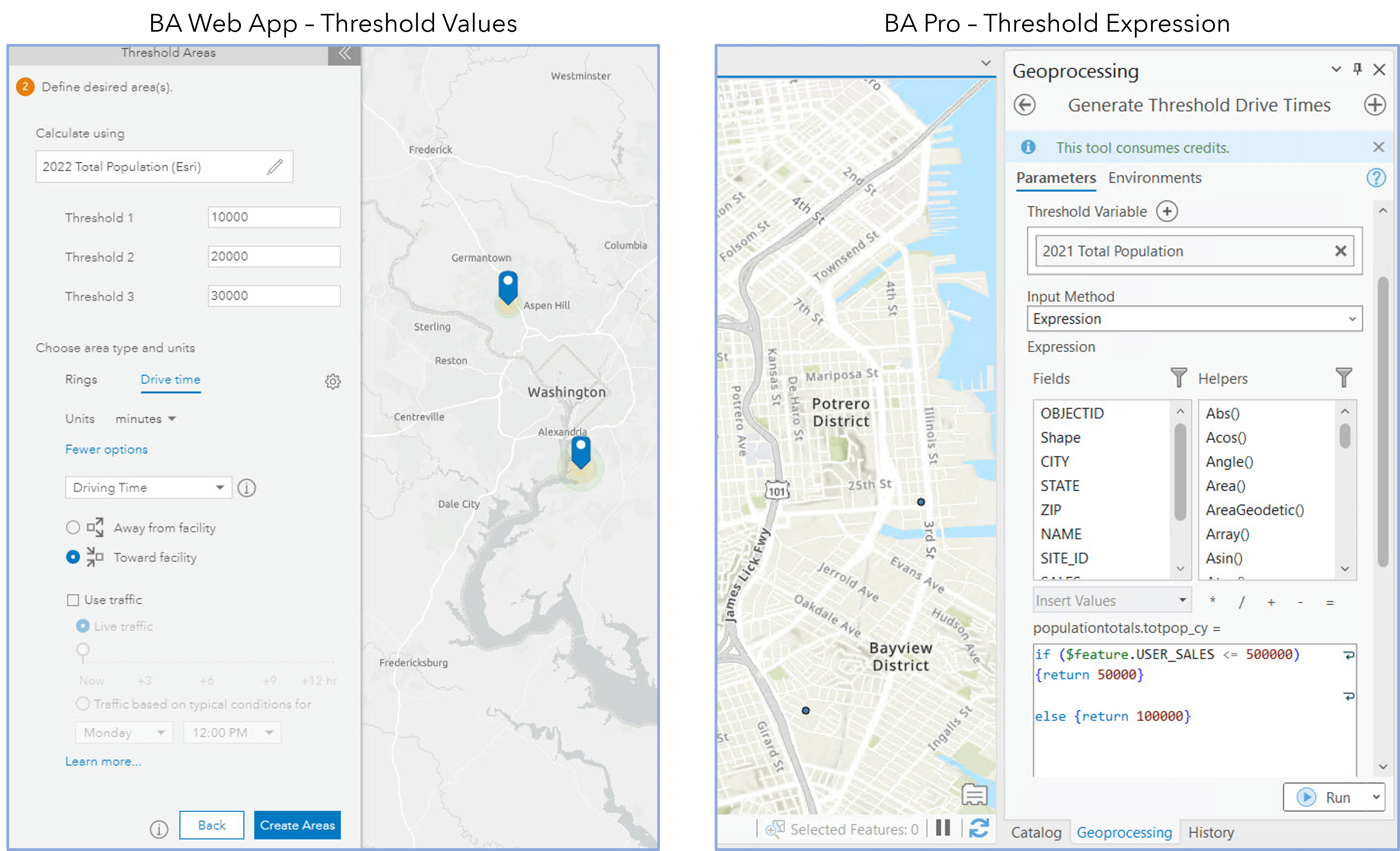

Understanding the scope of your needs can help you evaluate whether Business Analyst Pro or Business Analyst Web App will be more suitable for creating threshold areas. Business Analyst Web App is available through ArcGIS Online, where the workflow is driven by services hosted in the web environment. To ensure efficient performance, you can define a maximum of ten point locations and three threshold values when creating threshold areas in Business Analyst Web App.
Business Analyst Pro is available through the local desktop environment, which allows for defining a larger number of input point locations and threshold values. Business Analyst Pro provides more flexibility for working with large-scale analysis; for example, creating threshold areas all over the country rather than just in one region. Additionally, Business Analyst Pro provides the option to define threshold values conditionally by using an expression or a field from the input point layer. Selecting Expression as the Input Method is useful for applying trade areas of different sizes to your points, whereas selecting Values as the Input Method applies areas of the same size to all input points. For example, you can use an expression to assign different threshold values to store locations that are in a single layer, based on the sales for a particular location.
Threshold types - BA Web vs BA Pro

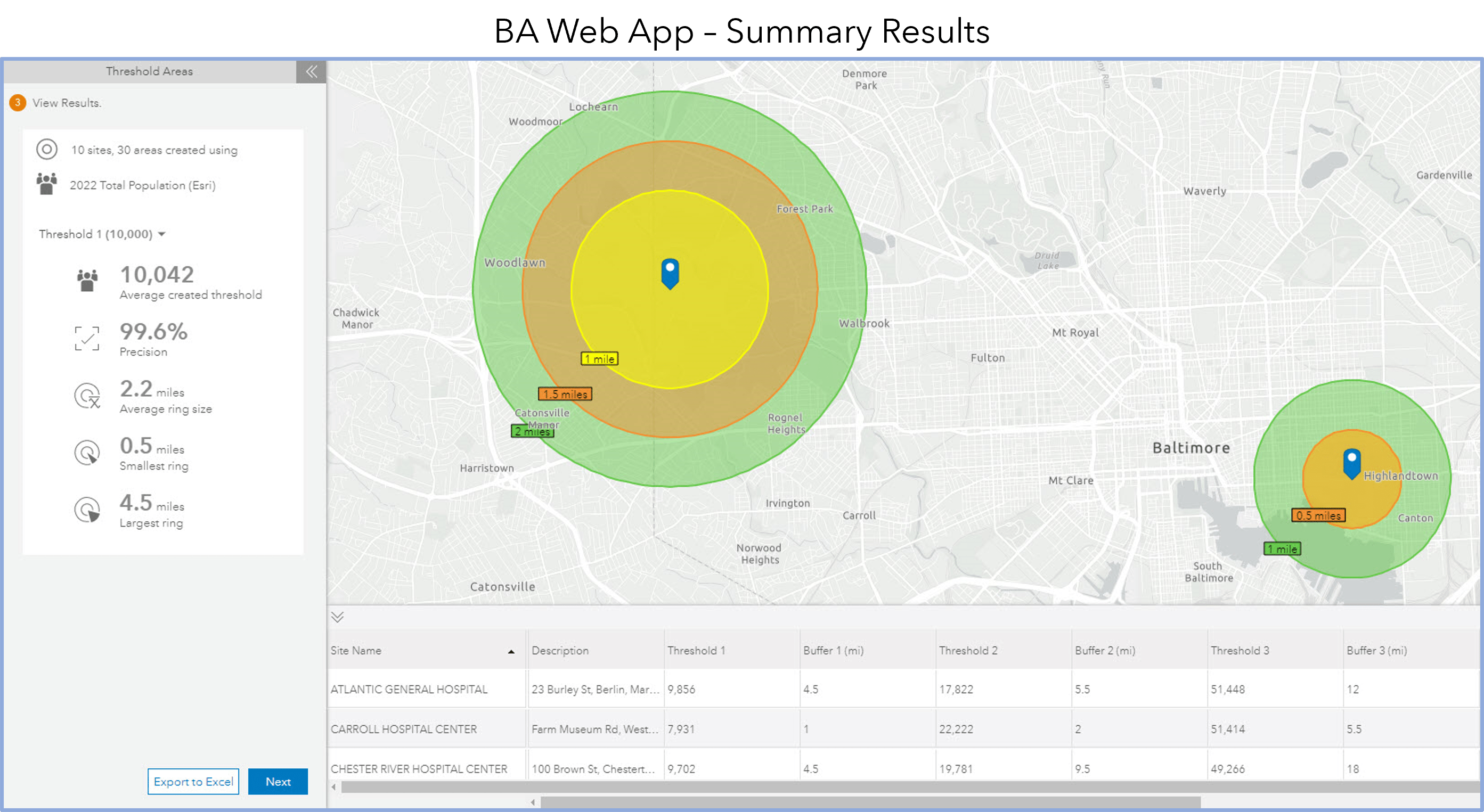

Business Analyst Web App offers a summary of the results with a quick view of the average, smallest, and largest areas. Threshold and distance details can be found in the results table, which can then be exported to Excel. The resulting threshold areas can be immediately used to run infographics and reports and are stored in the project as sites. The new sites can be leveraged in additional BA Web App workflows, such as Suitability Analysis or Void Analysis.

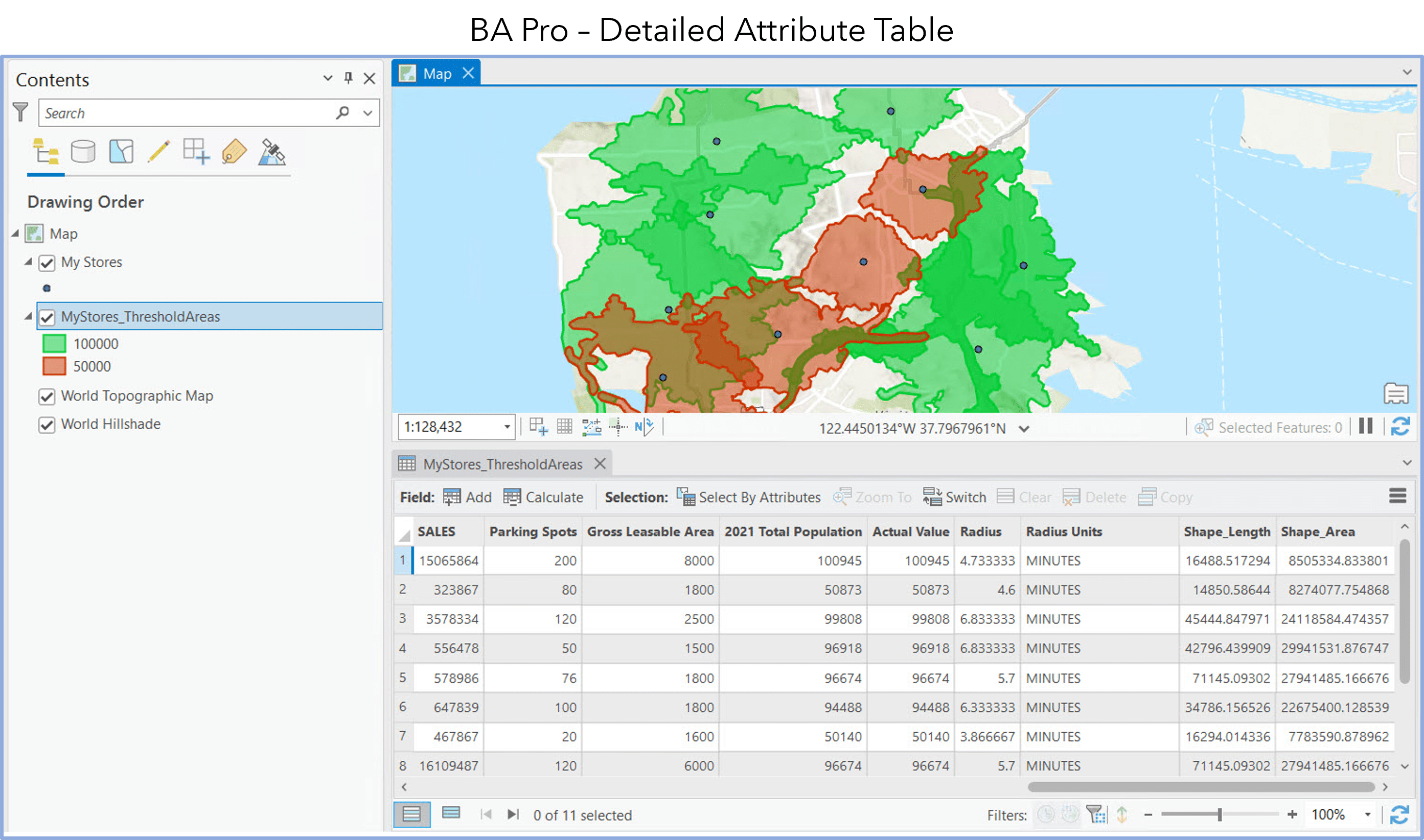

Business Analyst Pro provides results as a new layer that is added to the project contents and stored locally in your desired output location. The results layer has a detailed attribute table with additional fields including input parameters, radius, and coordinates, as well as more precise values that show six decimal places by default. Since the resulting data is stored locally as a feature class, there are many options for analysis and presentation of results. In addition to running infographics and reports, the areas can be used with Business Analyst Pro solutions such as Enrich Layer or Calculate Market Penetration
Threshold area results - BA Web App
Threshold area results - BA Pro
