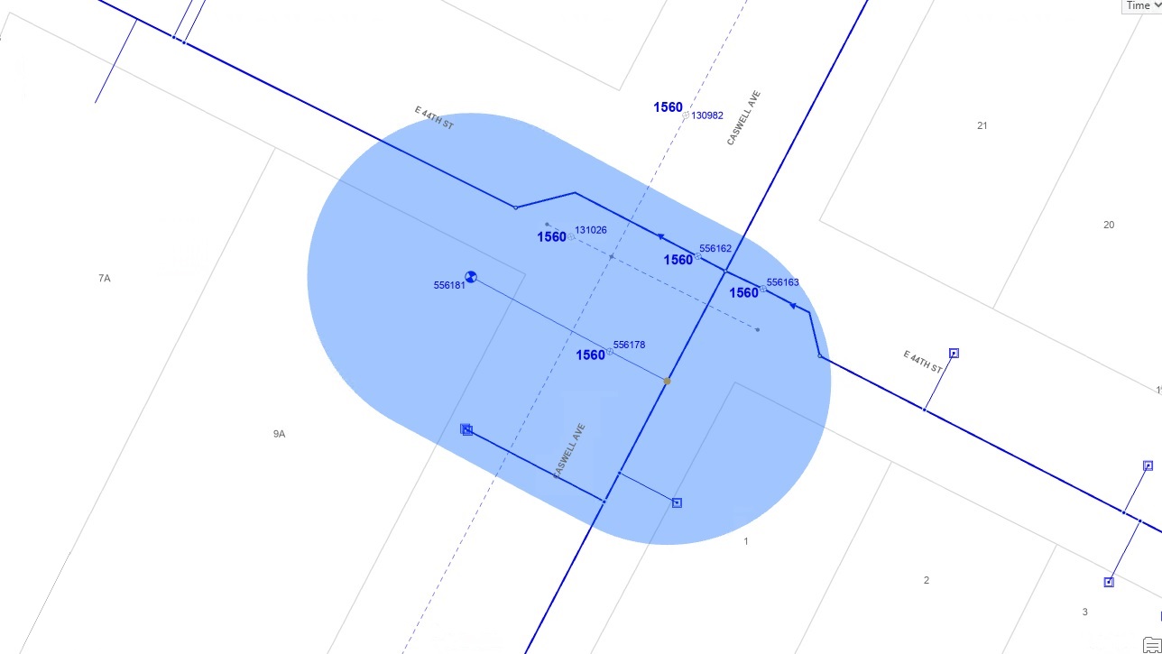

A buffer was used in ArcGIS to identify likely fire hydrant locations and limit the amount of lidar data processing.

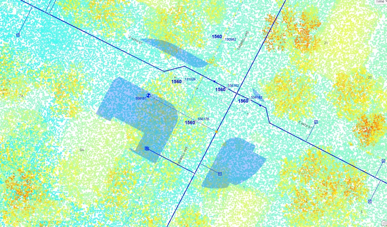

The tool Create LAS Dataset was executed containing only LAS points within the final buffer zone, which removed impervious surfaces and highlighted areas most likely to contain a hydrant.

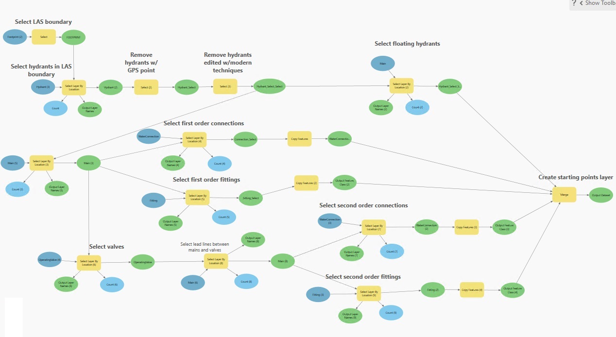

The workflow that emerged combines ArcGIS Pro, ModelBuilder, and Python to process lidar data and compare it against existing hydrant locations.
The process begins by narrowing the analysis to areas where hydrants are most likely to exist. From there, lidar LAS files are converted into usable multipoint formats and filtered to remove irrelevant features such as vegetation, ground, and buildings.

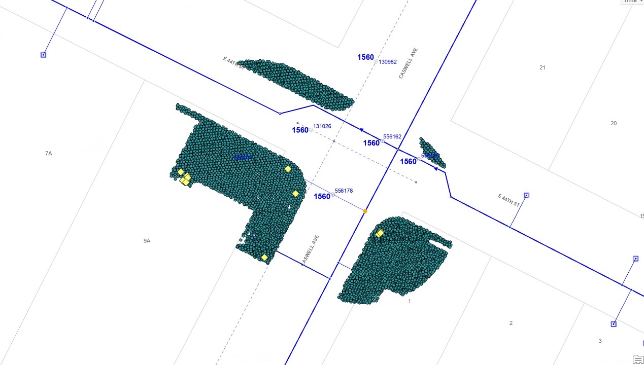

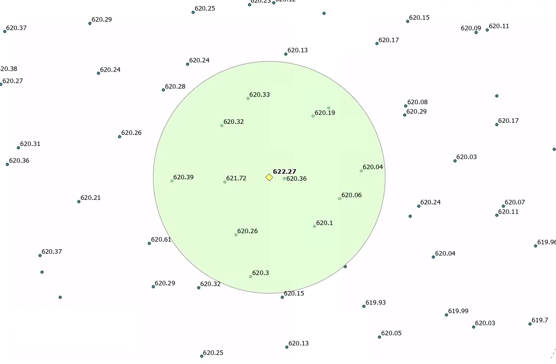

After the LAS data has been clipped, a multipoint layer is generated. Then an outlier layer (shown as yellow squares) was created from the multipoint layer.

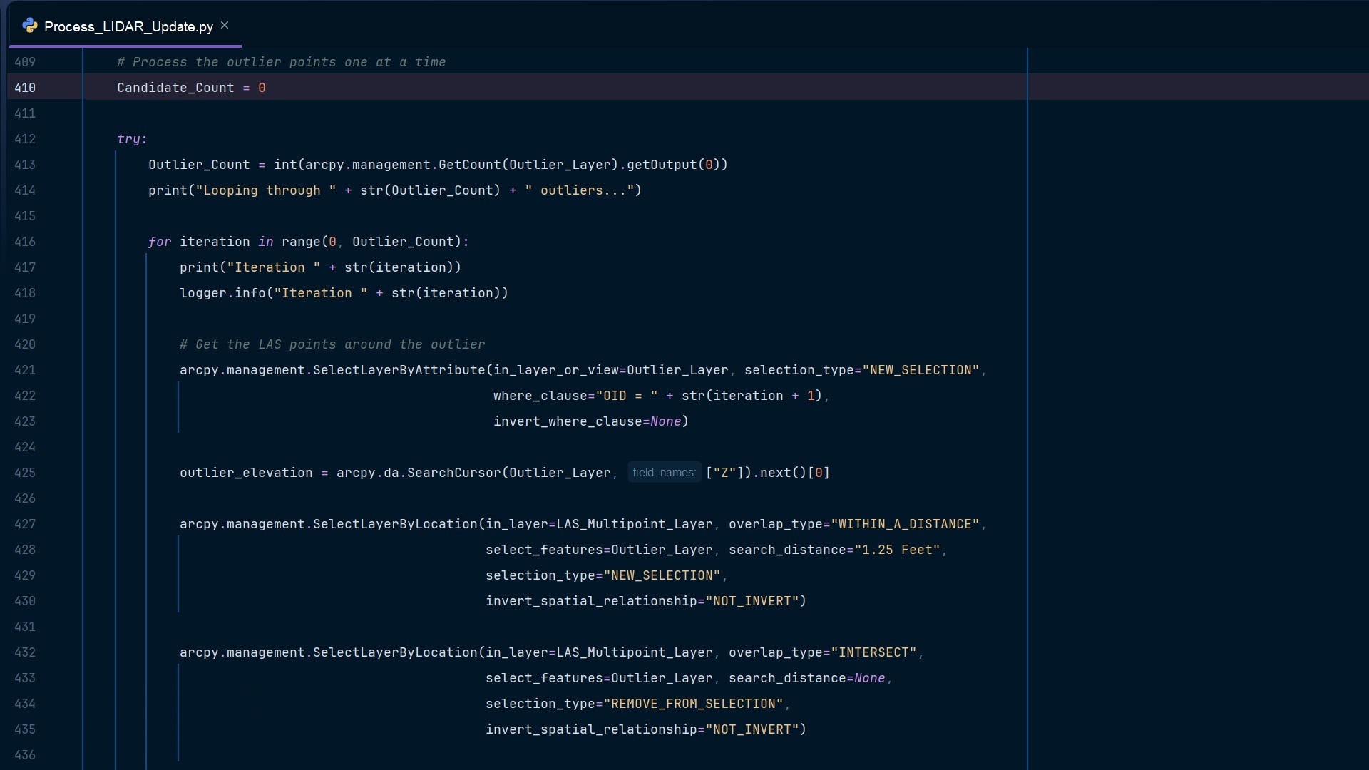

The core of the analysis focuses on elevation. Hydrants appear as vertical features, so the team developed a method to identify localized elevation differences within the lidar data. Using Python, they built a script to compare elevation values across nearby points and identify likely hydrant candidates.
The Python script compares the outlier point elevation values against the elevations of the surrounding points.
This was not a one-step process. It required repeated testing and adjustment, including tuning slope tolerances, refining buffers, and improving how candidate features were identified. Over time, what started as multiple scripts and models was consolidated into a single Python workflow capable of processing lidar grids in minutes.
Python was used to select outliers 2′ higher than surrounding multipoint features.

After the workflow was established, thoroughly tested, and performed as expected, the process was converted into a ModelBuilder process for automation. Then, the model was exported and integrated into the Python point elevation analysis code in a consolidated Python script.

The results in this sample area identified two hydrant candidates, one of which was the correct location of the actual fire hydrant.

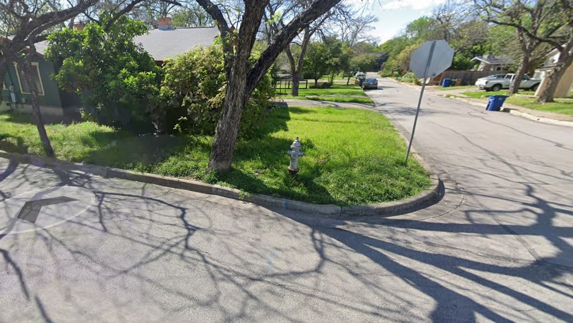

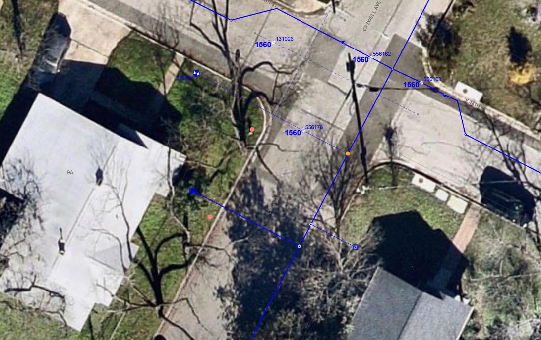

Google Street View validates the location of the identified fire hydrant from the workflow.
