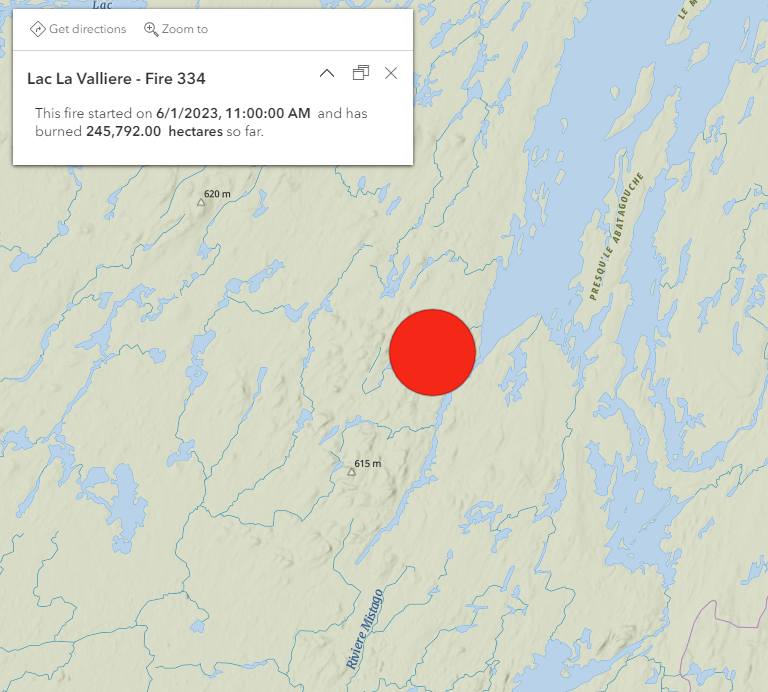

For this study, I chose one of the areas identified as a wildfire hot zone. After some research, the location is around Lac La Valliere near Mistissini, Quebec. In the area southwest of the lake, there is a wildfire that started around June 1, 2023.
Lac La Valliere fire location
The wildfire location that will be visualized with Landsat data.

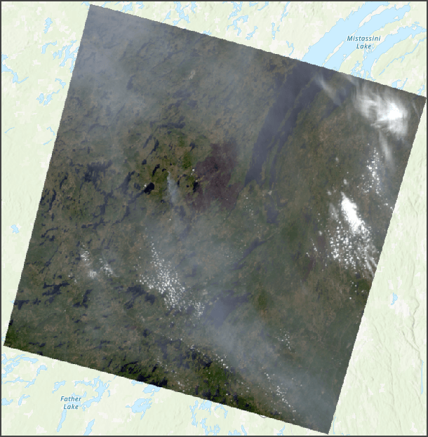

Now you have created a tiled imagery layer in your ArcGIS Online organization. This imagery layer contains eight raster bands that you can use for your analysis or visualization projects. Hosting tiled imagery layers can be used within your organization just like file based rasters. You can add them to ArcGIS Pro projects, use them in web maps, and also share them in Dashboards and Story maps. These imagery layers do not need to be downloaded to be used and provide a Saas based streaming experience for your organization.
Landsat image of damaged area
The Landsat imagery layer displayed in Map Viewer.
