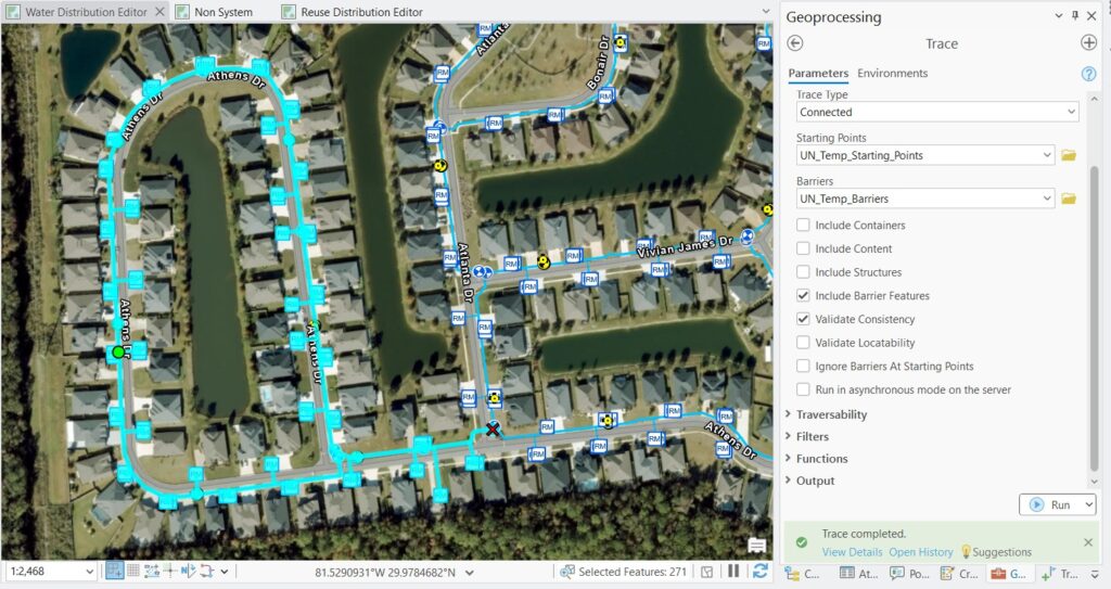

This screenshot from ArcGIS Pro shows the Trace tool applied to the newly migrated water network.
The up-front planning and data readiness work gave SJCUD the opportunity to identify and address potential issues before migration. By completing the data readiness assessment early in the process, GIS staff were able to correct data while other components of Utility Network implementation were underway, helping prepare the department for a smoother transition.
SJCUD successfully migrated its water, wastewater, and water reuse networks from the geometric network to Utility Network without the loss of features or data. Staff were trained on ArcGIS Pro and Utility Network workflows as well as on the administration of the new environment to support its long-term use.
Since migration, SJCUD has benefited from enhanced functionality across desktop, web, and mobile environments and stronger tools for maintaining data quality. Attribute validation rules and connectivity rules provide built-in mechanisms for identifying errors and enforcing data integrity, while the Utility Network capability’s tracing capabilities give staff greater insight into relationships across the utility system.
