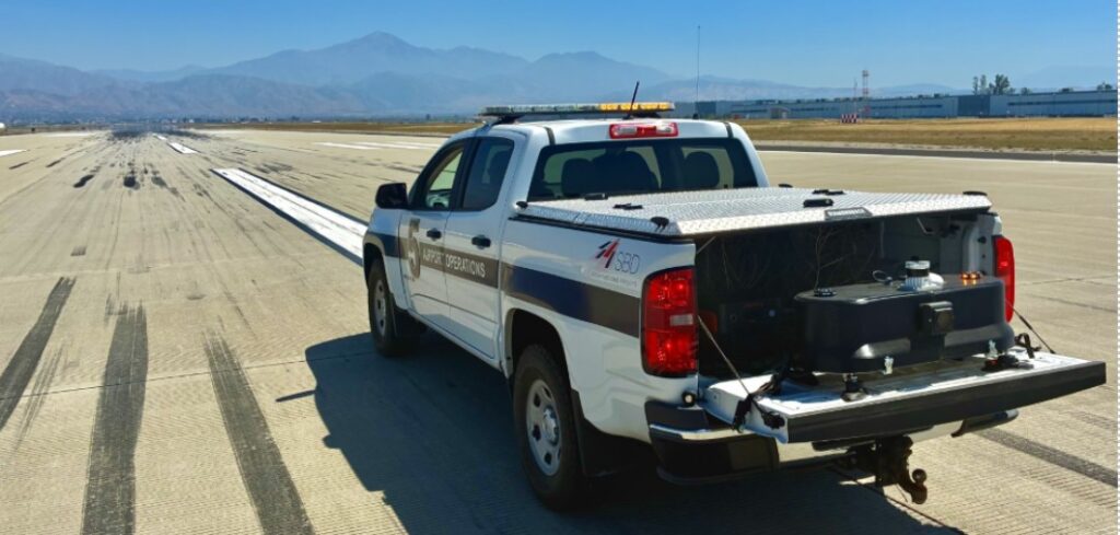

SBD augments safety inspections with Airwai’s LAIRA Rig sensor unit mounted on the tailgate of any utility vehicle
Combined with Esri’s ArcGIS, Airwai’s AI-powered inspection platform, Layered Autonomous Inference and Reasoning Agents (LAIRA) helps airports innovate by automating the process, expanding the scale and precision of each inspection. During a single pass on any airside surface, LAIRA can capture more than two million machine-ready data points describing surface features, visual patterns, and spatial context that manual inspections often miss.

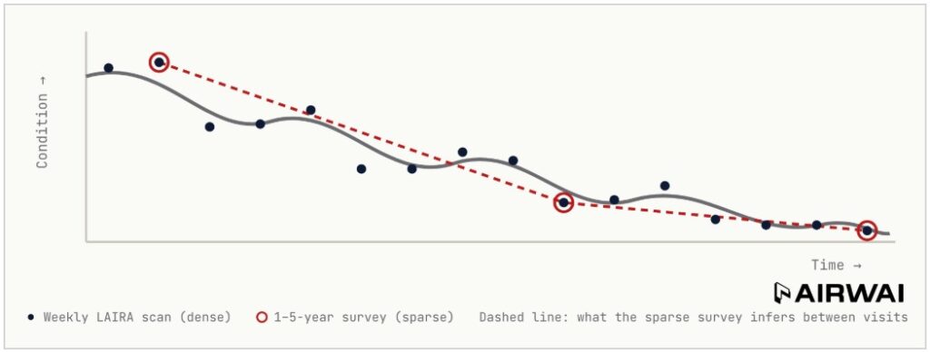

Weekly observations identify deterioration that sparse surveys miss
LAIRA tags each observation with a precise GPS location while algorithms simultaneously transform them into queryable GIS data points. Those observations are compared with past and subsequent data. Repeated inspections accumulate data that LAIRA uses to analyze trends and forecast repairs. This analysis tracks how every issue changes over time. Instead of treating an entire pavement section based on its average condition, LAIRAs multi-temporal precision enables teams to focus on very specific discrepancies and act with greater accuracy. It provides consistent logging and record keeping that supports Risk Management and Safety Assurance.

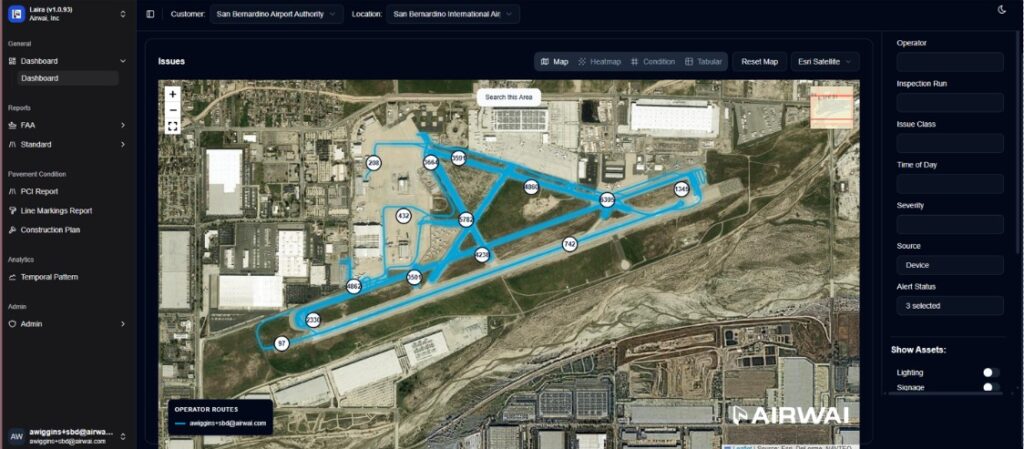

Overlaid on an Esri basemap, the blue lines trace LAIRA’s patrol route on the San Bernardino International Airport (SBD)
The operations and maintenance teams at San Bernadino manage an expansive airside of more than 1,300 acres and a 10,000-foot runway. Using ArcGIS Online, Airwai’s team and SBD’s airside staff built a workflow covering this entire area, turning LAIRA’s inspection outcomes into map layers that show where issues cluster, recur, or accelerate. A single pass can capture more than two million machine-ready data points. In side-by-side comparisons, AI-based inspection identified three to seven times more surface anomalies per mile than manual methods, with the biggest gains among early-stage issues. What moves into ArcGIS is the decision to act on issues, mapped and dated, not raw labels or scores that require interpretation.

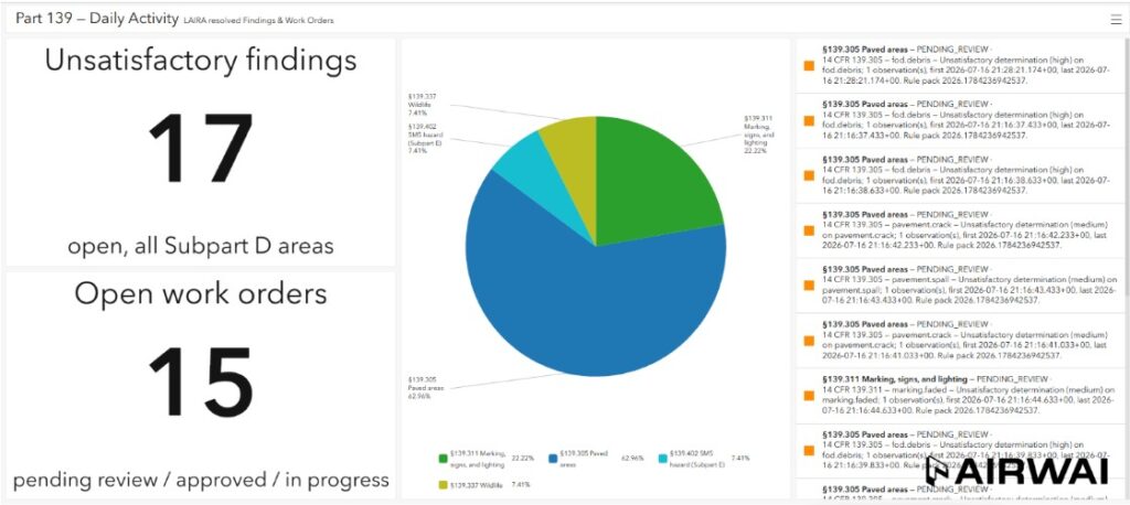

A Part-139 Daily-activity Dashboard of findings and work orders automatically generated by LAIRA’s built-in integration.
The Activity Dashboard rolls unsatisfactory findings, and open work orders up by Subpart D. Each record in the list is generated automatically; citing the rule it addresses.
