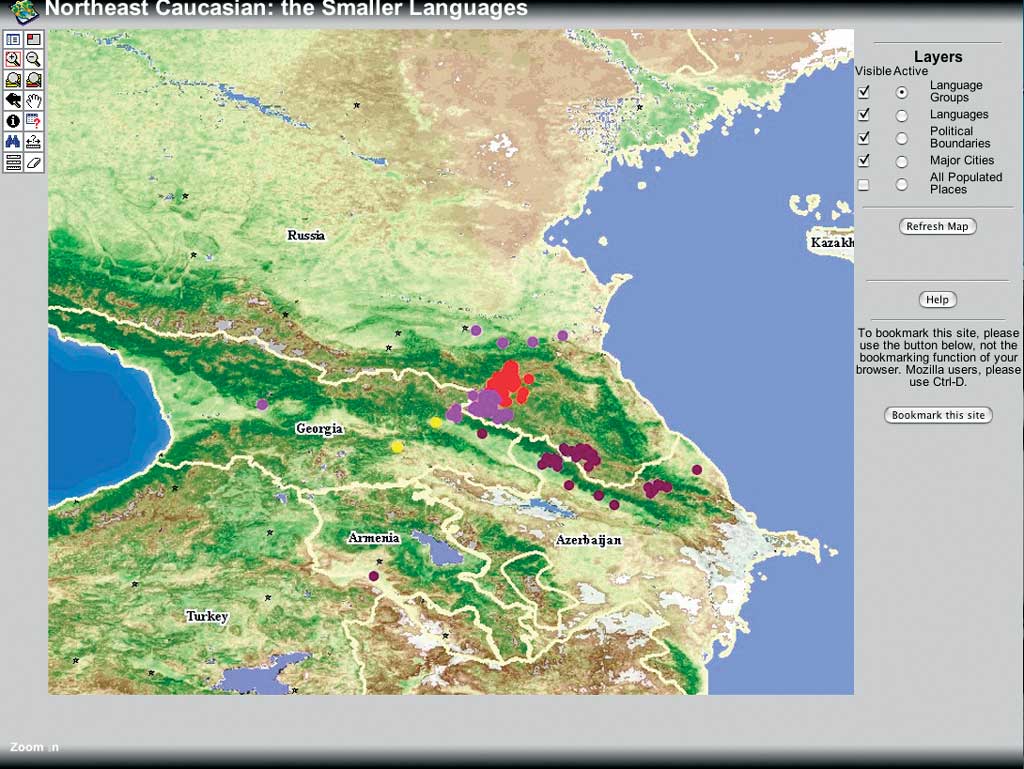

Figure 3: This map service shows ethnolinguistic groups in the Caucasus region.
The map in Figure 3 is a snapshot of the map service. The smaller languages of the North Caucasian family are presented in the visible layer below. The map service lets the user display or hide the following layers:

The mapped languages are listed with their dialects. Each dialect is geocoded (i.e., associated with particular populated places). The language variation can be displayed on the map at three levels: higher-level language groups, individual languages, and dialect levels. Regardless of the level chosen, geographic details—such as topographic information, physical geography, and information about cities and villages—can be present at all times, or turned off.
The typical Internet mapping service has functionality such as zooming, printing, and saving an image locally. The database can be queried using the Identification button, the Find function using string search, or the Query function (using SQL-based queries and Boolean searches). Querying needs further development to become more user friendly.
