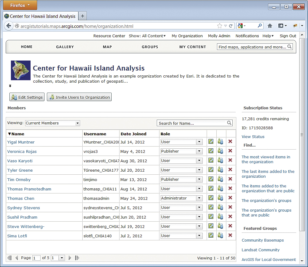

the My Organization page
On the My Organization page, you can view your organization's members and groups, determine how many credits have been used, and see which items have been added recently and which are the most popular.

The person who requested the subscription will receive an e-mail with an activation link. As the administrator, you must activate the account. If you are already using ArcGIS Online, sign in with your existing account to transfer ownership of your contents to the organizational account. If you wish to keep existing content separate or are not already using ArcGIS Online, sign up for a new account.
Once you have an ArcGIS.com account and are logged in, you can activate your subscription using the activation link. When you first log in to ArcGIS Online, you will be prompted for the URL indicator for the organization. The syntax is <organization name>.maps.arcgis.com. Note: Make sure the organization name is appropriate and correctly spelled because there is no way to change it once it is set. Once the URL indicator is set, you will be sent to the My Organization page. This page lets you monitor your organizational account: monitoring credit usage, finding out which items have been recently added and are the most popular, seeing featured groups, and viewing your organization's members and groups.

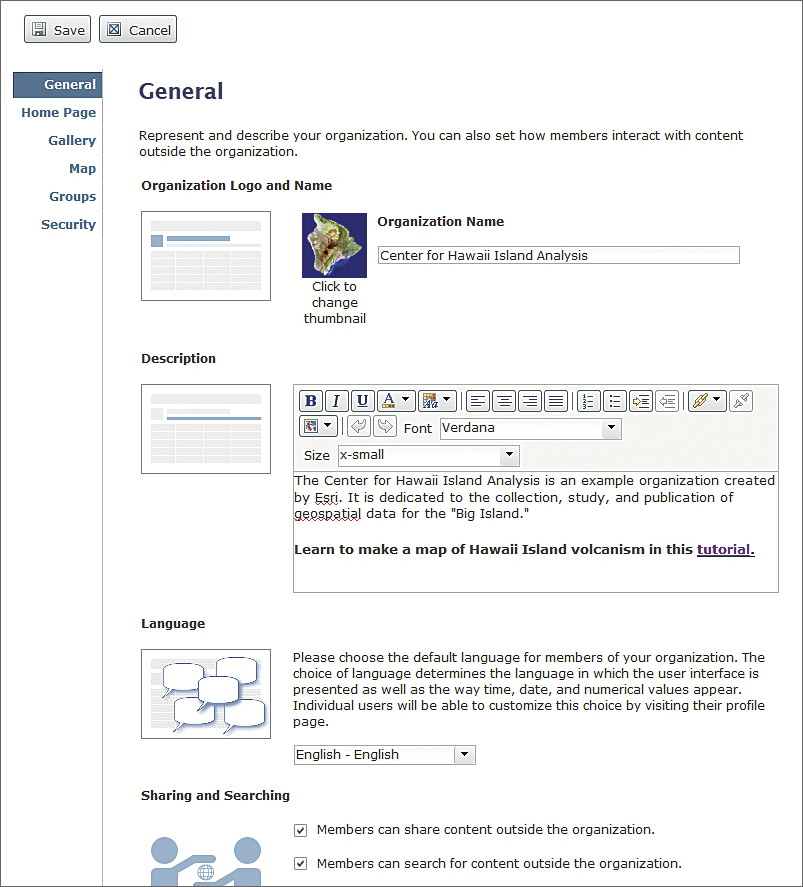

Click General. You will add the organization name and its logo and include a description of it on this page. This is where you set the default language for the site, although individual users can customize this choice using their profile page. This is also where you will set the permissions that determine how members share and search for content outside the organization.

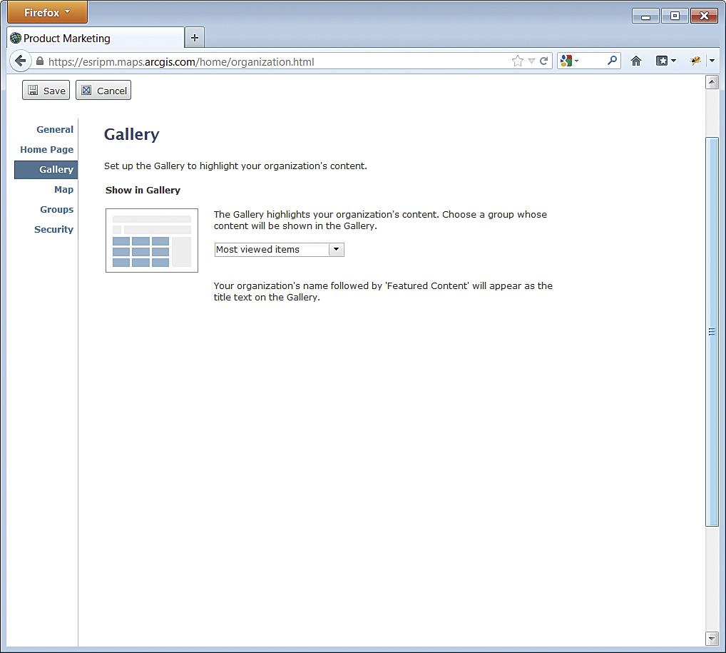

Gallery Page

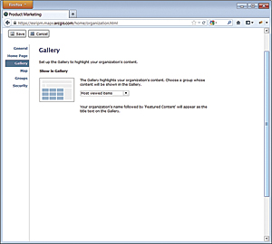

The next link is Gallery, where you will highlight the content from a group in your organization. For now, accept the default setting, and revisit it later.
The Gallery is where you will highlight the content from a group. The Gallery is where you will highlight the content from a group.

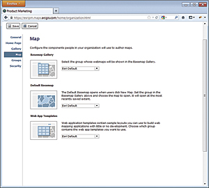

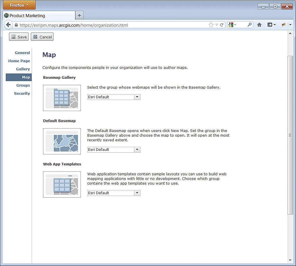

Map Page
Click Map to configure the basemap gallery, default basemap, and map templates that people in your organization will use to author maps. You can use the Esri defaults for each of these components or choose a group whose basemaps and web map applications will be available instead.
If you will use basemaps from your organization, it is best to create a group called Basemaps that is owned by the site administrator. Note that only ArcGIS for Server and Open Geospatial Consortium, Inc. (OGC), Web Map Service (WMS) services can be used as basemaps. Layers from a file, KML services, and editable layers created in the ArcGIS.com map viewer cannot be used as basemaps. The default basemap will be the basemap your users will get when they click New Map. This map will open to its most recently saved extent. Web application templates contain sample layouts that people in your organization can use to build web applications with little or no development work.

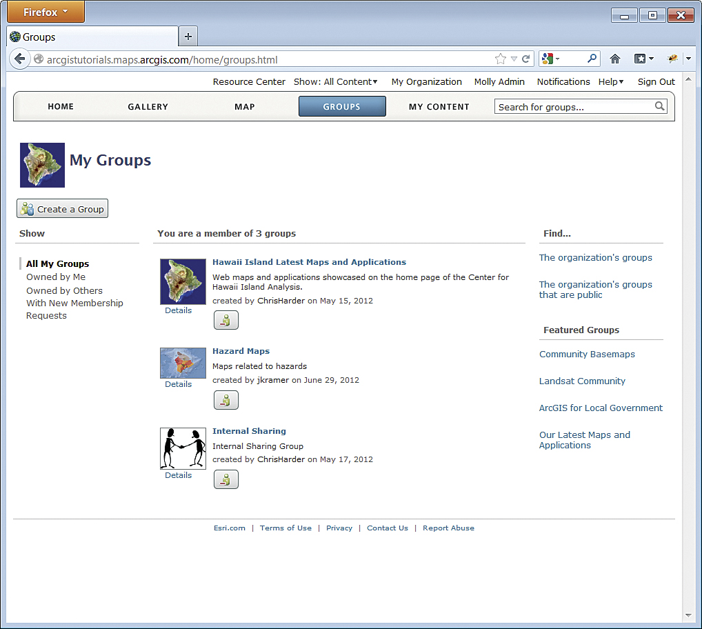

Groups Page
Groups Page
Groups Page
This is where you add an existing group to the Featured Groups list. For now, accept the default setting. Click the Groups button at the top of the site to begin creating the groups you identified earlier and setting appropriate permissions.

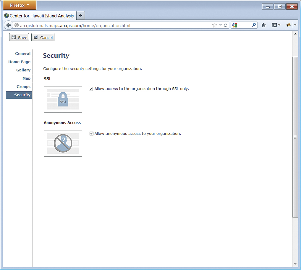

Security Page
When configuring the security settings for your organization, allow access only through Secure Sockets Layer (SSL). If you will have content that will be public, enable anonymous access, which means a user will not be prompted for login credentials.
