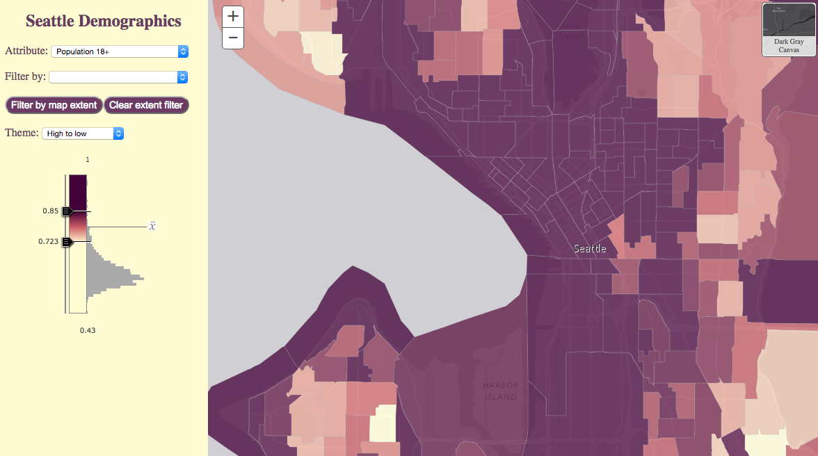

For example, open the sample depicted in the image below, which uses Smart Mapping to generate a color renderer with good default inflection points for colors based on the statistics of the layer. Compare the visualization in the app to the default renderer of the same layer in the ArcGIS Online Map Viewer.
CLICK HERE TO VIEW THE LIVE SAMPLE
In this app I call the createColorRenderer() method on the smartMapping module to generate a visually pleasing renderer for the layer once it loads. All that’s needed is the layer, field name, normalization field (if desired), basemap, and theme. The method returns a promise that resolves to an object containing a renderer with a color scheme mapped to values specific to the data in the given field. See the code block below to observe the simplicity of this API; there’s no need to know the statistics, data values, or classification types. It’s all figured out for you.
Click here to view this code on GitHub

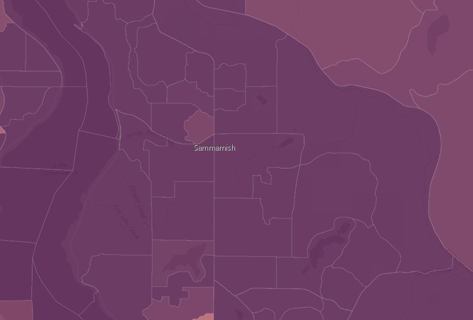

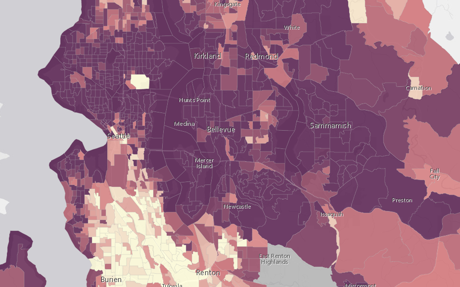

Suppose the user wants to explore the demographics of a subset of features, such as a neighborhood, but the features in the area of interest don’t have a common attribute for filtering. For example, when I select the attribute Population 25+ that earned a college degree, I notice that most of the adult population in the Sammamish, WA area seems to have a college degree.
This intrigues me so I decide to explore that region further. When I zoom in, most of the features are shaded with the darkest color indicating that at least 69 percent of the adults have a degree.

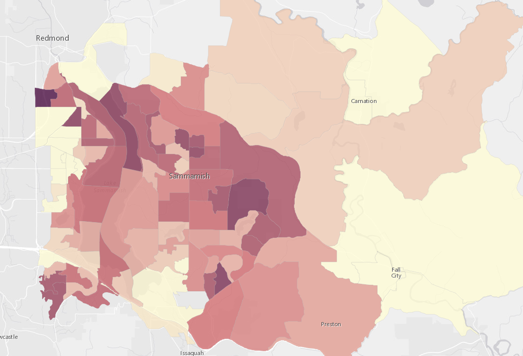

But this view isn’t useful to me; I want to see more details. I can do this by regenerating statistics and the renderer for only the features in the map extent. So I included an option to filter features by geometry.
Once this button is clicked, all features outside the extent of the map are excluded and the layer’s renderer is regenerated based on the statistics of the subset.
Now I can see more detail in this area relating to the percentage of adults that have college degrees. If I adjust the slider slightly, I can stretch the color ramp so the feature with the highest rate of college degrees (98 percent) and those on the low end (71 percent) are more obvious at first glance.
