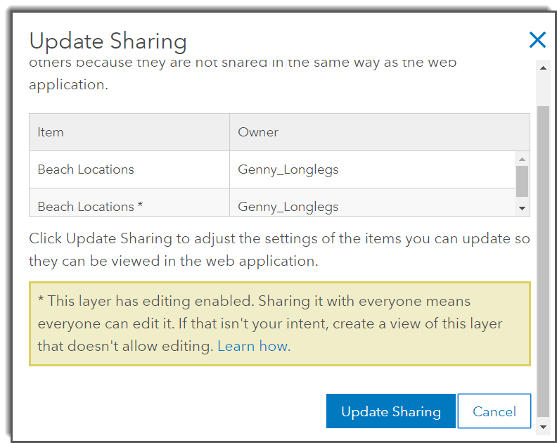

As a public app, viewers can access the web application anonymously. The users just need to be able to find the URL to access the content. To ensure the public can access all components of the web application, the supporting items, such as the layer and web map must also be shared with everyone.

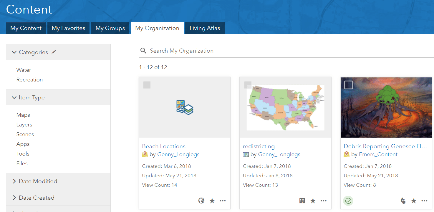

Items shared with the organization can only be searched for and browsed to by members of the organization. Other members of ArcGIS Online will not be able to find such content in a search and outside member attempting to navigate directly to the item will be prompted for a login. Content that is shared with the organization can be found in the My Organization tab of the content page, along with other organization content that the user has access to (example: content that is shared with everyone  but originates from the organization). This creates an easy location to find content that has been created by organization.

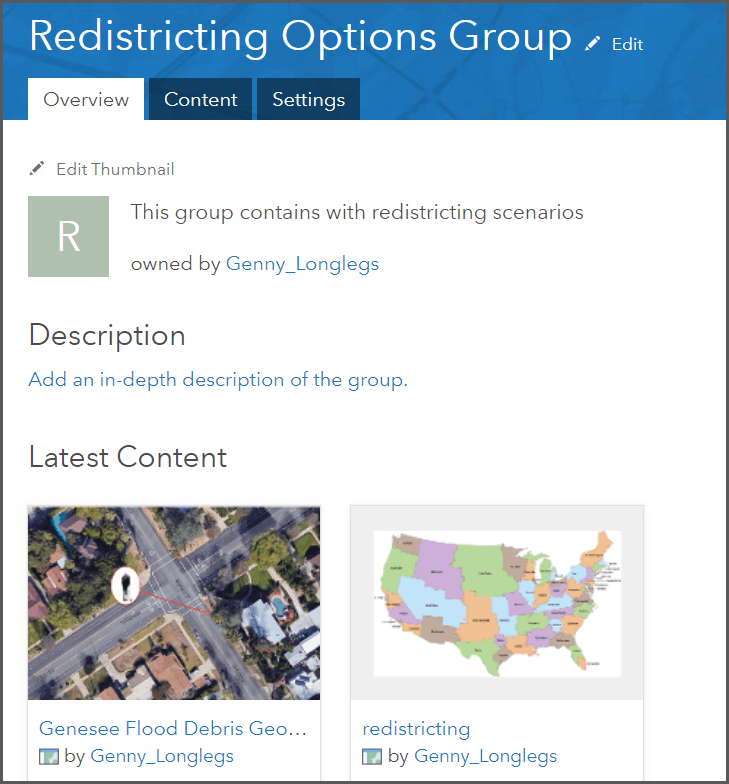

Items shared with members through group sharing can only be searched for and browsed to by members who are members of the group. Other organization members will not be able to find this content in a search and will be prompted for a login if an unauthorized member attempts to navigate directly to the item. Content that is shared with a specific group can also be found on the group page or on the My Groups tab on the content page. Tip. Consider where the best place is for your users to discover the shared content, as different stakeholders may have different familiarity with ArcGIS Online. If members accessing the shared content use the content page often, this may be the easiest way to find content they have access to. If the member is generally unfamiliar with ArcGIS Online, consider providing the URL to the item and the user’s username and password. Even though the security is set up through group sharing, the desired user experience may be simple navigation to a link and authentication.

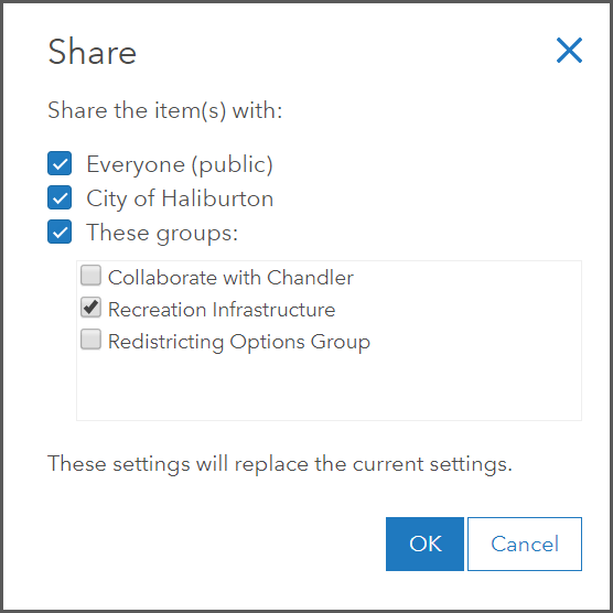

The GIS Manager for the City of Haliburton wants to organize all the city’s recreation applications, so the recreation content managers of the ArcGIS Online organization can easily find them grouped together. The applications need to have the sharing setting of everyone, this will ensure that public users can anonymously access the applications that are posted on the city’s website.  The applications can also be shared with the recreation managers apps group, so that all the members of the recreation managers group can find the applications on their content page on the My Groups tab. As the members of the recreation managers group can access all the supporting items for the applications because they are shared publicly, only desired content (applications) needs to be shared with the group to create an easy navigation experience.
So go ahead and decide who you want to share your geospatial content with, and set up the correct sharing settings to take advantage of the wealth of organization members, ArcGIS Online members, and the public who can view and collaborate with your content.
