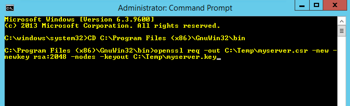

  1. The first step is to generate a new private key and Certificate Signing Request.  Open a command prompt as administrator on your local machine by right clicking on Command Prompt in your Start Menu. Navigate using cd to the install location of openssl (e.g. C:Program Files (x86)GnuWin32bin) and run the following command, replacing “C:Tempmyserver” with your desired filename:
    • openssl req -out C:Tempmyserver.csr -new -newkey rsa:2048 -nodes -keyout C:Tempmyserver.key

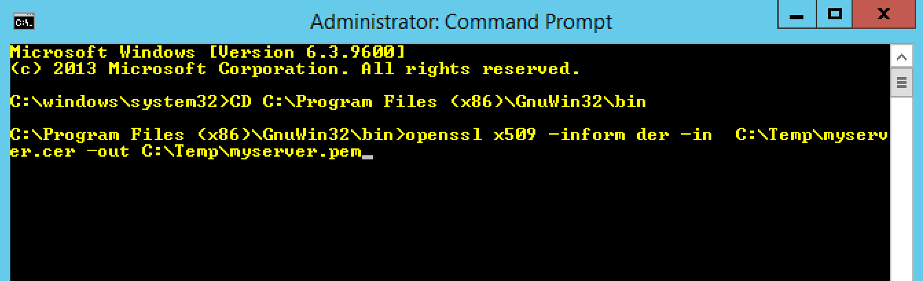

  3. The signed server certificate will most likely be returned to you in the form of a .cer file, and since we need it in .pem format we’ll need to run it through a conversion process using openssl. Once again open a command prompt as administrator, navigate to the install location of openssl (e.g. C:Program Files (x86)GnuWin32bin) and run the following command:
    • openssl x509 -inform der -in  C:Tempmyserver.cer -out C:Tempmyserver.pem

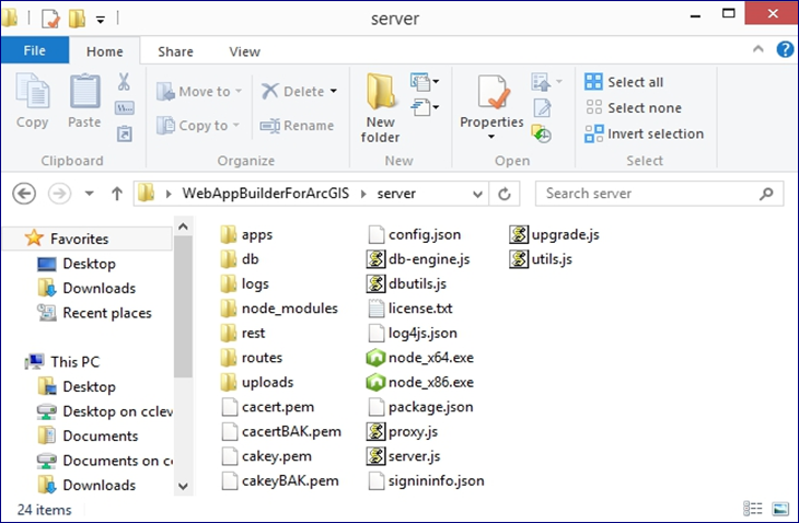

  5. Replace the cacert.pem and cakey.pem files in the the Web AppBuilder Developer Edition server directory install with the two files created above. The files need to have the exact same names as the ones you’re replacing so make the following changes:
    • The file created in step 3 (myserver.pem) will need to be renamed to cacert.pem, and the file created in step 1 (myserver.key) will need to be renamed cakey.pem.
    • Once renamed, place them in the Web AppBuilder Developer Edition server directory.
    Note:  Be sure to back up the self-signed certs prior to replacing them with the ones created just in case!
