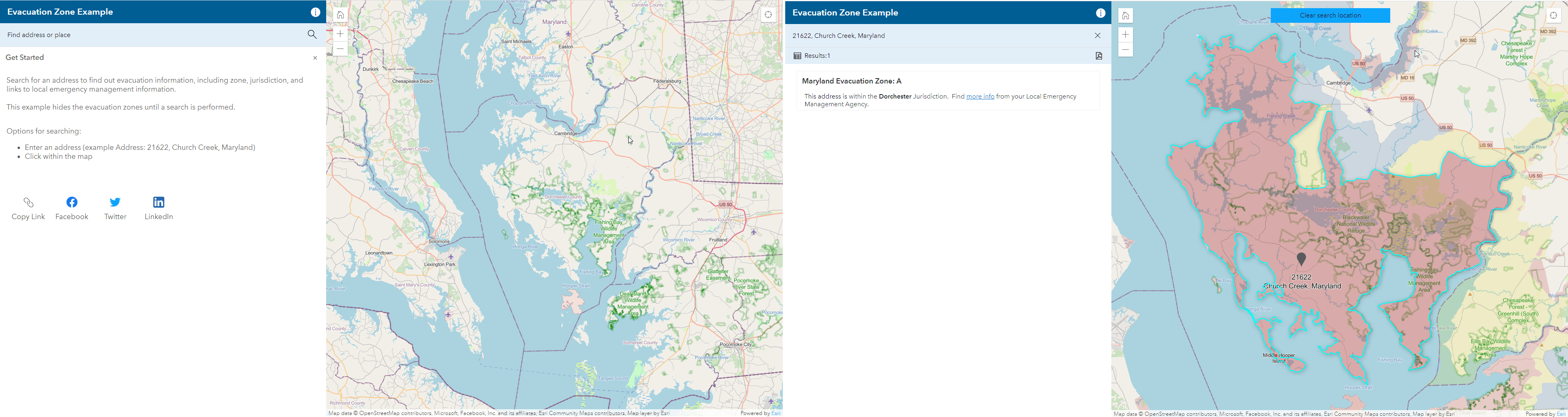

Results of a searched address in the zone lookup app.
The Zone Lookup app requires that your user inputs a location. They can search for an address or definthe location by clicking on the map or using the geolocation service on their mobile device. The app will determine if the location falls within (intersects) the available zones or not.  If the searched location is within the zone, information about zones (Search Results) will be returned, if not you will be notified the location is outside of the zoneThis may seem complicated to explain with words, but the user interaction is simple. All the user needs to do is input their address and view the search results. Let’s look at how to configure a Zone Lookup app.

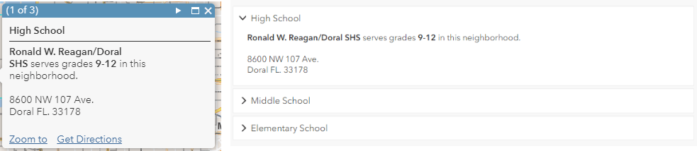

Take time to configure the pop-up. The information returned about the zones comes directly from the popup in your map.  When creating the pop-up ensure that relevant information is displayed in a way that your intended users would understand. In the app, the zone title will be the popup title and zone description will be the popup information. The image below shows the map pop-up next to the zone information from the Zone Lookup app. In this example, attributes from the results layers are constructed into a sentence to make the information easy to understand.
High School boundary pop-up in the web map and High School zone information in the Zone Lookup app.

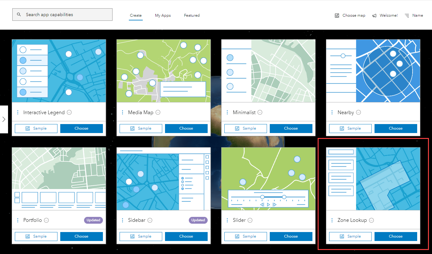

Step 2. Pick the Zone Lookup Template

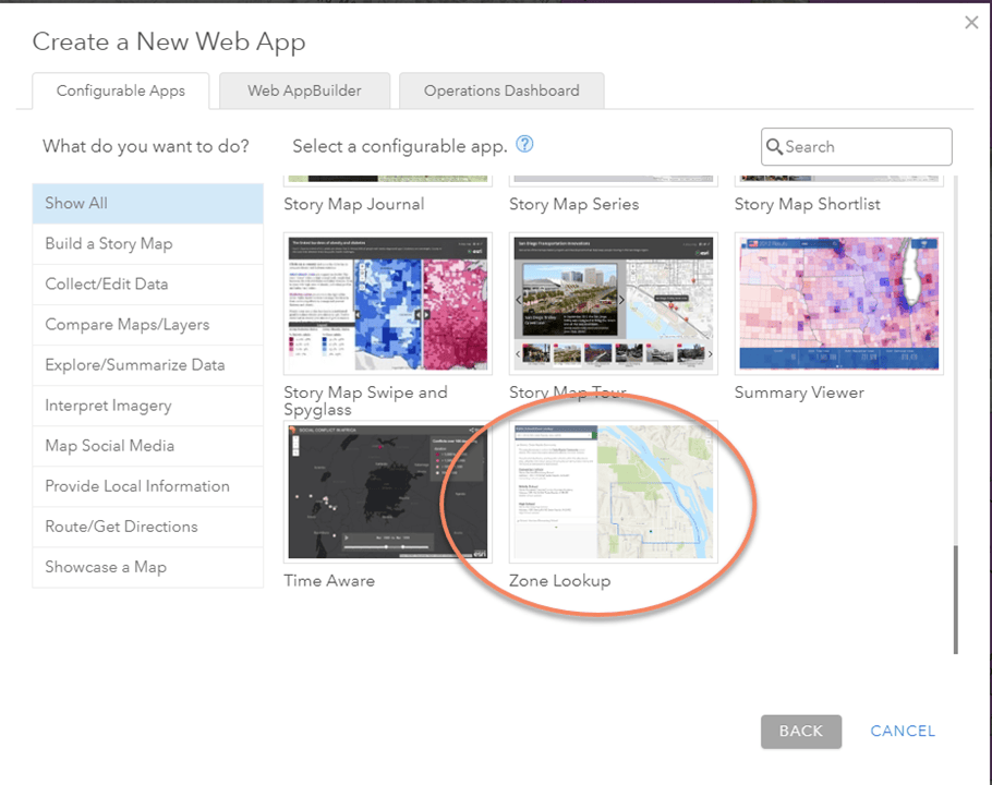

Once your map created and saved, click Share in the Map Viewer and click Create a Web App.  Select Zone Lookup as your app.
(Tip: Z is the last letter in the alphabet and apps are listed in alphabetical order, so this app is the last in the list. To quickly find the app, scroll directly to the bottom of the Select a Configurable dialog or type Z in the search.)
Instant App home page with Zone Lookup highlighted

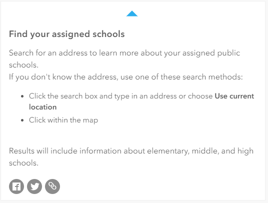

On the Step 2 – About set the title, and the onboarding text for the app.  Onboarding text by default provides generic instructions for how users should interact with the app. Configuring your onboarding text that is specific to your app and data can help provide context and call to action for your users.
Customized text for the onboarding panel.

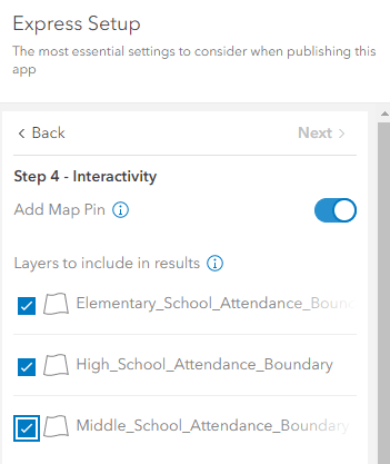

Step 4 – Interactivity is where you can configure the app interactions.  First, select any layers you want returned in the search results by checking on layers from the list options.
Layer result selection area

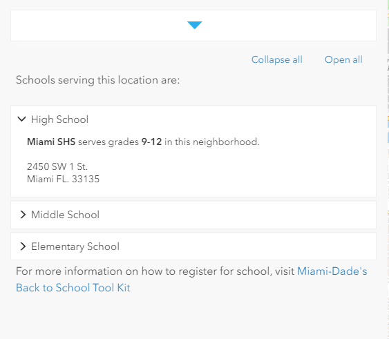

When search results are returned, you have the option to include custom text if no results are returned. Configure a message to indicate to users when no results are returned. This way users will see that there were no results, instead of just having nothing returned in the results. Full text options (which include before and after custom text) are available in full setup mode.  Below is an example of custom before and after text.
Results from a school attendance boundary with custom text before and after the results.

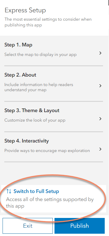

This completes the express setup; the app is ready to publish and share.  For more options switch to full setup. Full Setup contains advanced options as well as app-specific options particular to the chosen app.
Switch to full setup option highlighted in the Configuration Panel
