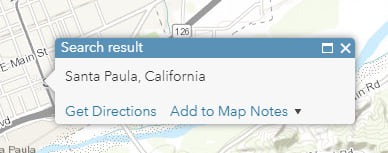

Step 1 – Use Search to find the location.
The first step in making the map is to navigate to the fire location. Open a new web map, use search and enter Santa Paula, California. You can also use Thomas Aquinas College, Santa Barbara County, or Ventura County as the search string.

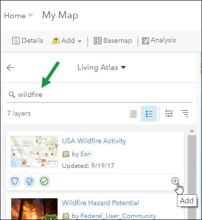

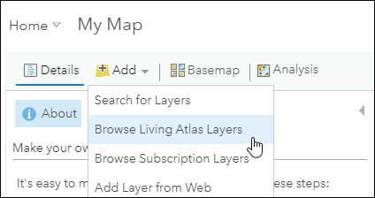

Step 1 – Click Add, then Browse Living Atlas Layers.
Step 2 – Search for “wildfire” to locate USA Wildfire Activity, then click + to add the layer to your map.

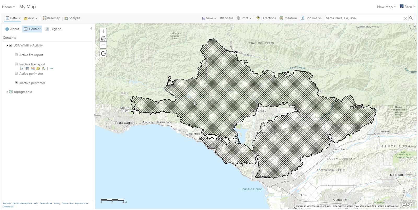

Step 3 – Display the Thomas Fire perimeter.

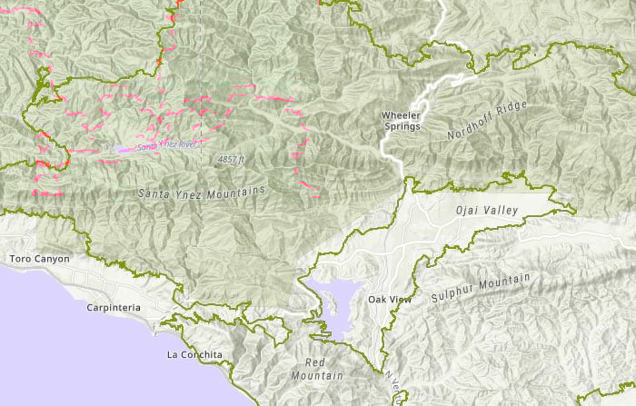

By default, the  USA Wildfire Activity layer has the active fires locations and perimeters toggled on. Since the Thomas Fire is no longer active, you will turn the default active fire sublayers off, and turn the inactive perimeters on. Click the layer title to reveal the sublayers, and toggle the layers as shown below.
Zooming out, you can view the extent of the Thomas Fire.

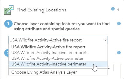

Step 1c – Click Find Existing Locations.
Step 2 – Complete the tool parameters (numbered in blue) as follows.
For parameter 1, choose the USA Wildfire Activity-Inactive Perimeter sublayer.

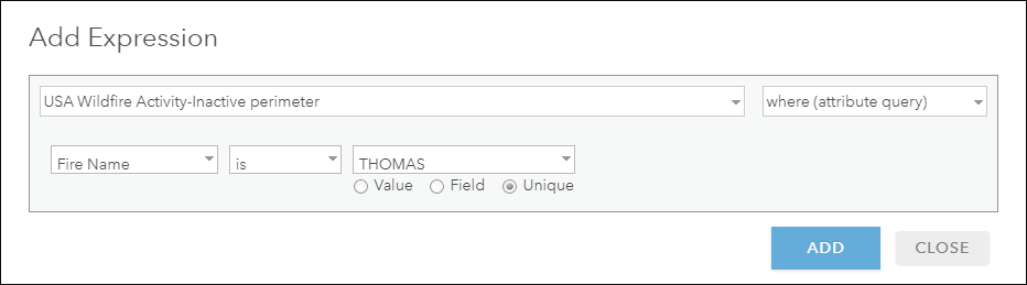

Step 3 – In parameter 2, construct the attribute query expression to find the Thomas Fire perimeter. The expression looks like this:
Step 4 – Complete the tool parameters for Find Existing Locations by entering a Result layer name in parameter 3, then click Run Analysis.

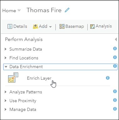

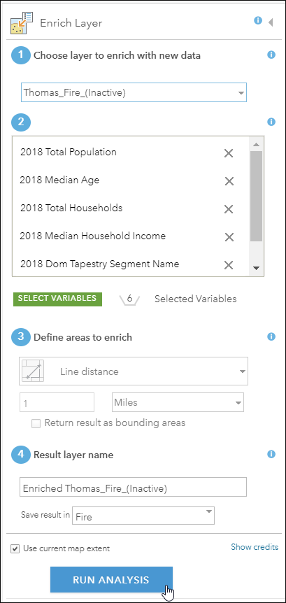

Step 1 – Open the Analysis tools, and choose Enrich Layer.

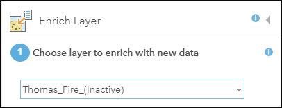

Step 2 – Complete the tool parameters in the Enrich Layer tool. First, select the layer you created in Step 8 in parameter 1.

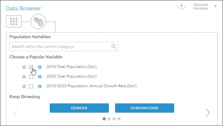

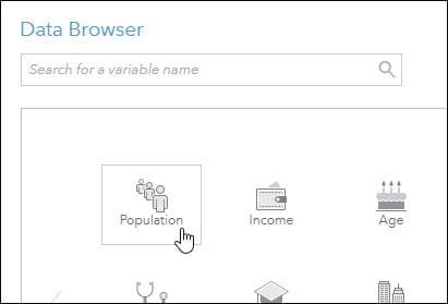

Step 3 – In parameter 2, click Select Variables to open the Data Browser.
Step 3 – Choose the following attributes to enrich the fire perimeter:
Begin by selecting a category:
Then choose the attributes.
To go back to the categories, click the category box in the upper left:
Step 4 – After selecting the attributes, complete the tool parameters as shown below, then click Run Analysis.

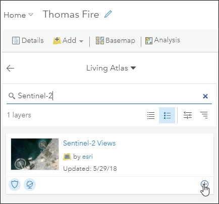

Step 1 – Add the Sentinel-2 imagery layer from the Living Atlas.
This is similar to what you did in Step 3, but search for Sentinel-2 instead.

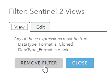

Step 2 – Remove the default filter on Sentinel-2.
The default filter on the Sentinel-2 layer will display the most recent and clearest imagery available. You will want to search for all imagery around the dates of the fire, even smoke-filled imagery, so remove the filter so all imagery will be available. After adding the layer, click the Filter icon to display the current filter, and remove it.

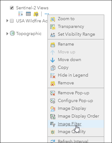

Step 3 – Click More Options (…) and choose the Image Filter.
You will use this filter to search for available imagery around the dates of the fire.

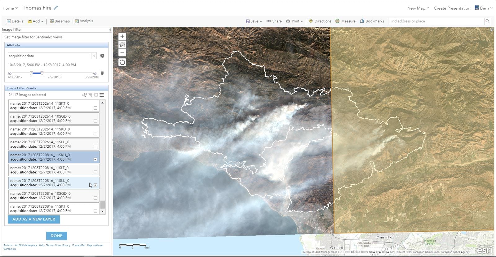

Step 4 –  Select the imagery at the desired dates.
Adjust the time slider around the dates of the fire. The available imagery will be listed. Hover over each to display the coverage footprint in yellow on the map. Identify the date, then select the images that cover the fire perimeter. Repeat the process to create layers for before, during, and afterwards. Note that to cover the entire fire perimeter you will have to select two images, then click Add To Map combining both into one layer.
When moving on to the next date, remember to uncheck the previously selected layers.

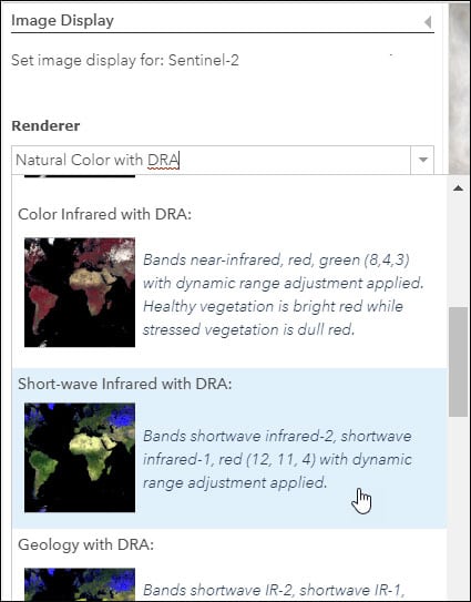

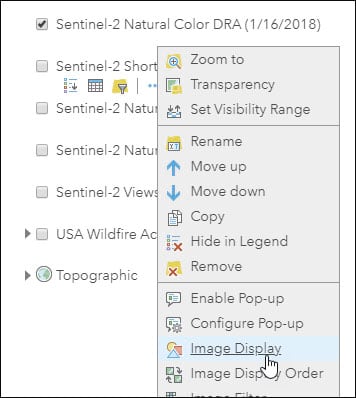

Step 1 – From the layer options, choose Image Display.
Step 2 – From the list of renderers, choose the one that you want, then click Apply.

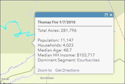

After configuring the layer pop-up, clicking the perimeter provides more information about the population. The total number of acres was in the original perimeter, but geoenrichment has added the population, number of households, median age, median household income, and dominant Tapestry segment (Exurbanites). The dominant segment is a link that opens detailed documentation about Exurbanites, helping us learn more about the characteristics of the impacted residents.

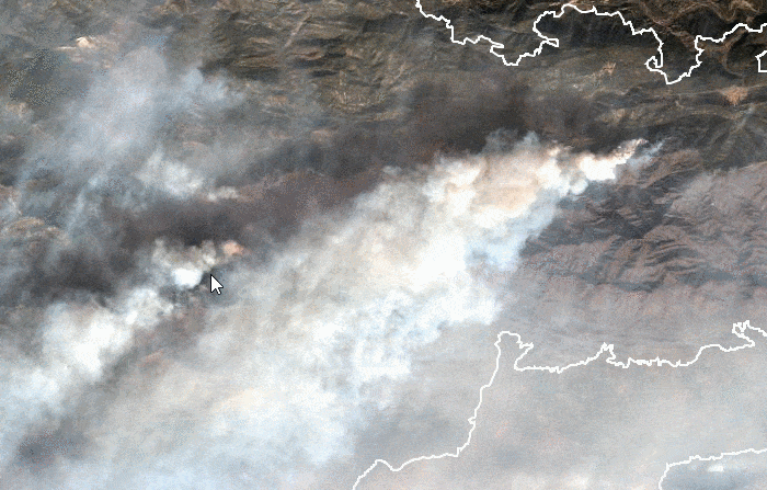

Pre-fire Sentinal-2 imagery December 23, 2017
Using the default Natural Color DRA renderer, this image show the normal conditions and appearance for the burn area.

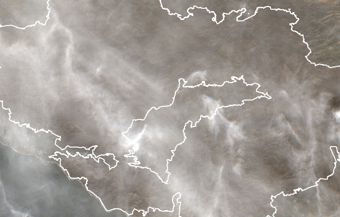

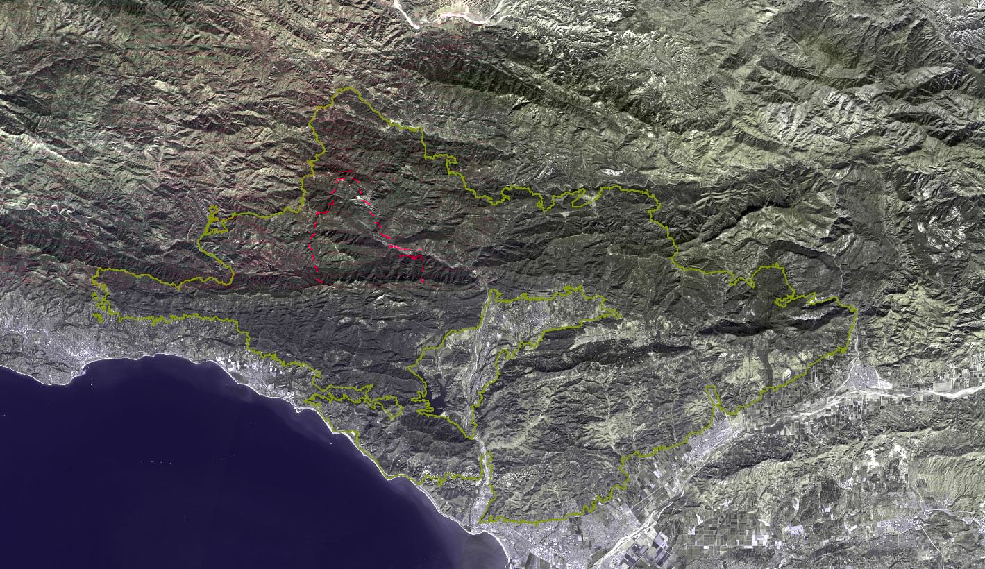

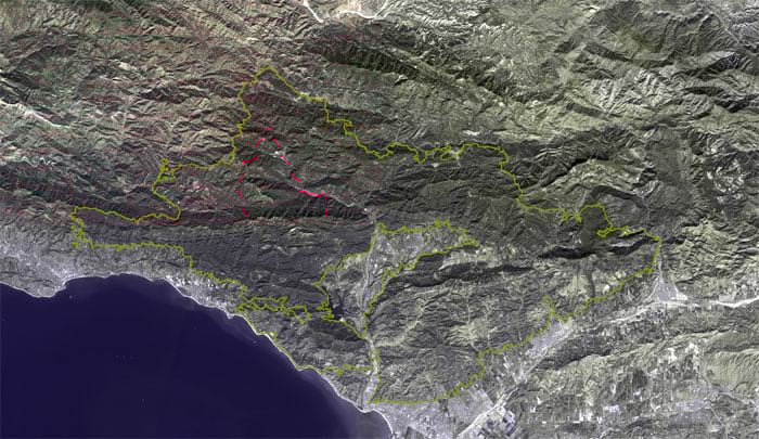

During-fire Sentinel-2 imagery December 7, 2017
Captured a few days after the fire started, and using the Short-wave Infrared renderer, this layer allows us to peer through the smoke and clearly see the active burn areas.
