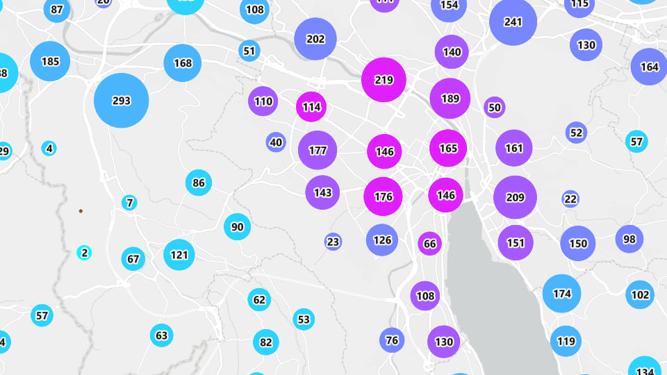

The previous release introduced support for clustering on point feature layers only when authored as part of a web map or layer item.  In this release we’ve included a new clustering API to update existing or define new feature reduction options on point feature layers to simplify maps that display large quantities of data, even if the web map or layers you’re using aren’t pre-configured for feature reduction.   This new, comprehensive API also enables you to define renderers, labels, and popups on clusters, set a cluster radius, add aggregate or summary fields, set scale thresholds, and define cluster symbol size ranges.

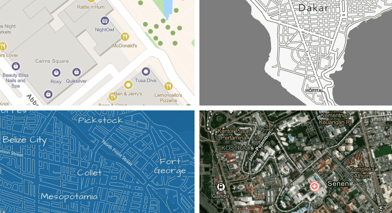

This release includes support for the following cartographic styles available through the new basemap styles service API:
In addition, basemap styles service v2 includes the ability to localize place name labels, and the Native Maps SDKs now let you override the default label language for a basemap style. You can choose to set a specific language, and if a supported language code is supplied, basemap labels will be displayed in the identified language. If you specify an unsupported language code, the label language falls back to the closest available language. For example, American English (en-US) or Canadian French (fr-CA) are not currently supported and these are interpreted as English and French respectively. If no suitable fallback language code is found, labels use the default language for the style. The default for ArcGIS basemap styles is global language (English) while the default for OpenStreetMap basemap styles is to show local place names for basemap labels. Alternatively you can choose to set the language to follow the application locale. If the application locale is an unsupported language it will follow the same language fallback behavior described above.  You can learn more about the v2 Basemap Styles Service here.
