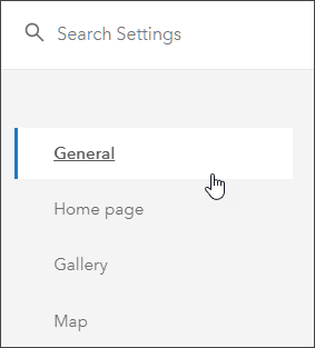

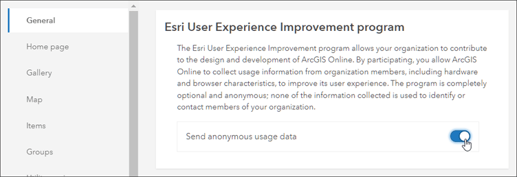

Step 1 — Open the General tab of your organization Settings.
General settings

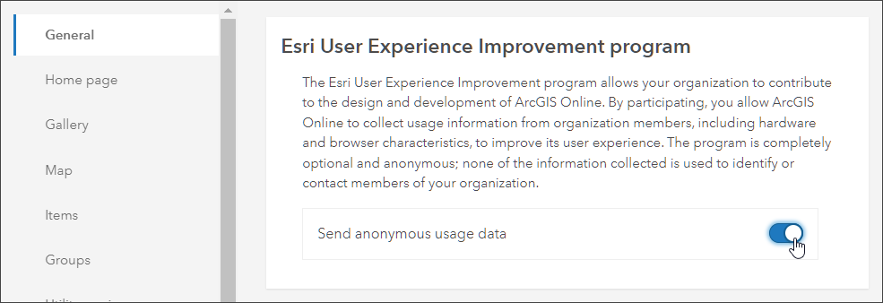

Step 2 — Enable Send anonymous usage data.
Scroll down to the Esri User Experience Improvement program section and toggle Send anonymous usage data.
Enable anonymous data

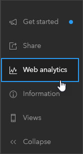

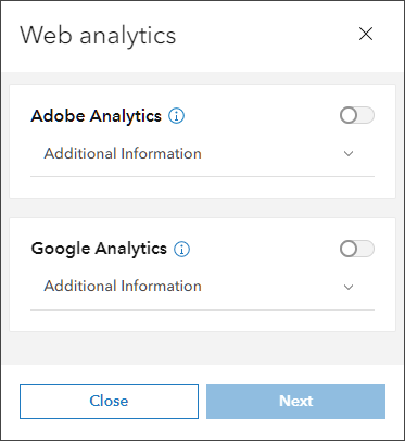

Step 3 — Click Web analytics.
Web analytics
Step 4 — Choose Adobe Analytics or Google Analytics.

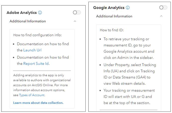

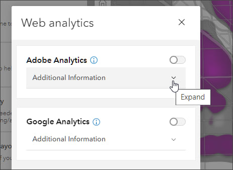

Step 5 — Expand the section to learn more.
Expand

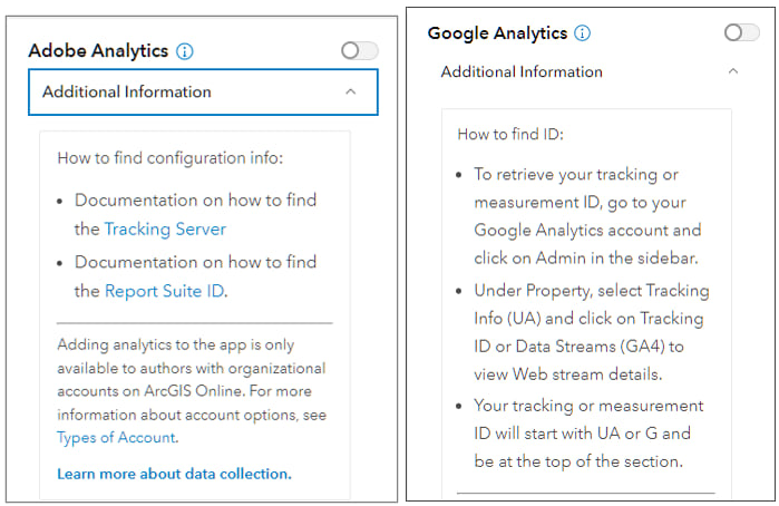

Additional information, including links, will be displayed to help you complete the required settings.
Analytics

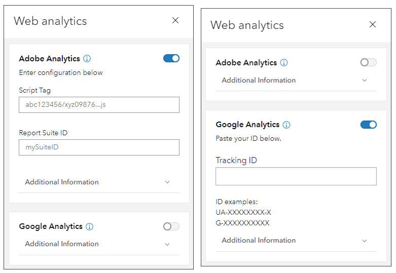

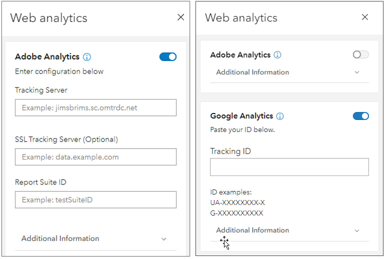

Step 6 — Toggle the desired analytics on, then complete the required configuration settings. For Adobe enter the Tracking Server and Report Suite ID, for Google enter the Tracking ID.
Web analytics
When finished and verified, click Next at the bottom of the pane.
Next

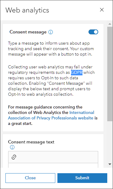

Step 7 — Enter a custom message that will appear to inform users about app tracking and obtain their consent via an opt-in button (optional). Note that collecting user web analytics may fall under General Data Protection Regulation (GDPR) privacy law. When finished, click Submit.
Consent message

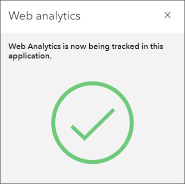

You will see a web analytics confirmation message. Your Instant App is now enabled with analytics and you can use the respective Adobe and Google tools and dashboards in your account for tracking.
Web analytics confirmation
