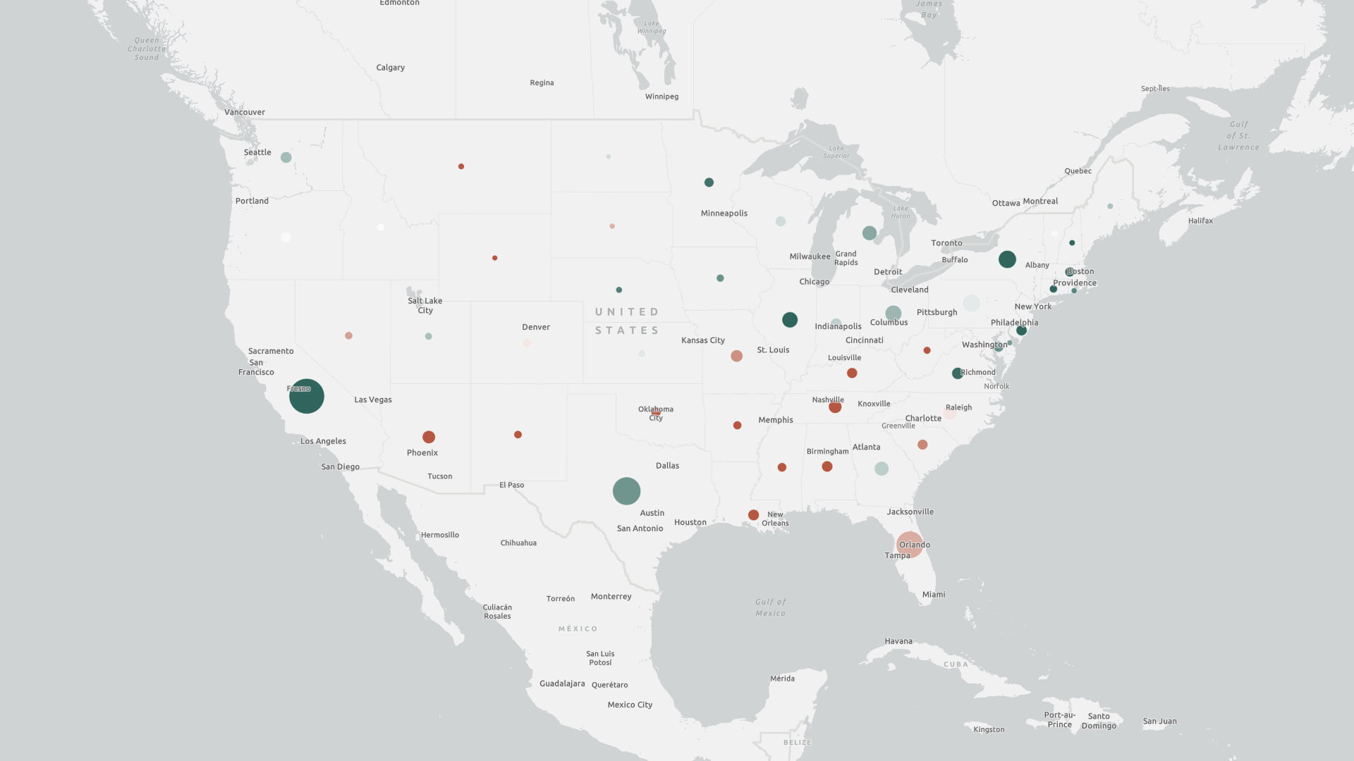

A map centered on the United States lower 48 states, which summarize the count, and rates, of accidental deaths in each state.
