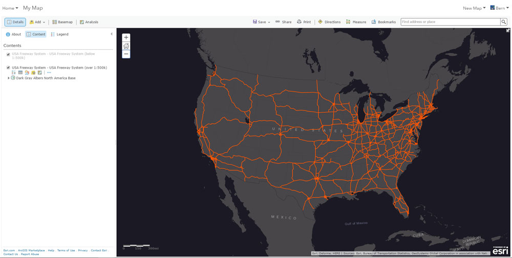

A new basemap was substituted using a dark gray layer that was published in an Albers projection. The layer was added as described earlier in this post.
The new basemap sets the web map to the Albers projection, and the USA Highways layer (published in web mercator auxillary sphere) was automatically projected on-the-fly to match the new projection.
