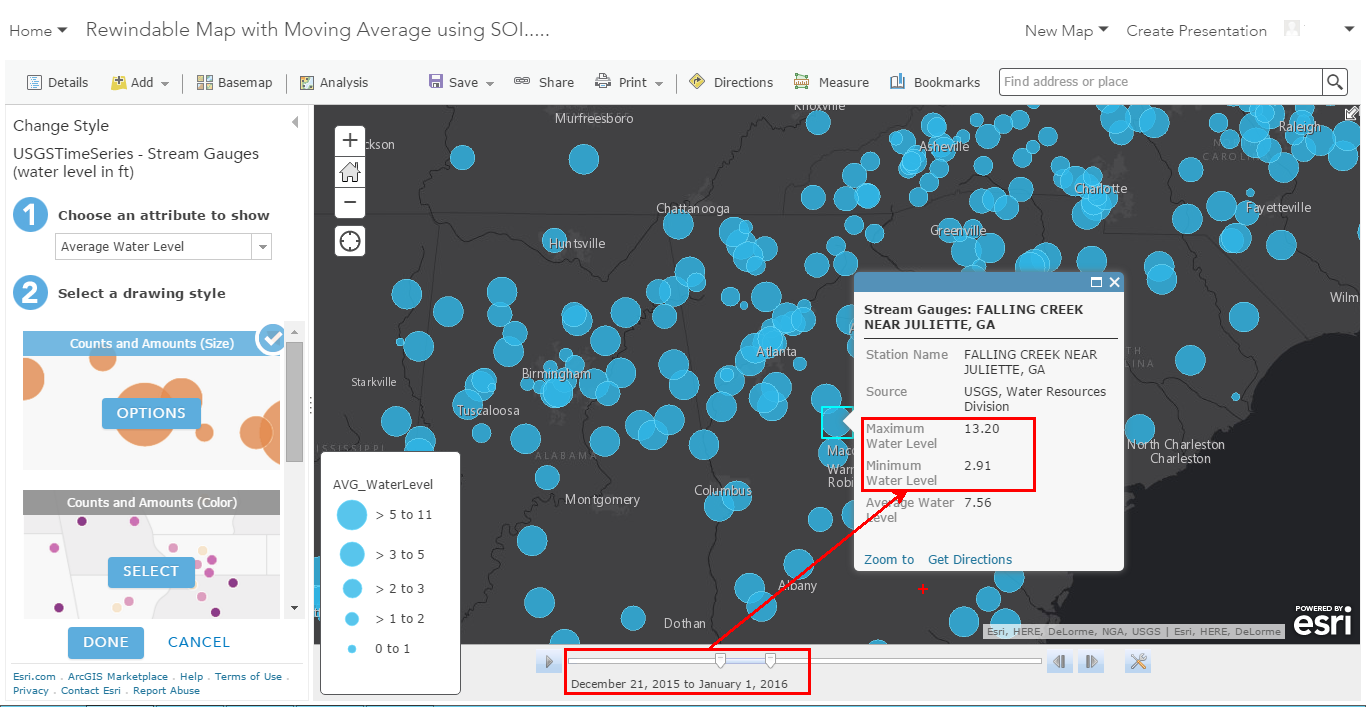

A sample SOI (Server Object Interceptor) is made available that helps visualize on the fly aggregated results by overcoming challenges presented in an earlier blog post. A map service, powered by this SOI, can be used in the ArcGIS Online Map Viewer or a Web Application Builder application without any client side customization.

- Advertises that the map service is time aware, even though none of the layer in it is time aware, so that time slider on a web application can be used and results can be computed for any arbitrary time extent e.g March 15, 2016 to June 3rd, 2016 or between 5:45 am to 10:10 pm.
- Includes few virtual aggregated fields in the layer resources to be used to symbolize features.
- When an export request comes in and it includes time values and has one of the virtual aggregated fields in the user defined renderer, the SOI generates a SQL statement with aggregated function and pushes that to the database via a dynamically created Query Layer.
